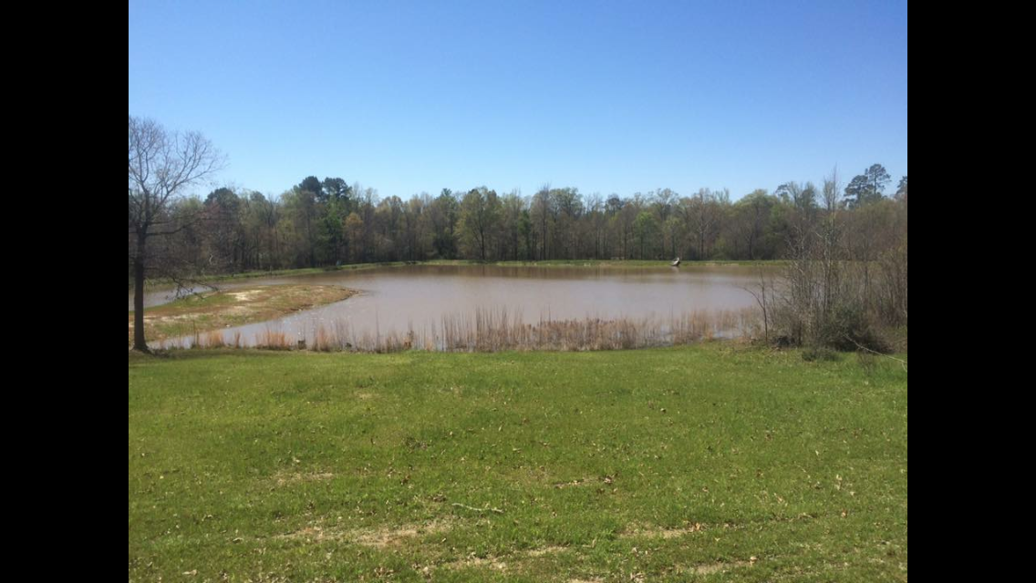

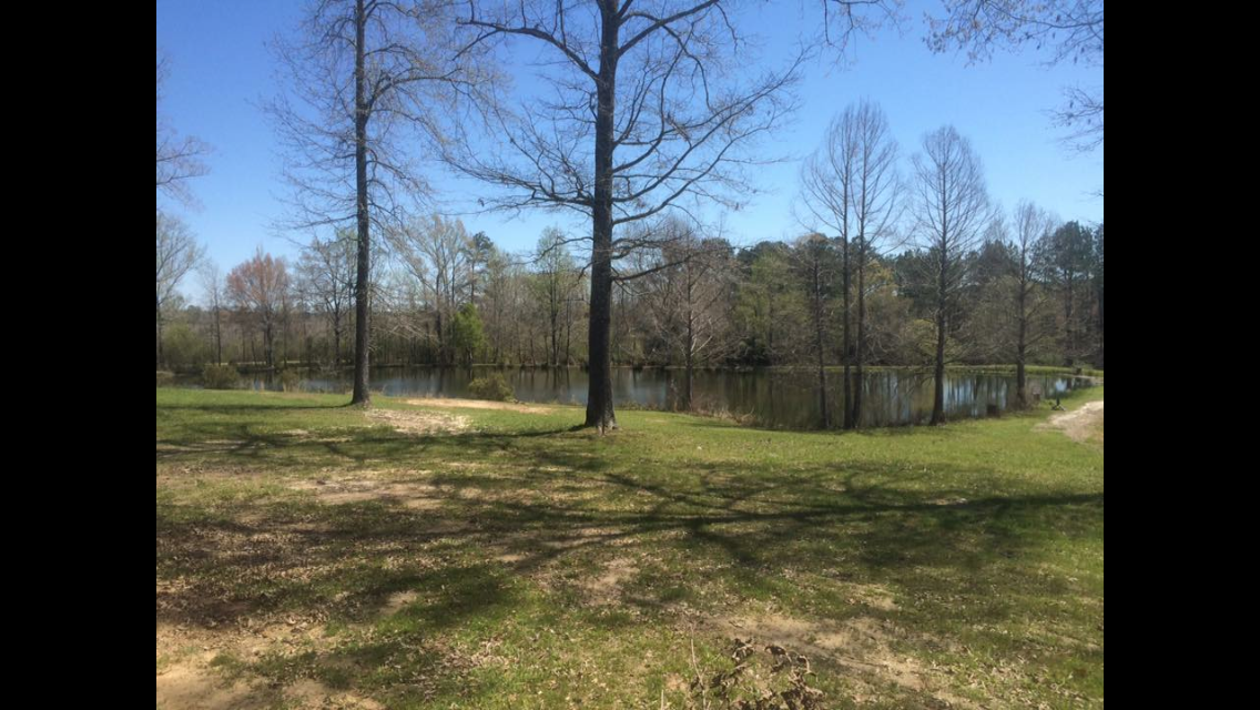

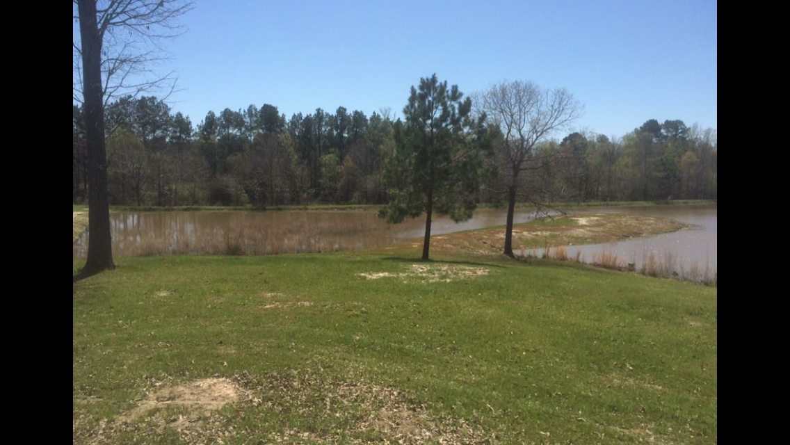

these are the two main ponds I try to keep mowed around, two of the pictures are of the same pond, as of now I have cleared all the cypress trees from around the smaller pond, not sure if this will work first time posting pictures on here
