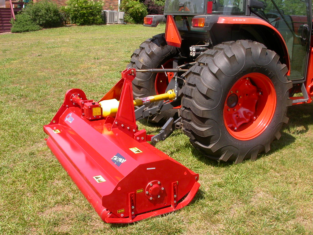

Ok all, I've been reading this thread through and through and took the plunge. Today, I picked up a 2003 New Holland 91 inch 918H Flail Mower. The unit was purchased in 2003, used 5 hours and then placed in a barn. It basically new. I was able to get it for $2500.
They loaded it with a skid steer onto my 14 trailer, and off I went. When I got home, I pulled my NH TC40DA to the side, lowered the bucket into the trailer, chained it to the Flail Mower, lifted it off the bed of the trailer and pulled the truck/trailer forward, then, gently lowered it to the ground. All systems go so far. I hooked it up to the 3 point hitch and backed it to my garage bay and greased it up. I leveled the unit from side to side and then used the top link to be sure the front was slightly higher than the rear.
Figured I'd start in the back field, so if I did any damage to the lawn, it would be less likely to be seen. I lowered the three point hitch and put it within the float range. So far, so good.
I was immediately very impressed with the cut but realized I had to adjust the height so I pulled back to the garage. Air tools made the job go rather quickly. Back to the field. Cutting went well and my better half said it looked like a golf course after a few passes. Was having so much fun, I kept going and felt braver so I moved up toward the house and starting taking out large section of the lawn.
So now, I have questions. I read through the first 20 pages of this thread again, and feel it appropriate to pose the following so those who have used Flails for a while can provide some input:
1. Skid Shoes - what is the correct height of these relative to the rear roller? I have changing terrain in the the field and when going up hill, the skid shoes seem to slightly dig into the ground. Should the roller be lower than the skid shoes? Can I simply remove the skid shoes? Any input is appreciated.
2. The unit is currently set to be pretty much centered. This means the driveshaft is a bit offset. It seems I should move the setup so that the unit is offset - the driveshaft would be straight and it would make mowing under trees, along the properly line, easier. Feedback?
3. Even in float, when I come to the top of the a hill and then over it (not a huge hill, but changing terrain), seem the mower losses contact with the ground and leaves some uncut grass. Am I doing something wrong here? Seems this did not happen with my rotary mower. Contrary to this, when I come to the low point and start to head up, some scalping occurs. Do I have something set wrong?
4. There is a metal piece on the back of the mower, just above the roller. I believe it may be called a scalper, but now sure. Irregardless of the name, there is some adjustment that I can make to it. I can lower it to virtually touch the roller, or raise it to leave a slight gap. What is this adjustment for and what is your experiences in where it should be set?
Thank you for taking the time to review this post and I appreciate the information any of you experienced flail mower users can provide.

1/ The skid shoes are mainly to help stop scalping when the mower goes over a bump which would normaly see the knives hit the ground until the roller starts to climb the bump and take the weight .
2/ This is your choice but check to make sure it is still covering your wheel tracks . While it is covering your tracks it is mowing the long grass that the left wheel is pushing down as it goes . When the left wheel is uncovered it pushes the grass down and sideways . When you come around again that grass is on your right and laying over the cut grass . You then need to go further over pre cut grass just to get the long grass heads laying on it . I also like to have the shaft running out of line about 3 degrees as it makes the universals work as they should . When a shaft is running dead straight the rollers in the cups are near static and create grooves in the bearing faces of the crosses and fail faster . But it is fine to send the mower out to the right to mow under low trees . Just be aware that it displaces a lot of weight on one side of the tractor which you must keep in mind when traversing slopes . Also keep a watch on universal joints heating up as they do'nt like angles of 15 degrees or more for extended periods .
3/ You must use the slotted hole in the mowers top link . Once you set the mower height , adjust the top link so that the pin is at the halfway mark in the slotted hole . This alows the mower to articulate up and down without scalping or coming off the ground . This is why i said before that flails do'nt like being carried ie not using the roller . As when the tractor front wheels go down a dip the mower comes off the ground . And then when the tractors rear wheels go into the dip the mower gets slammed into the ground . You must also use the slotted holes in the bottom of the 3pl link arms , if you do'nt the mower can be damaged as it tries to carry the tractor through dips .
4/ The "scraper" is to remove mud and grass clippings that stick to the roller . Leave it about an 1/8" above the roller to keep the roller clean .
Go back in the thread to where i posted the page from my Berti catalogue on correct height settings .

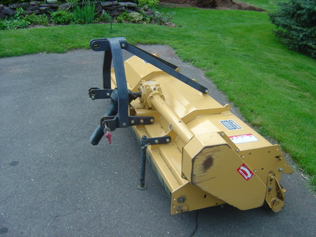

I took a few pictures so you can help me be sure I'm running things optimally. Hopefully, this will help many more than just myself.
I am including 5 pictures. One is a general view of the NH flail I purchased.

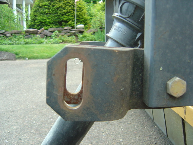

The next is a closeup of the flails attachment for the toplink. It is slotted, albeit not a huge slot. Not much choice here as its the only toplink option.

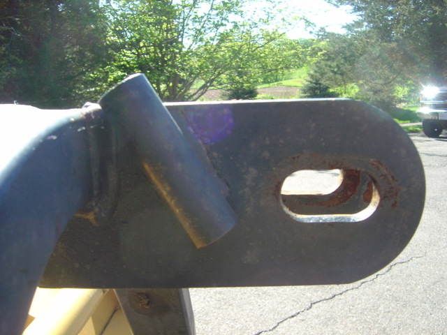

Next is a closeup of the flails lower three point connection. Again, a slot. Again, not like I have an option.
Next pictures are two closeup of my tractor. No slots on either of these. However, like I said in a prior post, I do have a float option.
Based on this, any more insight? Any more pictures that I can offer that will be of any help, let me know.

scuvnut.// That is a terrific looking mower . Your options are limited . You must use the float position on your tractor and i would suggest you elongate the top slotted hole a little further if your grounds are more undulating than the mower can articulate at present . This allows you to have the pin in the center of the slot allowing travel in both directions . Hold your top link against the slotted hole and mark how far you can extend the hole before the ball end of the link rod hits the RHS hoop frame . The holes on my mowers are about 3 1/2" long . These types of mowers are designed for dead flat operation in orchard rows and need a little tweaking for the uses we have in mind . The lift pins of your tractors lower arms will be at the top of vertical slots on your mowers lower hitch slots as they are carrying the mower but as the mower rises rapidly they will also float .

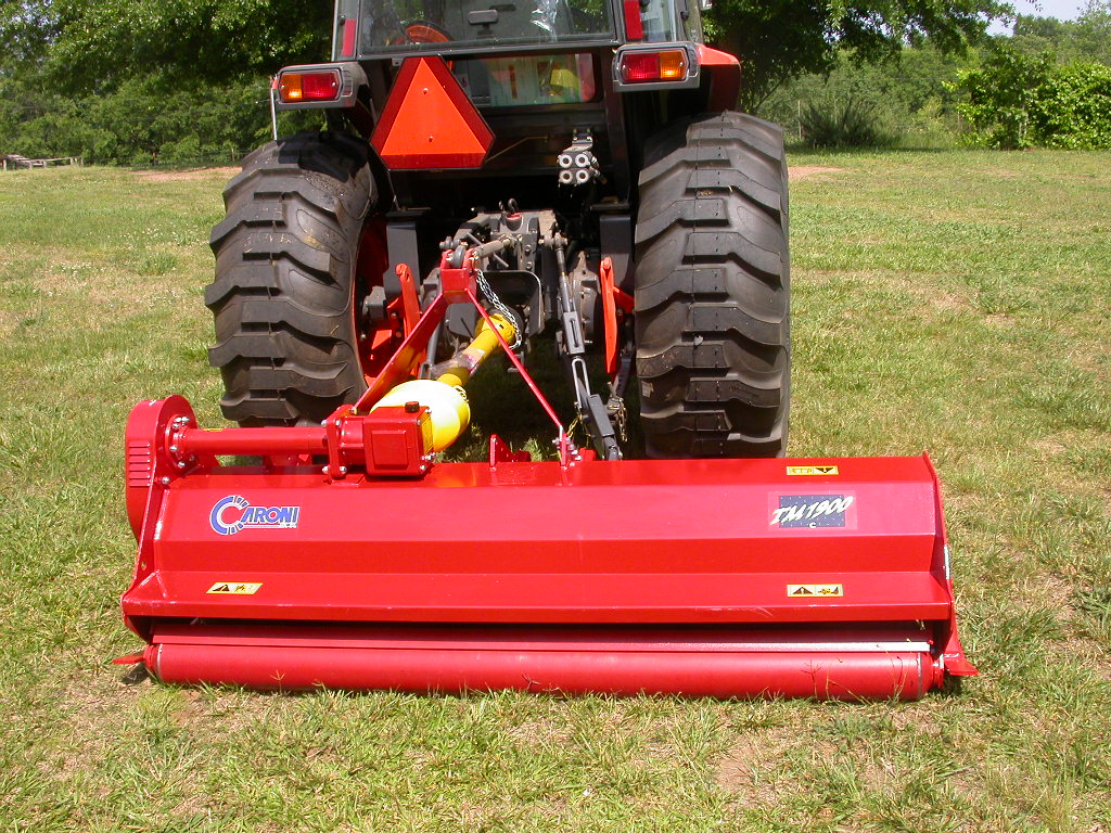

Very helpful pics and comments. I didn't realize I even had a slotted top link hole until seeing/reading this. I'm posting a couple pics of my new Caroni. It looks like I have a slotted top link option but no slotted bottom link option (but I do have a float option for the tractor, so I guess that is ok).
Dave

From what I can see the lift arm pins seem to be on short arms that pivot (optionally).
If this is so, then they probably perform the same function as slotted lower arms.

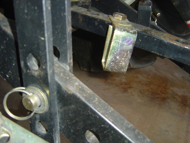

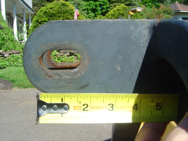

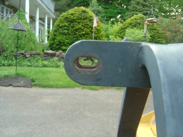

I understand why you are suggesting to elongate that top slotted hole. I went out to the mower and took a couple of more quick pictures. The first one is of the opposite side and you will see that there is a small tubular structure that would limit the length I could elongate the hole. However, other than being a screwdriver holder, I don't see any particular purpose for it, so I could remove that (is there a use that I don't know about for it).
The second picture (which I did my best to hold the tape measure and take the picture) shows the hole is about 1 1/2 inches currently and I could easily get it to 3 1/2 inches without the ball end hitting the RHS hoop frame. Incidentally and to satisfy my curiosity, what does RHS stand for?
Now for the big question - this is some serious thick metal. What is the best way to actually elongate these holes?
Once the holes are elongated, am I correct that I would lower the mower to the ground so the back roller is touching the ground and then I would adjust my top link so the pin is right in the center of the newly elongated hole?

A few points I've found with slotted toplink holes. First, they allow the mower to ride over humps. Two, they works best with a mower that glides along on the roller and the side skidplates (IMHO). Three, some designs require a looong toplink. Four, watch what the mower looks like when you lift it- I've got one with a slotted toplink that dangles at an awkward angle that tends to break the toplink triangle structure on the mower if the toplink isn't shortened for transport and then lengthened again to use it after arriving. PITA.
