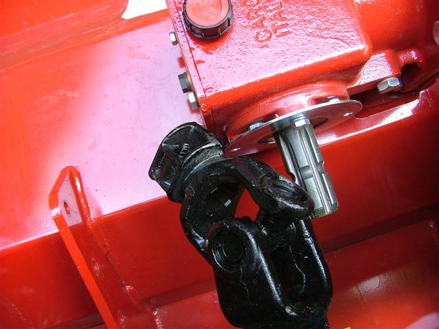

I took delivery of the Caroni. It's a bit bigger than I imagined it would be. As was mentioned in other posts, there is oil in the unit. The paperwork is in many languages and English was not the manuals writers originals tongue. It's written well enough to get by.
Here are a few pictures of how it was delivered. The PTO and top link bracket were under the unit.

The set up went well enough. I spent about 30 minuted reading the paperwork before I put it together.
I ran into a slight problem with the PTO shaft. It's about 6" too long.
What's with that?
I went back to do more reading and the Caroni manual said not to shorten the shaft. However, the manufacturers manual gives detailed instructions on how to shorten the shaft. I will take off about 4" from each side of the shaft, to give me some play.
BTW, my setup area is level ground and the top link is set correctly.
Any opinions or comments?

Yeah, CONGRATS !!!!!
Also;
Yeah, it DOES come on two pallets nailed together.
Yeah, the pallet fork entry is at the end (not side), so it probably gets a bit tippy on 4 ft or 4 1/2 ft forks.
Maybe the extra shaft length is in case you get the shift kit ?
Either that or its the next standard size up, which I think is SOP, so just cut it to fit anyway.
