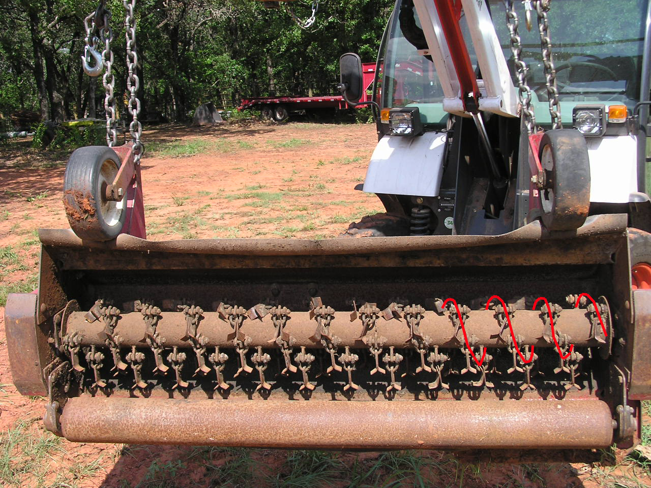

Looking at getting a Flail shortly and see that they are now using Spiral Mills which they claim require less HP than a straight mill. Anyone have any experience with a spiral Mill? It appears that they may need less hammers too but I could be wrong on that. Wrong, they are about the same. Just checked.
/ Let's talk flail mowers #2,563
I'd doubt it would cut HP much if at all. You still need to push all those knives through all that material. There is enough of a flywheel effect from the rotor to mitigate any rows have vs. a spiral cut. Sounds like mostly or completely marketing BS to me.

This is the mower I am referring to HERE Check out the hammer spiral layout photos.
I previously looked at rotary slashers but after some research decided the Flail would suit me best. I have cleared timber from my paddocks and cut stumps off at ground level. At present it is a bit rough with lots of small sticks that have dropped off the trees I cut and having a bad back I can't get out and pick them all up. Also woody weeds need knocked down and saplings, although I have managed to cut and poison most of them. Grass is trying to grow and should now the trees are gone. Looking at about 9 acres of rough and roadside long grass. I have a 700 meter road frontage. I also have bush tracks that need a cleanup now and then cutting out regrowth. (I have 40 acres)
Secondly the reason I am looking at the flail is that we are looking at another property and blades can be changed to suit as there is more lawn area there. (I have a Ride-on Mower as well)
So, to answer your question. I need to tame these paddocks first and then, after a couple of cuts, it should be relatively easy going from then on.
I have a CK30 HST that has handled a 6' slasher for a day no problems but I wouldn't keep using one that size indefinitely.

Alien, be aware that changing several dozen flail blades is not a trivial exercise. The rotor you display requires each blade to be changed individually (like most flails). I would budget several hours with air powered tools to do the job.

All flail mowers have a spiral configuration. Oh yes they do. It's just that the 'turns per foot' or whatever is higher than the one you showed.

Define "spiral configuration".
Mine looks straight.
/ Let's talk flail mowers #2,574
Nah. That's a spiral. Looks like maybe one twist every 6" or so. It LOOKS straight because a knife happens to be placed around that imaginary spiral line with a spacing that results in there being a straight line of them along the rotor.

Here is the "Straight on view" :D

That is a straight mill. No spiral about it but probably pointless arguing with him. :laughing:
That's because I'm being silly. See? Spiral:
/ Let's talk flail mowers #2,579
Yep, I can see a very tight spiral. ;)
I can also see straight rows of hangers slightly offset from the previous row. :D
