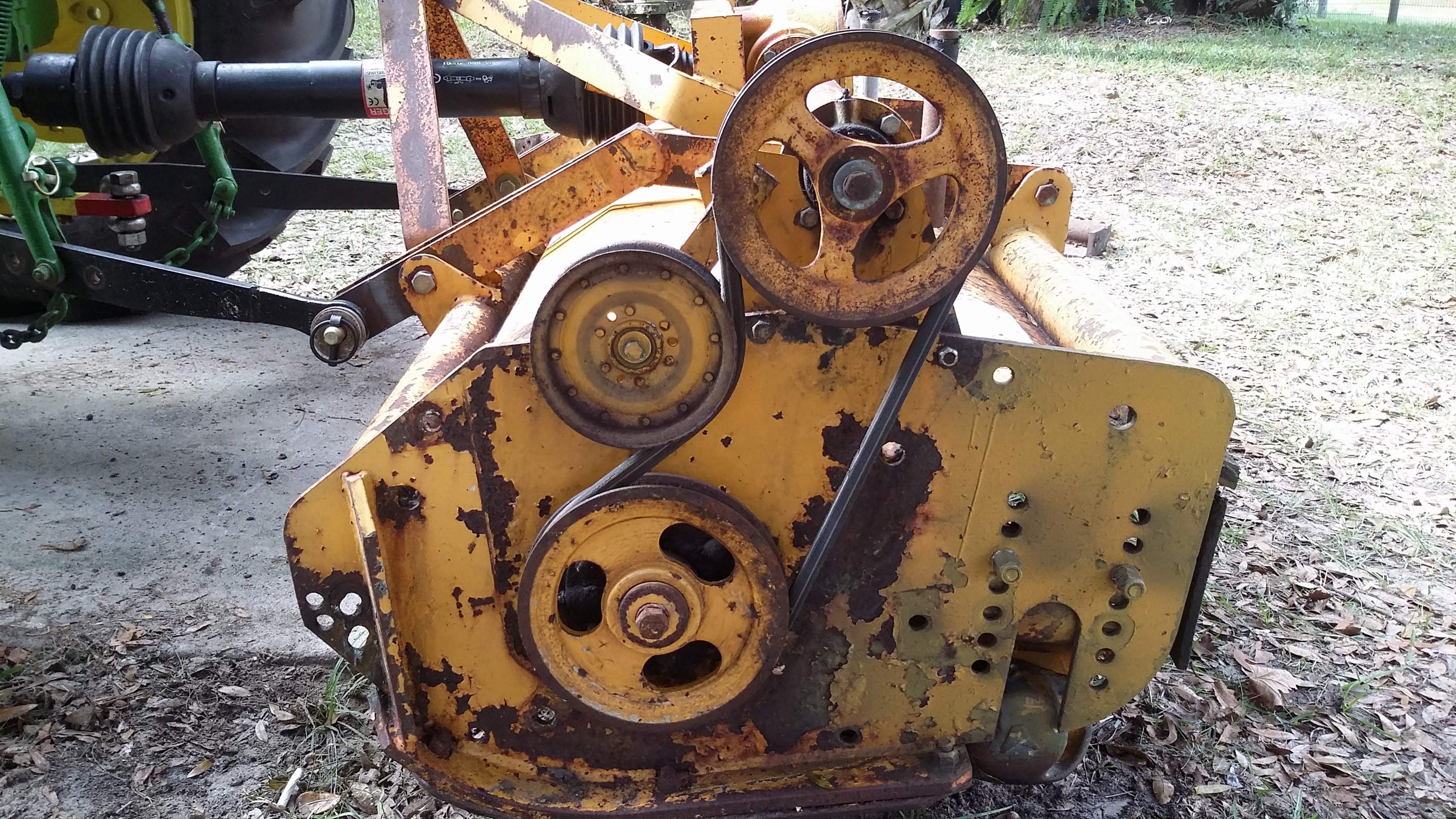

Hello Hoochy,
I want to welcome you as the newest member of the Flail Mower Nations.
OK you definetely have a problem if the V belt guard cannot be reinstalled.
The V belt that was on the flail mower is the wrong size.
Now, where is the spring that connects to the tensioner arm of the flat idler
to keep tension on the flat side of V belt??
I will have to check my parts catalog for this model SH74's parts and numbers
I will get back to this later today.
/ Let's talk flail mowers #2,582
Hello Leonz, yes the belt that is on now is a bit narrower, the OEM belt is a bit wider and shorter. The spring tensioner is in place and in good working order. 20151204_131018.jpg
The new belt is M-100706 which is what my parts manual calls for.
The guard can be tricky to take on and off, maybe i need to try to get it behind the idler and the bottom first then slide to top in or something.:confused3:
Thanks, any help is appreciated.

Hello Hoochy,
as time is short for my evening chores, The V belt guard goes on one way and comes off the same way-patience and take good look at the parts diagram of the mower to see everying there.
1. I want you to remove the current belt
2. remove the idler arm
3. replace the grease fitting in the idler arm
4. clean the old grease off the idler arm shaft
5. use some fine grit emery cloth to clean it more
6. make sure the flat pulley idler is not stuck or sticking
7. use fresh grease in the new idler arm fitting and make sure it can swing a wide arc.
8. reinstall the idelr arm spring
After that you should have no issues using the OEM Belt .you need the OEM belt and
then use a hose with hot water to wash off all the dirt under the V belt guard and around the pulleys.

Hello Hoochy,
You need to use the OEM V belt, and please some grease in the idler arm too
as it looks like it has not seen any in while

Thanks Leonz. That pic is a bit older. Since then, I have done all you mentioned above to ensure the arm was well greased and moving freely, and started sanding blasting and prepping for a paint job. The idler was moving freely and there were no issues with the arm swinging or being tight. The spring is also very strong although it looks like crap. I plan to replace it after the paint job.
I was thinking maybe someone replaced the idler pulley with one of a larger diameter to accomodate the longer belt??? Do you know what the diameter of an OEM pulley is supposed to be?
I am not at home ATM, but I can measure mine next week.
Thanks again!

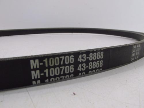

Update on my belt issues. I emailed Alamo support and Mr. Quesada quickly replied with the answer. He confirmed that the belt that came with the mower is not OEM and also suggested that there are some manufacturers producing a similar belts to the 100706, however the "M" designation in front of the number confirms it is not an Alamo belt and thus too short causing guard issues. It is what I get for trying to save a few bucks and buying off flea bay:ashamed:
Yes, a new OEM belt is on the way....minding the holidays I'll have it next year:laughing:

Here's a pic of the belt I bought, notice the "M".....not EOM and although it will work, it will make it impossible to use with the belt guard because it is a bit shorter than OEM belts.s-l500.jpg
Just though I would let you all know in case you are considering a new belt. Stay clear from these with the "M":thumbdown:

Make sure to leave some feedback for the eBay seller.
