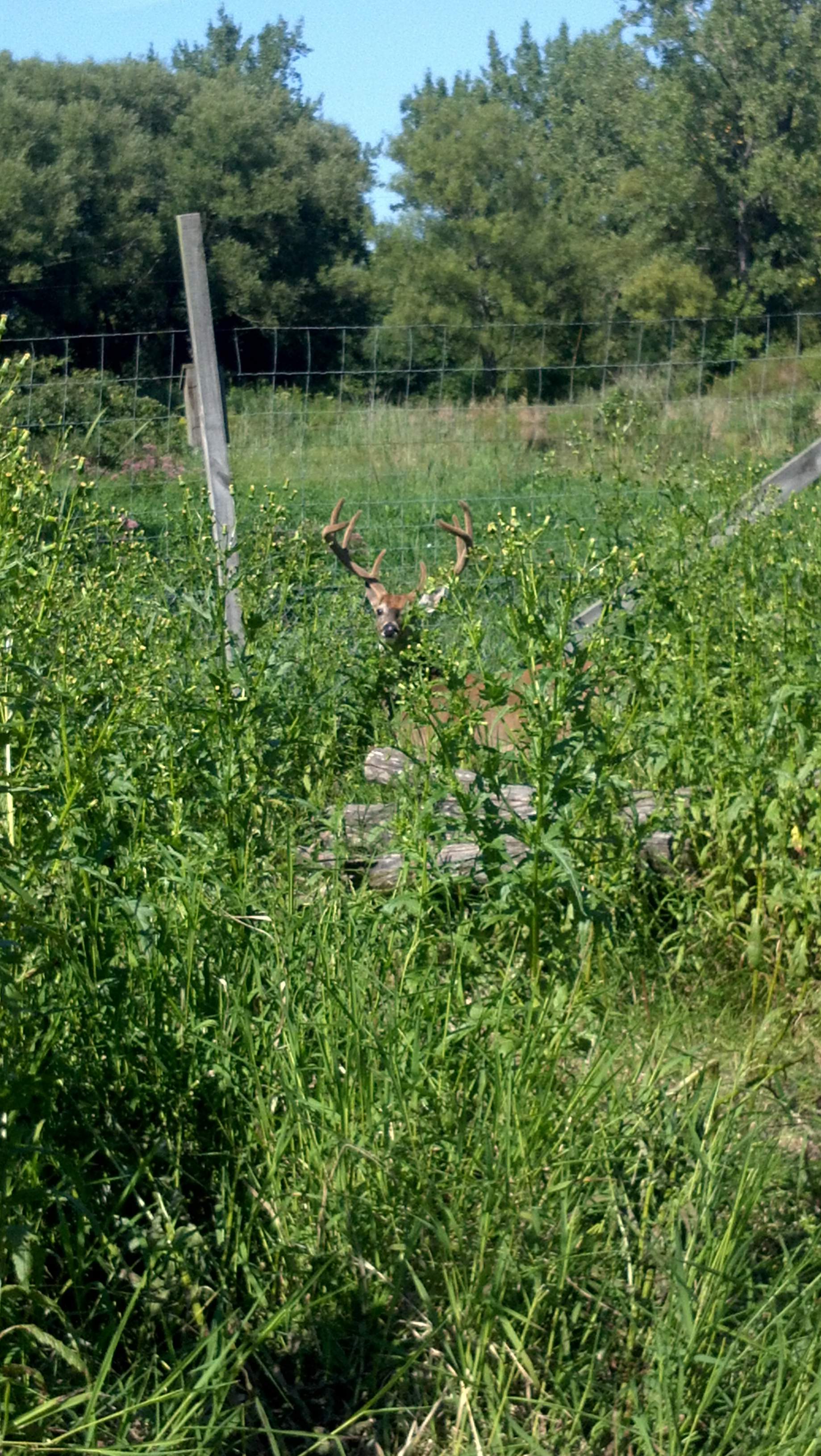

Here is mine. 8-foot game fencing that encloses about .85 acres. Put it all up by myself. I think that some of the larger deer could jump it if sufficiently motivated but has been up for four years and I haven't seen any sign that a deer has been inside the fence.
