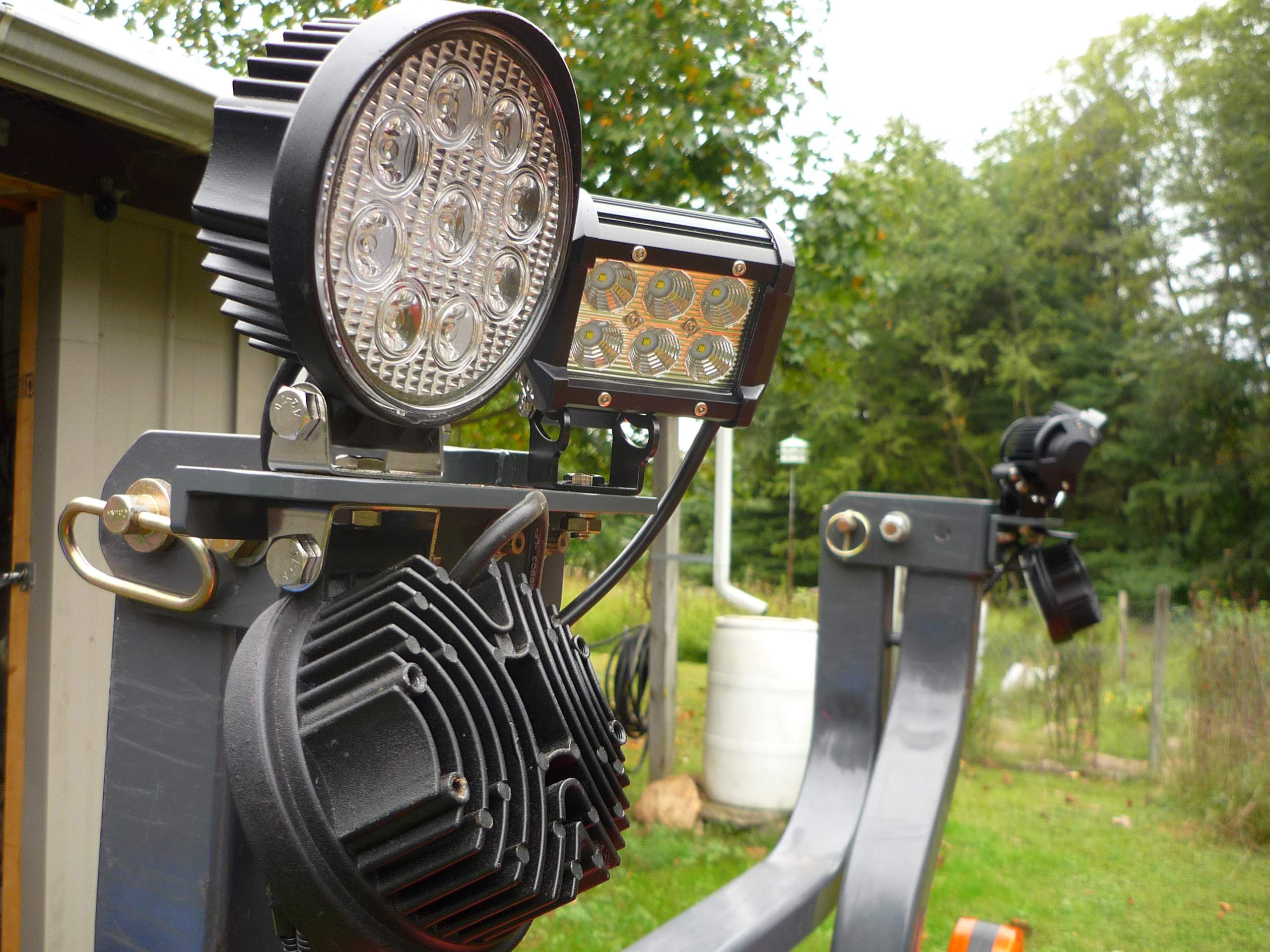

I'd second what s219 suggests: you can buy serviceable 27W LED lights, make some simple brackets, wire up a switch or two, and you are illuminated front and back for under $100. I have lite 3 Kubotas now, here's my latest set-up. Night time snow plowing isn't much fun without a cab, but at least I will be able to see. I've purchased lights from Amazon and eBay, never had any issues.

That's a nice setup varmint. Next time I see an aura of light coming from the direction of Maryland, I'll know who it is.... ;)

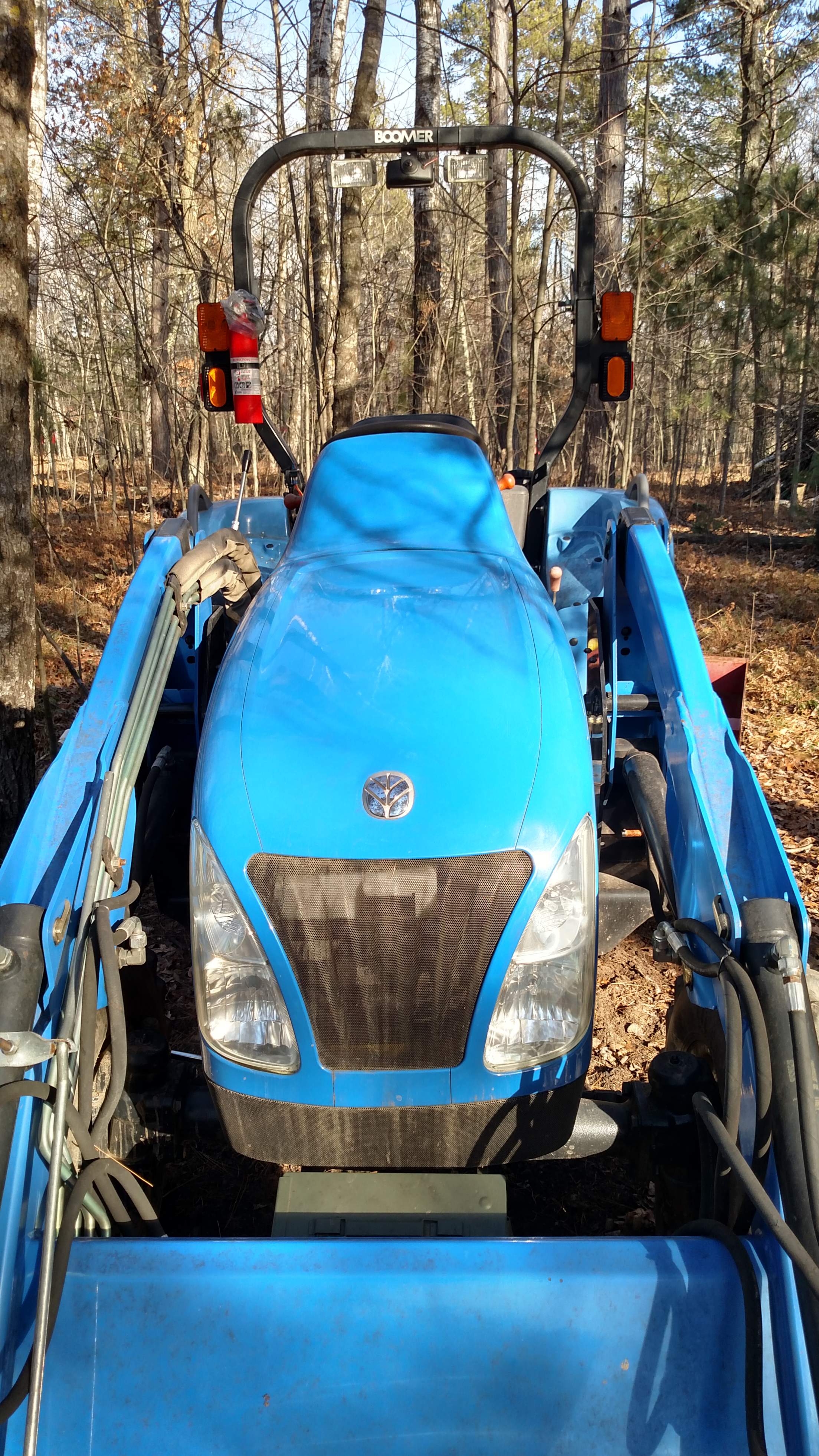

I'm going to start a post in the Build it Yourself Forum about 55w Halogen vs 48w LED.
Regarding the install, I've added front and rear work lights to the ROPS of two New Hollands, and it was pretty straightforward. There was an unused two prong power plug under the seat. The plug is like half a 4 prong trailer connector, and I bought one at an auto parts store to connect to it. Then it was just a matter of making a bracket for the Tractor ROPS Lights 2.jpgTractor ROPS Lights.jpgswitches (front and rear lights), running the wire around the ROPS, securing with cable ties, and installing the lights.

Varmint
Whee did you get those mounts you used?

powerscol, I won't triple post the photo, but I just made them from some scrap 2 x 2 x 1/4" aluminum angle I had. I would have used steel, but didn't have any the right size, and since the alum. was about the right length, free, and easy to cut, as well, it was a no-brainer. It's heavy enough it doesn't flex/vibrate (resonate?) I did have to drill some holes in the hinge bracket of the ROPS for 1/4 - 28 bolts, but the integrity should be un-compromised by small holes there. I like the lights high enough to clear the plow, out enough to not hit the back of my head (with light) and light the front/sides well, yet not so far that they are likely to get whacked by stuff. I'd probably use the top underside of the ROPS if I usually had it up, but I can't because of my limited barn entrance height.
