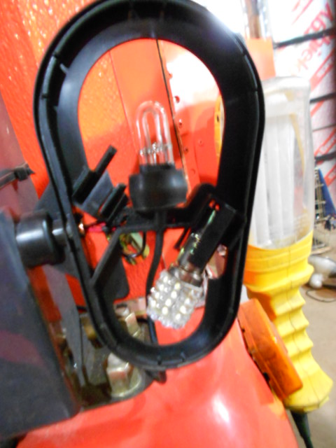

I bought these on ebay a few years ago. just installed an go. Very bright no need for anything else to make them work, strobe back.JPG Removed the top one to install the strobe.
