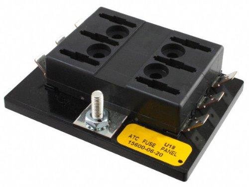

   / LED light questions. #46
When I started adding electrical stuff to my tractor, I added a solenoid under the hood, switched by the ignition, powering a fuse box. This gives me 6 fusible, keyed, power sources.

   / LED light questions. #47
Blue Seas has a great line of waterproof circuit panels and other electrical devices for Marine and RV applications. No relay build in but easily added.
A little less waterproof is the Painless Wiring Unit called the Circuit Boss. There two units have relays build in just add power and accessories.
Make sure you fuse the power source wires and as close to,the power source as possible.
I am glad it was mentioned about a circuit panel i was thinking along this line but it slipped this old mind but now I put it on the list... "Add waterproof, relay controlled, circuit panel for tractor lights and Seat area".

   / LED light questions. #48
I already have a power wire run from the battery back to the dash. I want to have the lights switched from the ignitio. So no matter what switch I use, I plan on using relays. I guess I am a little old school also.
We are both doing the same thing, just going about it differently. I will put a single ignition switched relay on the feed to my fuse panel and distribute from there to all my lights and other accessories. Does the same thing but I only have to use one relay to switch 4 circuits instead of a relay for each circuit.
