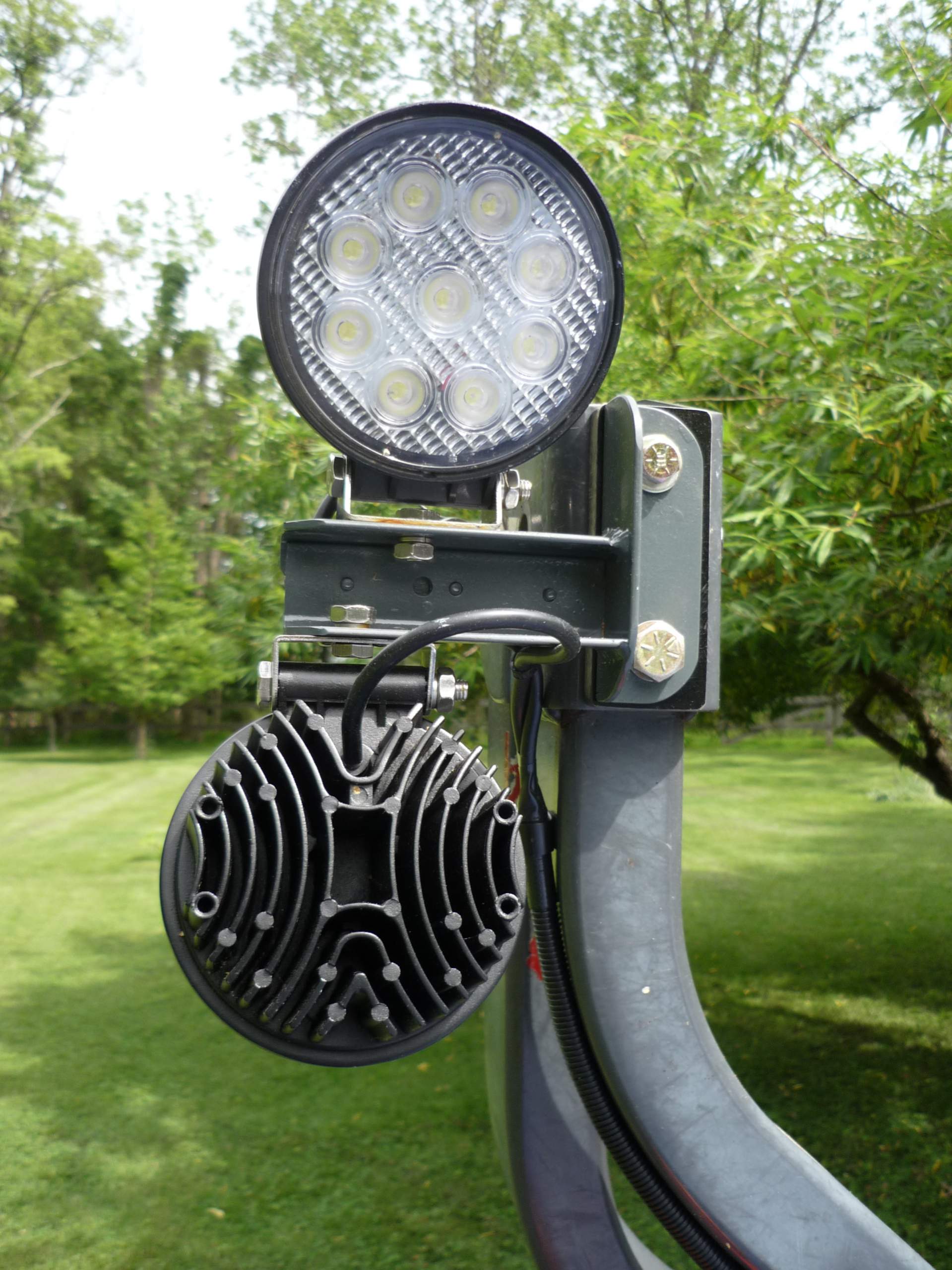

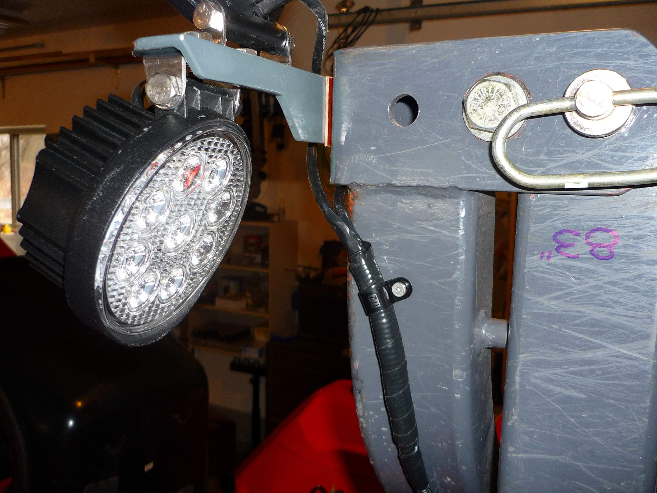

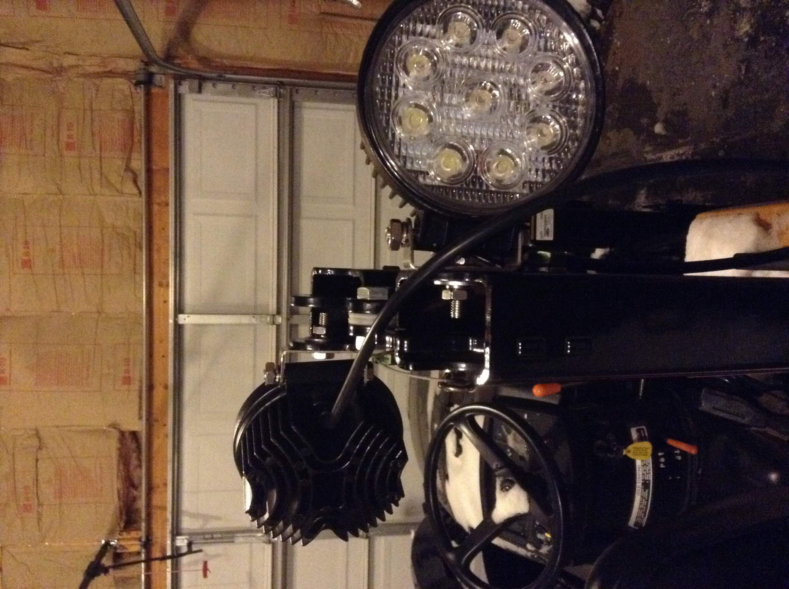

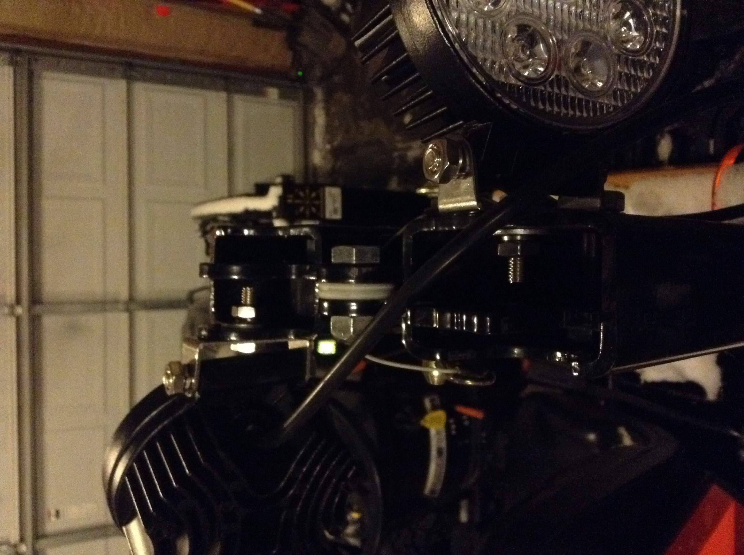

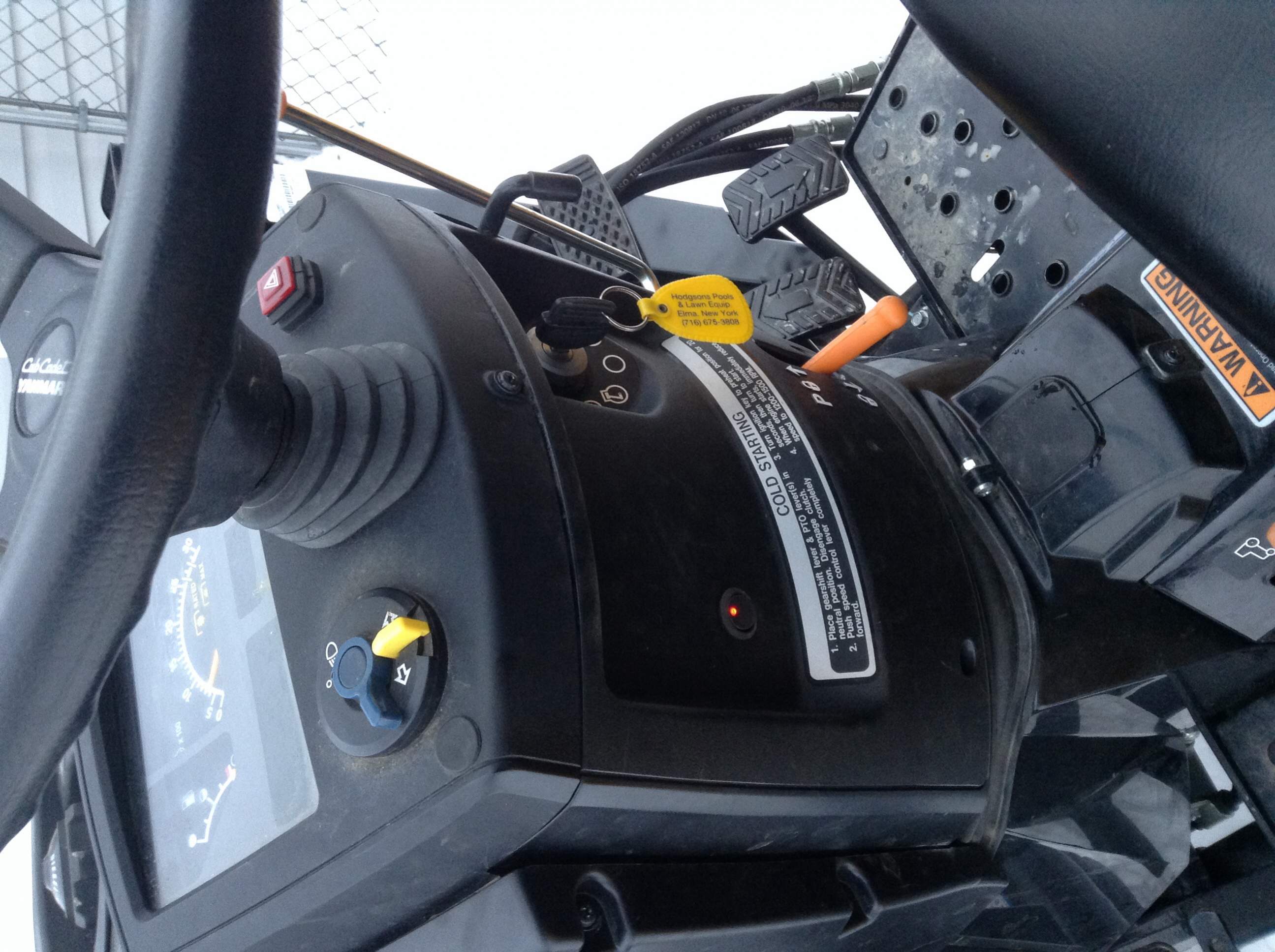

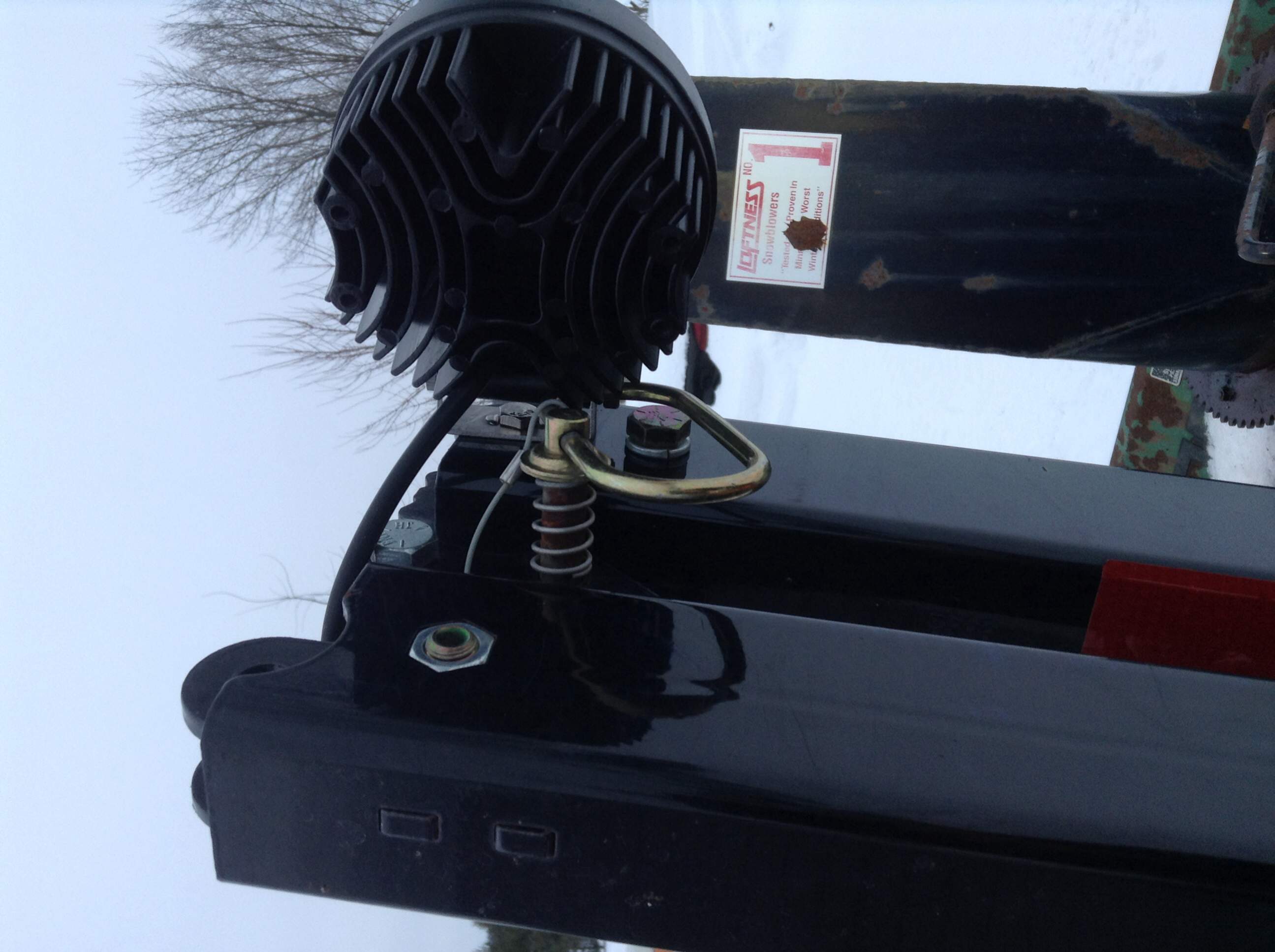

I just finished the install!! to say I'm happy is a complete understatement. 2 27w lights are incredible and plenty for me. Pictures and details to follow later.... thanks to all
/ LED light questions.
#26
I have to say that the opt7 harness ended up being the perfect length for this tractor. The battery is all the way in the front of the tractor which made me nervous at first. I'm not the most capable at this stuff but it was pretty easy with some patience. I'm sure there are easier ways to wire these in but I wanted the lights to be separate so I didn't compromise anything. Loving the result and can't wait to add front lights somehow

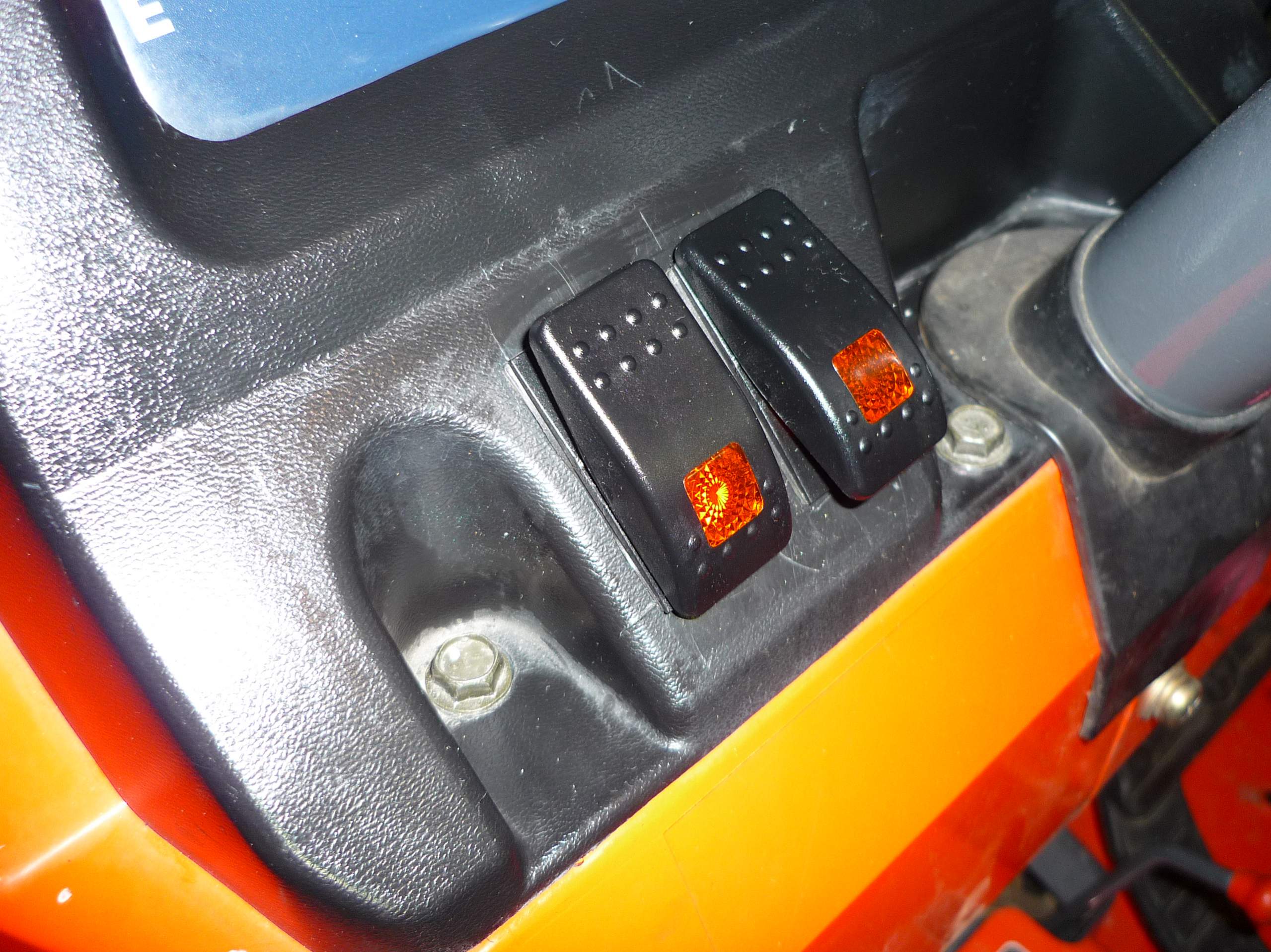

I had considered those, for just your reason, but decided that with gloved hands (plowing snow?) they might be a hassle to switch.
/ LED light questions. #33
I just bought something similar off Ebay: one because of the round mounting holw and two because they claim to be waterproof. Mine just have an LED dot light but should work better than a lever toggle switch.
/ LED light questions. #34
Can you give a link to them?
/ LED light questions. #35
I have used one for about a year to control the headlights on a four-wheeler with no problem. They appear to be well made.
/ LED light questions. #36
/ LED light questions. #38
I'm going to use a couple of these one for the front and one for the rear. The connectors are a little light duty but I think with a little head shrink and a tie wrap I will be able to work with them.
Amazon.com: 1 Latching Push Button Power Switch 16mm 12v LED Stainless Steel Waterproof Red: Automotive
The connectors are light duty because the switch is only rated at 3A... be careful.
Yes, LED's don't draw a lot but 3A is pretty marginal for a light switch.
I'm using something similar to the ones blue72camaro linked to.
I bought mine from Waytek.
SWITCH ROUND ROCKER RED LED 3P SPST ON-OFF 20A 12VDC - 44116
Mine are rated at 20A. I see the ones blue72 linked to are 25A.
Maybe 20-25A is overkill for LED's but better safe than sorry.
