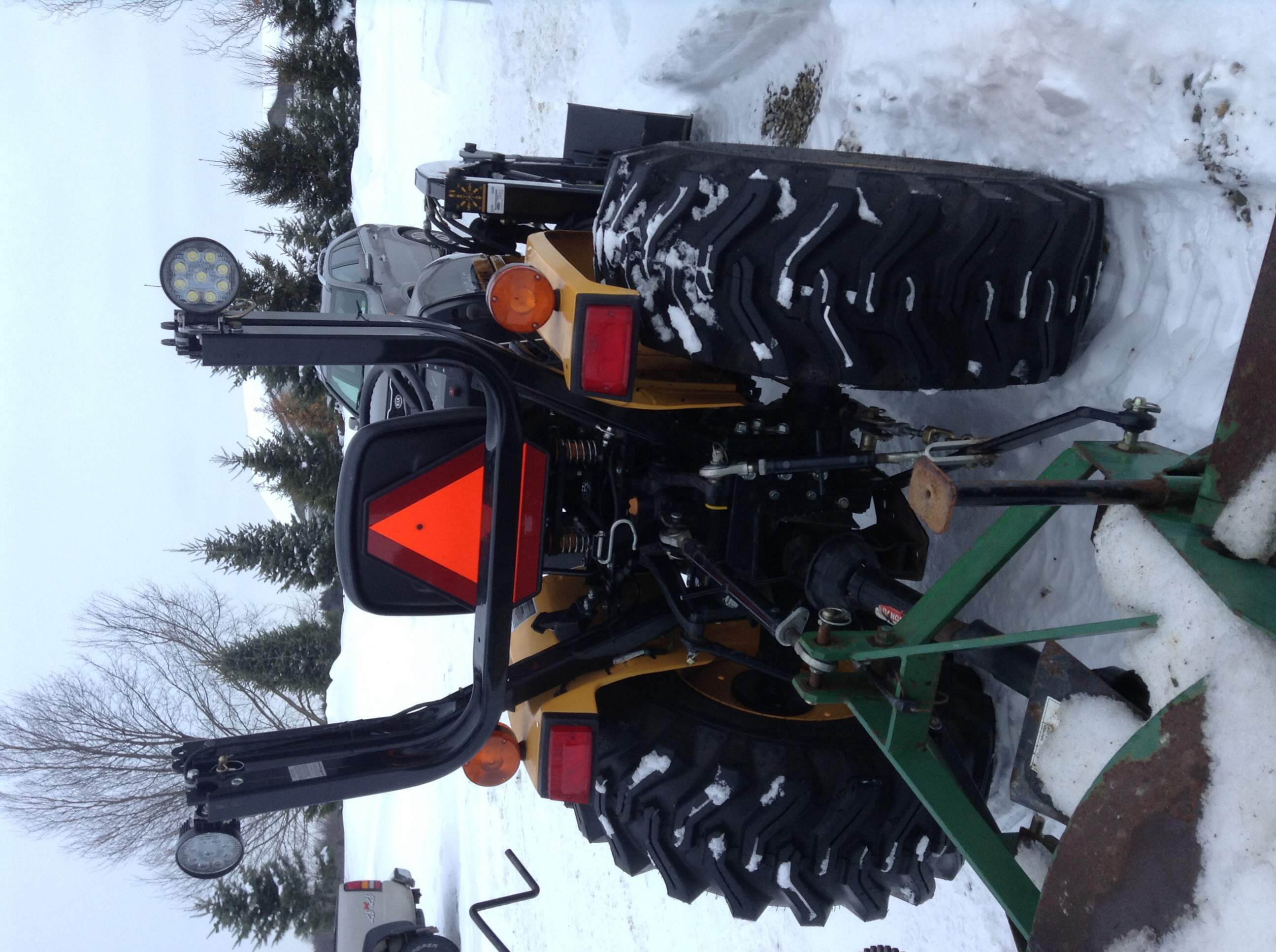

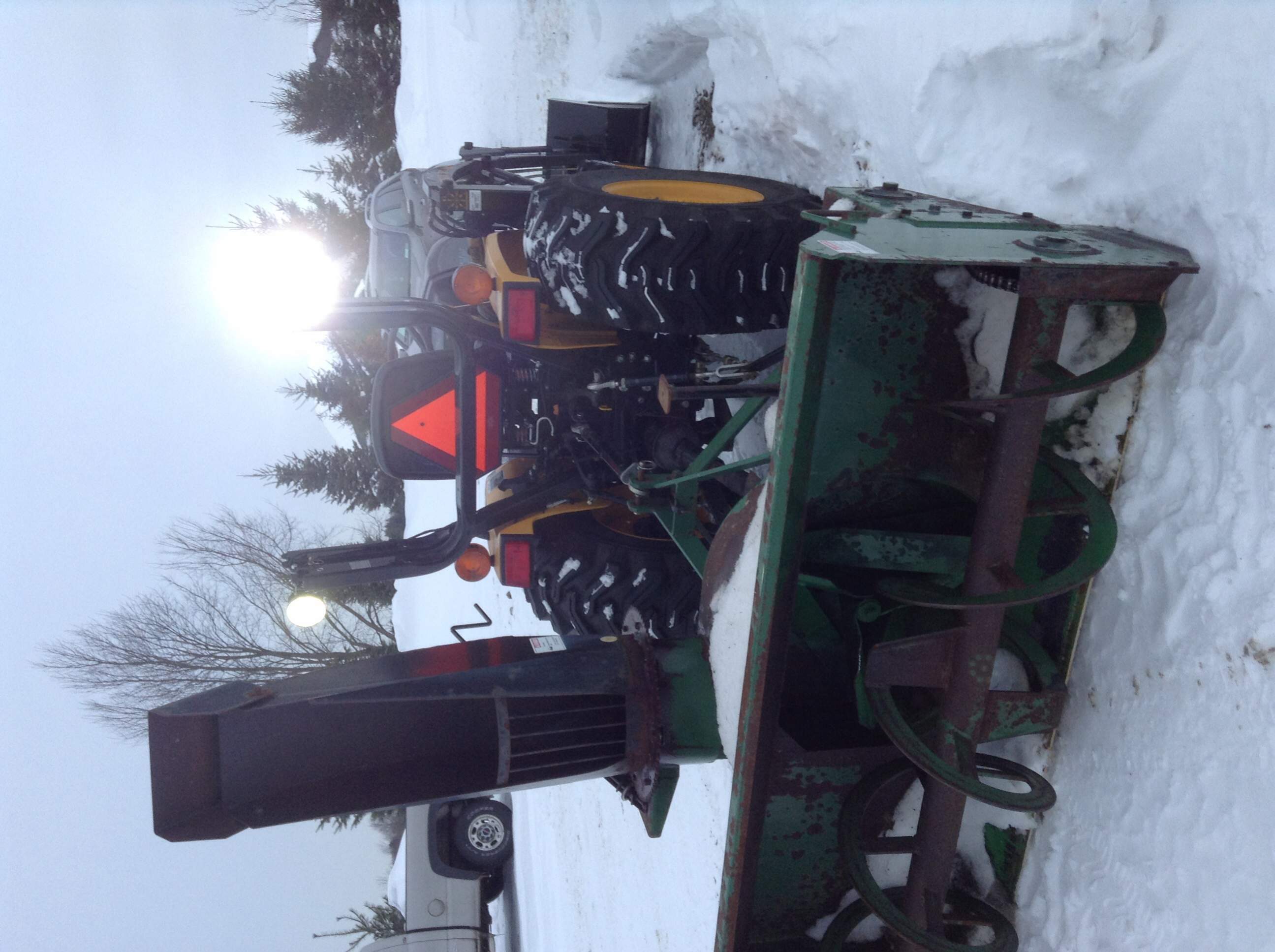

I bought 6 of these guys and mounted 4 of them.
http://tinyurl.com/ntrkbw8
LOVE 'EM.
I blow snow at 5AM while the kid is sleeping and my wife is in the shower. I have my own "zone of daylight". The joke is that I blind any squirrels that I might wake up.
I would have done a light bar, but my ROPs has to be down to fit in the garage. So, I mounted these on the ROPs hinge plates.

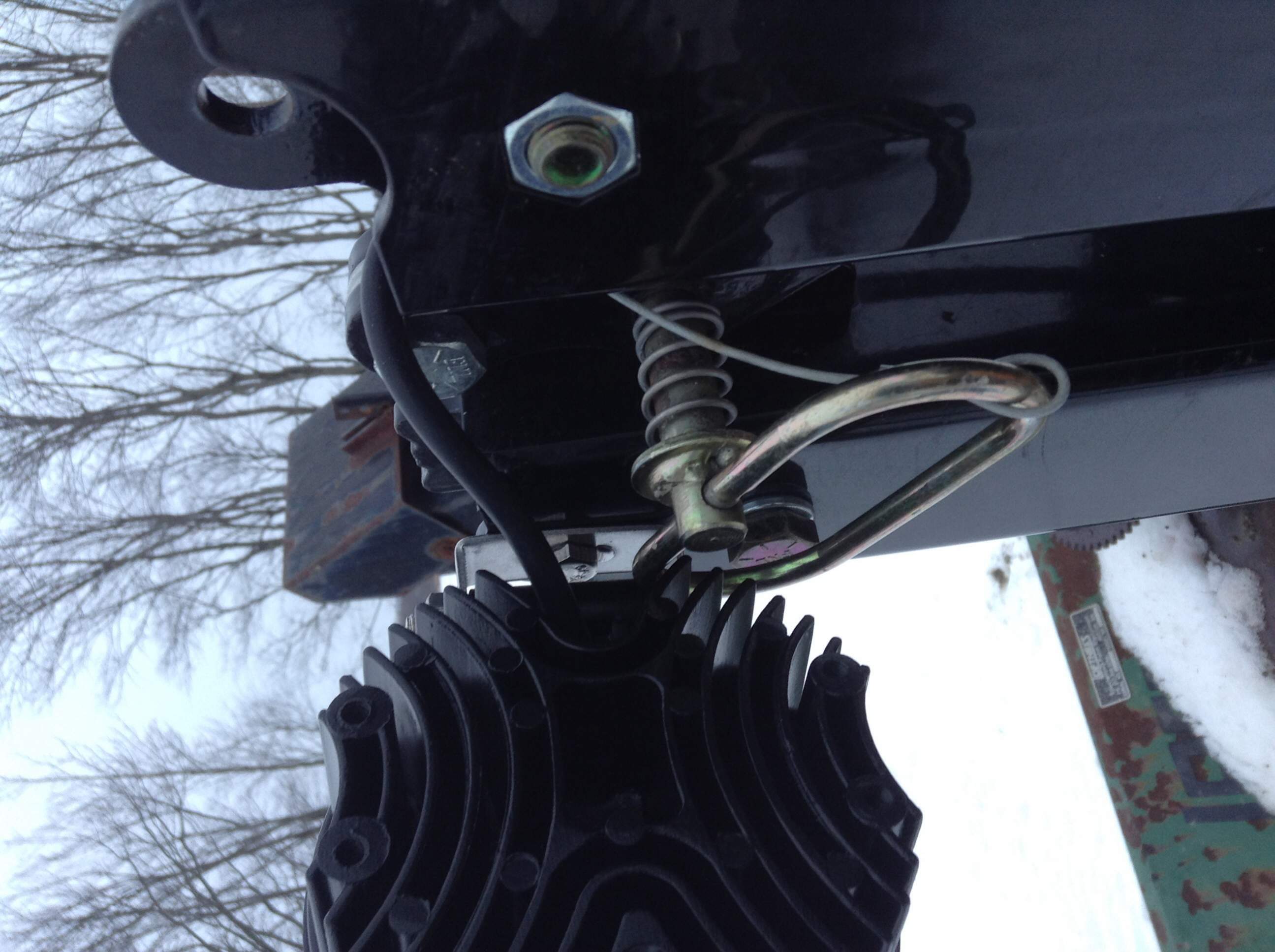

Those are the exact ones that I purchased as well, and they work great... 2 of those facing forward and one rectangular "light-bar" style that is rear-facing. I wired mine to the existing switch instead of putting them on an individual circuit, but I might change that this year. For mounting, I have the same issue as aeblank -- need to move the ROPS up and down for storage, so I made a mounting plate out of 1.5" angle iron -- mounted the lights to the angle iron and then used 2 u-bolts to connect it to the top of the ROPS. I didn't want to drill into the ROPS, and this has worked pretty well. I put the wires in a cable shield so that if they accidentally got caught in the ROPS hinge it wouldn't damage the wires, but that hasn't been a problem.
These things are like the sun. My neighbor even joked with me that I wake them up with my early morning snowplowing by causing his roosters to crow. :)
