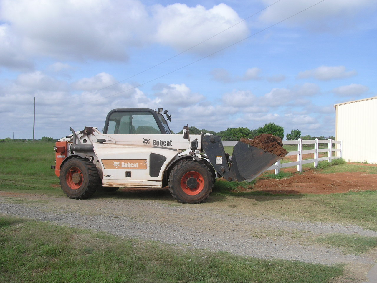

Excellent feedback. Thanks everyone. I've decided to fill the holes with a dozer first. There are hundreds of holes, since the property was previously a tree farm.

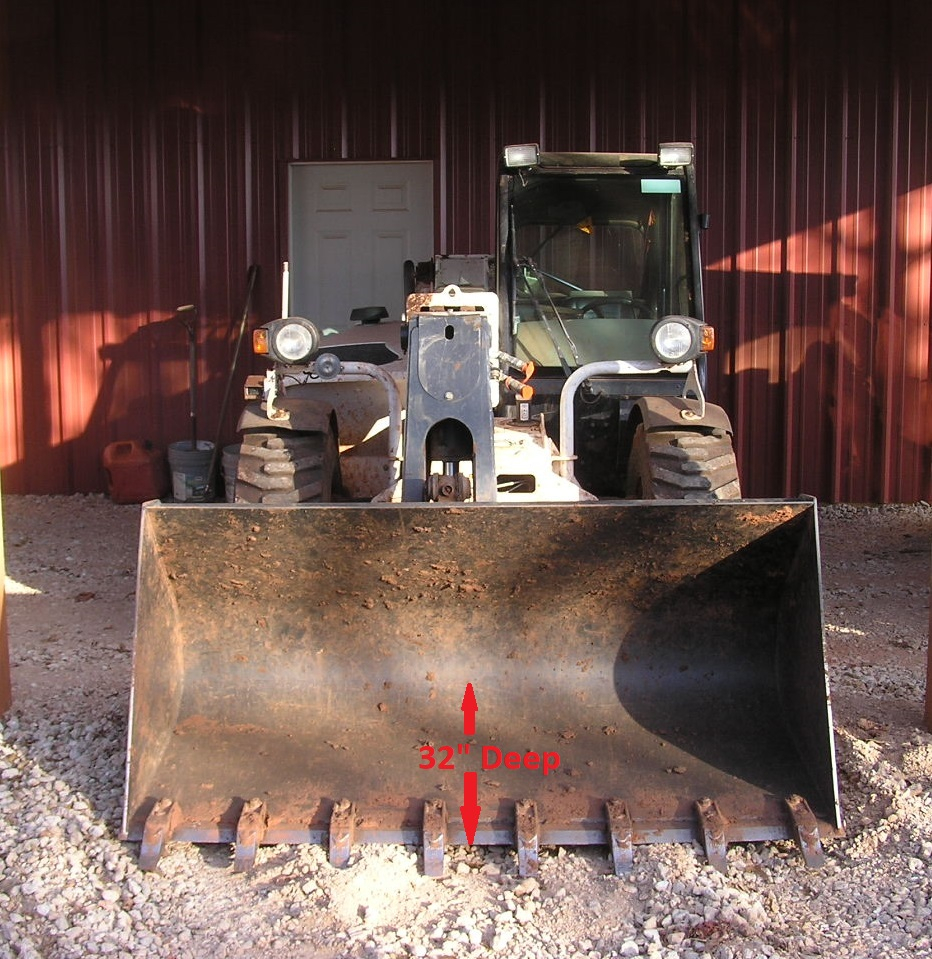

Regarding filling/grading with a dozer: Could a heavy (20,000 pound) wheel loader work just as well?
Based on what my 11,000 pound compact telehandler can do moving dirt with the 1 cubic yard 6 foot wide bucket, I would say yes the wheel loader could do it.

@Xfaxman If you have operated both a compact wheel loader and standard wheel loader, how does the stability compare to your telehandler? How has maintenance been on your machine? I had been eyeing a ground-engaging telehandler for a couple years, but they have have always been outside of my budget.
   / Least Tippy Machine #38

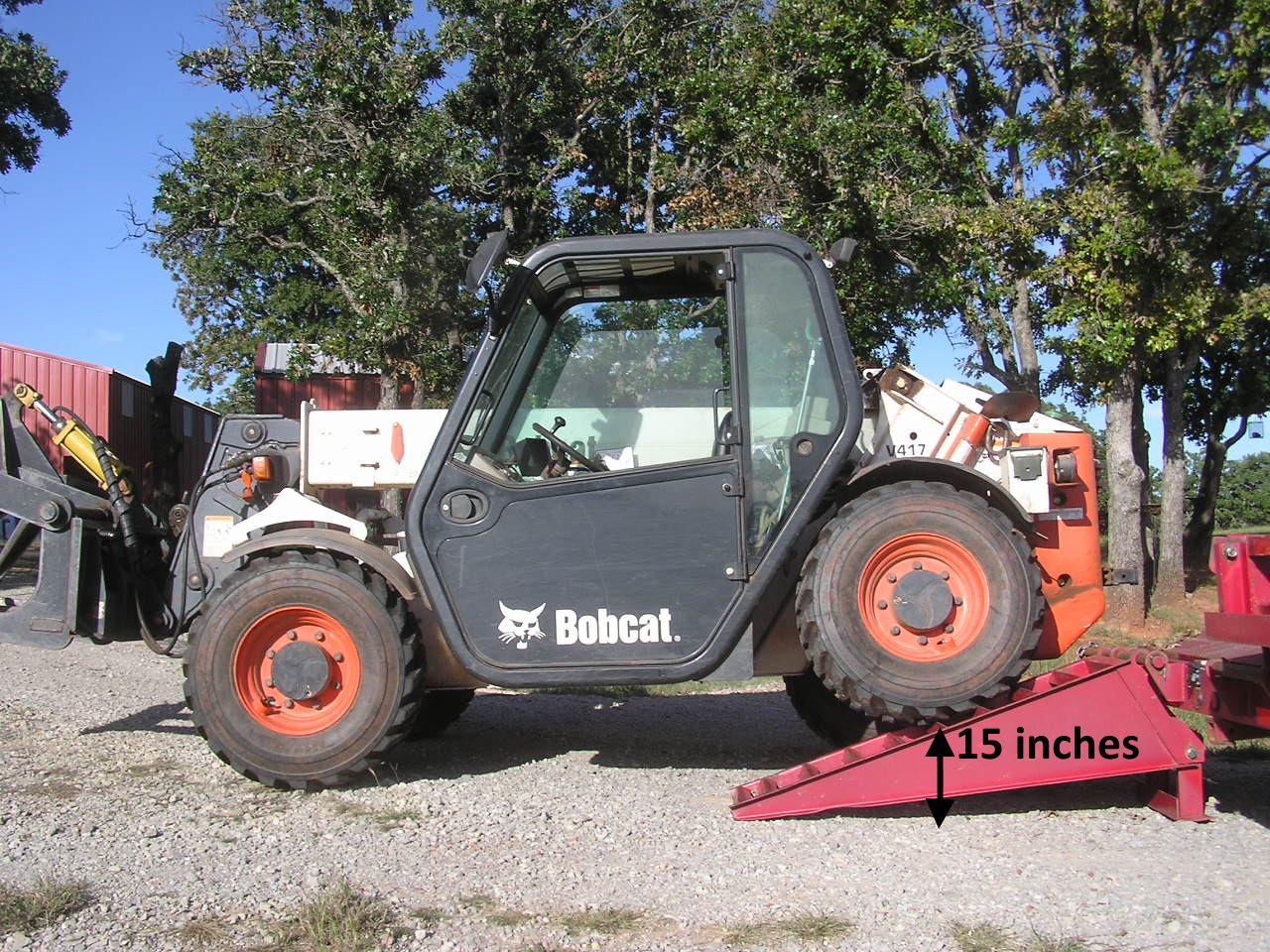

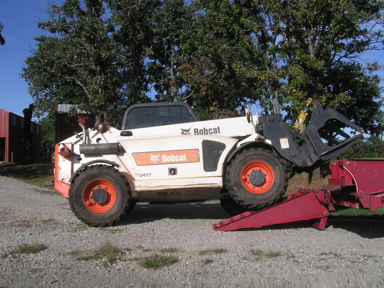

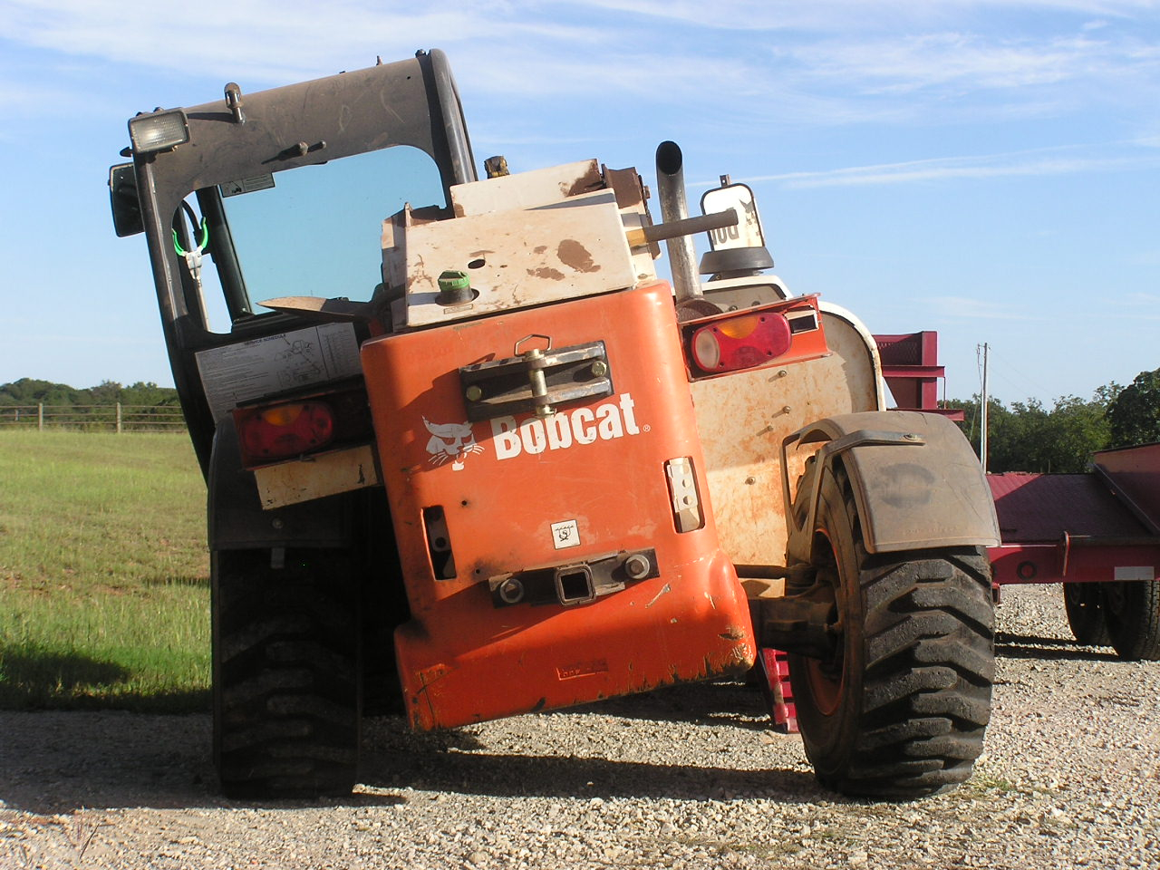

Have not operated a wheel loader, I am judging their performance from watching videos and no pivoting front axle, same as my dirt digging compact telehandler. So it is not tippy like a tractor.
I did a direct comparison with a Bobcat T300 using my toothed bucket and mine dug hard clay and sandrock where the T300 just spun the tracks.
Maintenance has been no problem. And it has done everything that I have needed a machine to do since I got it back in September of 2009.
Never have wished for my tractor back.
