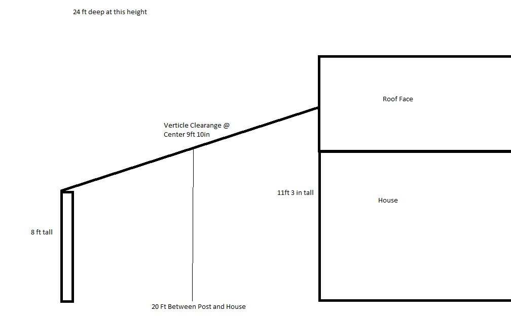

So in these very basic, and not to scale, drawings you can see the lean to shed from one plane. The length or depth of the shed is dependent on the height because of the roof overhang that i'm working with. The taller the shed is the narrower the roof line is. I don't want to go any less than 24 ft long/deep. Obviouisly I can go shorter and gain more length. But is 9ft tall with a 2/12 pitch and 5'5" at the post end TOO short?
Also the span tables confuse me. I will be using southern pine on this project. And if possible would like to run the rafters unsupported from house to the post. If need be I can put another post, or set of posts, down the center of the shed to support the rafters.
Please advise.
Like I said, the span tables are like greek to me.

It all depends on your use and what you can deal with. I wouldn't go less than 6 feet on any wall because I would end up hitting my head on the rafters eventually. If I wanted to get my tractor in with the ROPS up, I would need 8 feet minimum. Your choice.
Take a look at the span tables again. It's not so complex. You can pick a table with the lowest loading and highest deflection because you don't deal with snow and I'm assuming you will have a light roof like metal. The tables usually have the rafter spacing (12", 16", 24" etc.) on the vertical column and the grade of lumber on the horizontal. The body of the table shows span. Looking at southernpine.com, and the lightest rafter table (20 psi live load, 10 psi dead load, deflection limit l/180) I find that you can span 19 feet with 2x8 on 16 inch centers with No. 1 lumber. Because I know the tables are conservative and we are talking about a shed, I wouldn't worry about 19 feet vs 20 feet and I might go ahead and stretch it to 24 inch centers. The other option, of course, is to go with manufactured half trusses. Then you could go to 4 foot or 8 foot spacing.
It's your decision.

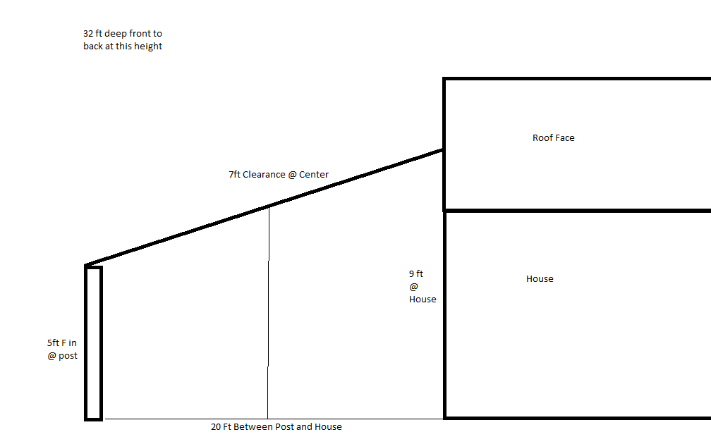

... But is 9ft tall with a 2/12 pitch and 5'5" at the post end TOO short?...
5 1/2 feet is up to you on your height. There is no rule on how tall a wall has to be for a lean to, it's just a question of how often you will hit your head when you are in that area?
The other question is if your measurements are for clearance under your rafters or to the top of your rafters?
Here is an easy to read span table that gives you 20 pounds live load, which is pretty good. You will have to use 2x10's to go 20 feet. The table says that if you use number 2 southern pine, which is very common, you have to space your rafters 16 inches.
Rafter Span Tables
If you use 2x8's every 12 inches, you might have some sag in that roof eventually. 2x6's should not even be considered for this much span. In my mind, the small additional cost of the proper sized lumber will be cheaper in the long run when you never have to deal with any issues in the future.

So if I use my taller Design i can actually extend it out further to 24'. With exterior wall around 7 ft 4in. Yea that's at the roof. I'm thinking a 2 12ft openings (minus post widths will be better. The rafter runs could be in 2 separate boards. One from the house to the midway post and another from the midway post out to the exterior wall. Would running 2 Boards for one rafter make sense? How would you join the 2 together? Bracket them to the midway post? Also for the header board on the existing house if it were to be 24 ft long along the house would I just double up boards and stagger the seams between boards? 16 and
ft and 8 ft from left ro right for first layer and 8ft and 16 ft from left to right for second layer? What size board for header ledger and run between the midway posts?

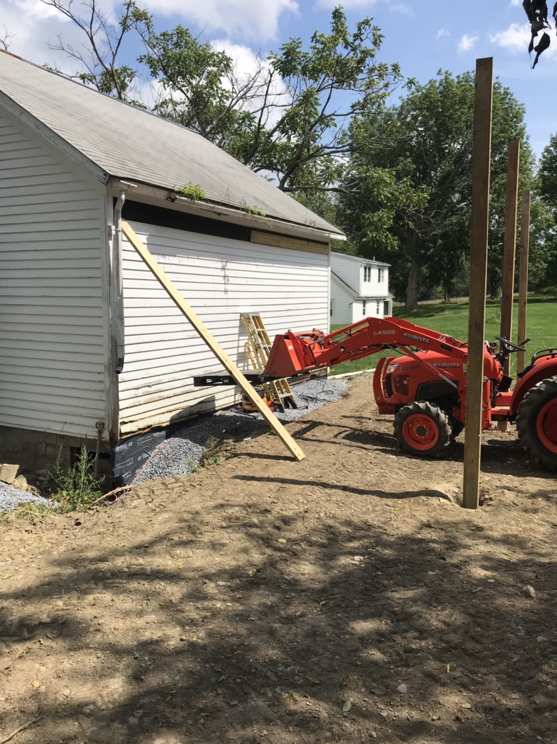

Maybe an actual pic of what you are working with?

I'm sorry. I thought I had posted this picture. The roof runs perpendicular to the side of the house that I'm working with. Cost and ease and installment is the biggest reason. Also structure is sound level. It will remain as it is for the foreseeable futureIMG-20190803-WA0001.jpg

On our property we have an old house that had a fire in a portion of it. The house is unusable and will eventually be torn down. I am looking for some additional covered storage out there. I was planning to put a lean to on one side of it. I am new to this type of building but am good with my hands and love to learn.
Do you have power to the building? That weather-head should be raised, but if you leave it where it is, that is going to severely limit what you can do off of this side of the building.
Looking at the picture, and re reading what you originally posted about the condition of the building, and they need for storage, I'm wondering if you could just remove the two windows and open up their opening big enough to turn that part of the house into your storage area? Dollar wise, it would be cheaper then any other idea that I can think of. You can get 9 foot wide garage doors from Lowes pretty cheap if you wanted to close it up, or just leave it open like you would the lean to idea. How bad is the roof? Can you cover it with metal like you would the lean to? Put the money you are going to spend on the lean to and create a barn/garage out of the house?
