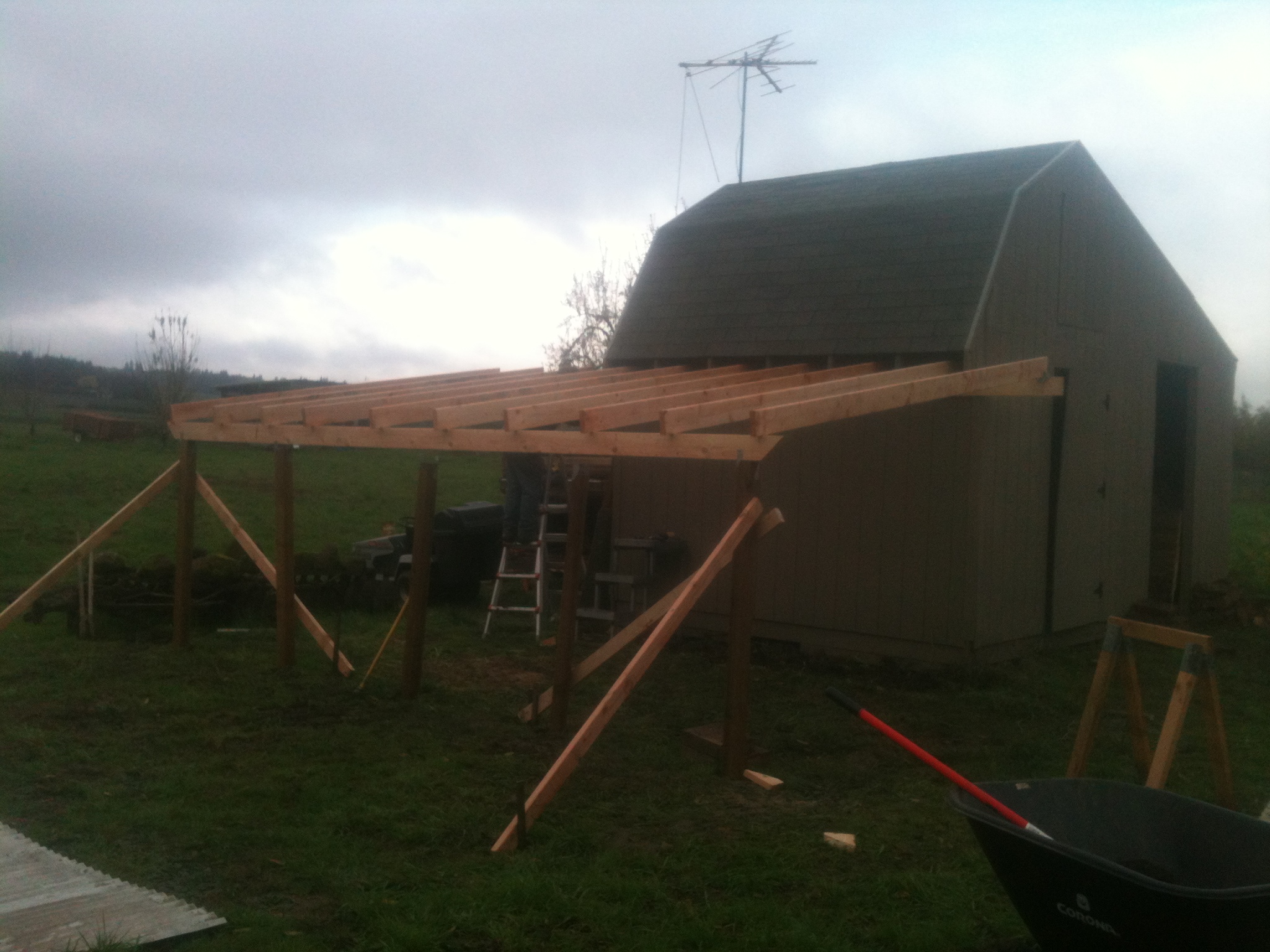

Here's a construction picture of what I built for my tractor, it's 12x20. lag bolted the 2x6 to the existing shed, other end is two 2x6's nailed together with hurricane ties holding that to the posts. The perlins I think they're called are held to both with Simpson brackets instead of notching. I think it just took a weekend to build and I had around $500 in it total with used roofing...

I would call the board along the existing wall a ledger board and the one along the posts a header. The ledger and header should be fastened with lag screws or bolts, not nailed. For best strength put blocking under them or notch them into the posts. The rafters should either set on top of the ledger and header or you should use metal hangers to attach them. That didn't seem clear in the linked diagrams. What kind of roofing are you using? If you are putting on metal, you run 2x4 purlins across (on top of) the rafters and fasten the metal to those. If you are using shingles, you sheath with plywood or OSB and shouldn't need anymore structure. If you did install "blocking" between the rafters, it would be flush but I don't see why you would need them.
What is the height of the barn side and the pole side? Trying to see if i'll have enough clearance and pitch. My issue is the side of the house i'm bolting to is the gable side and i'm dealing with the roofline.

I don't remember the details, built it about 4 years ago, I think the roof line of the original shed was around 8' and I think the other end is 6' so 2' drop over 12' width. It's wide enough for my tractor and the riding mower and tall enough for the tractor with head room (no ROPS, it's too old)
