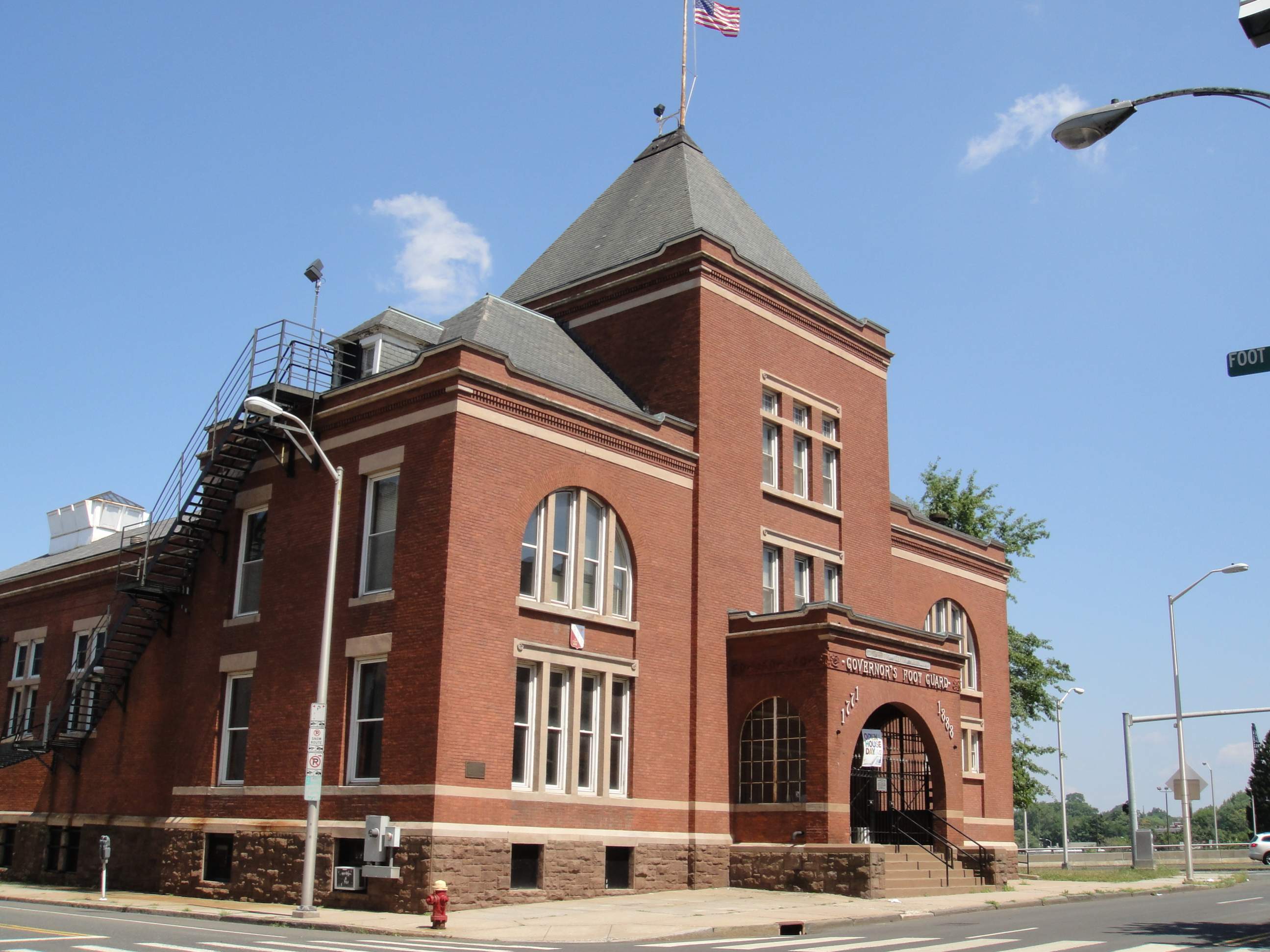

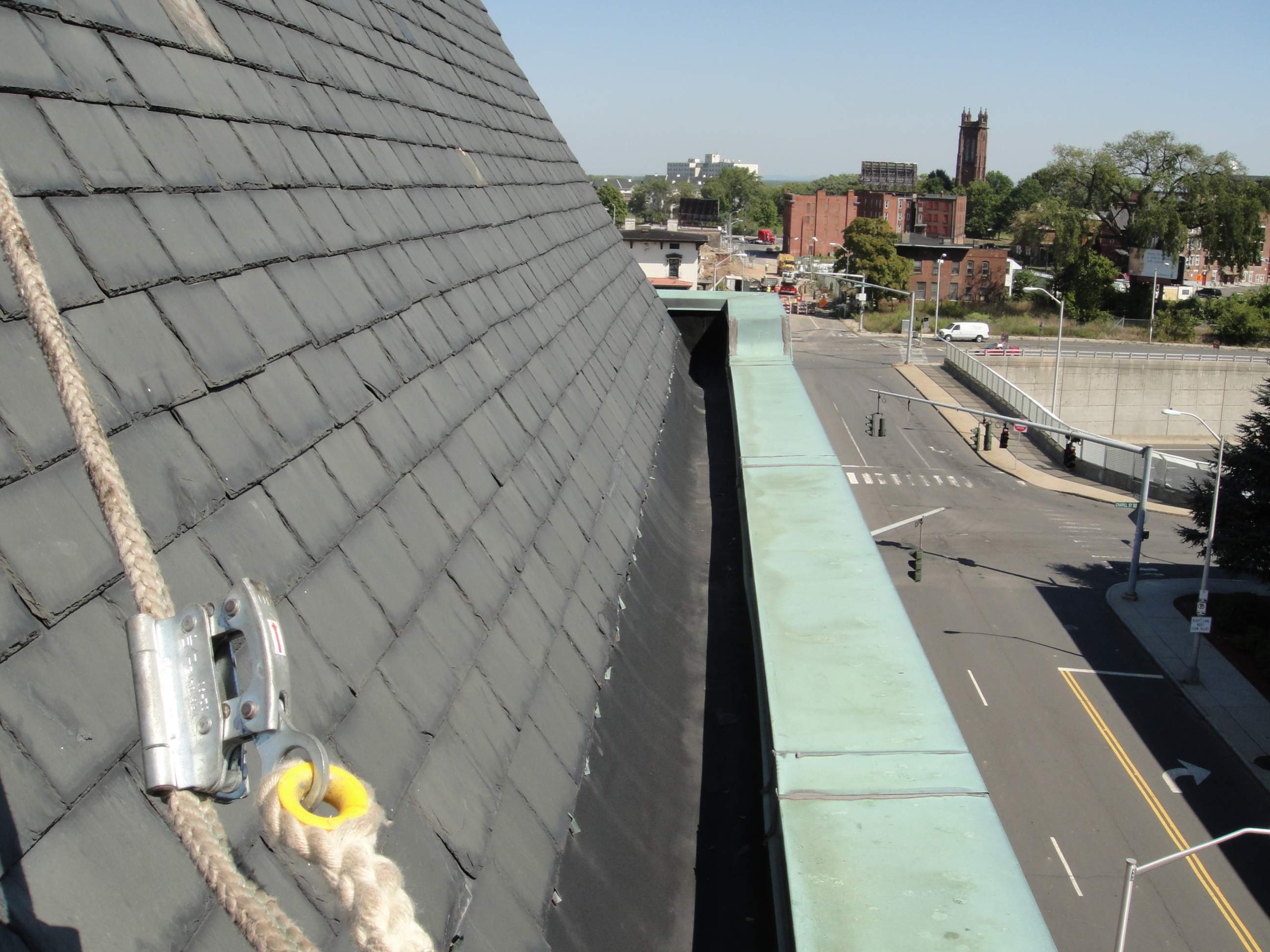

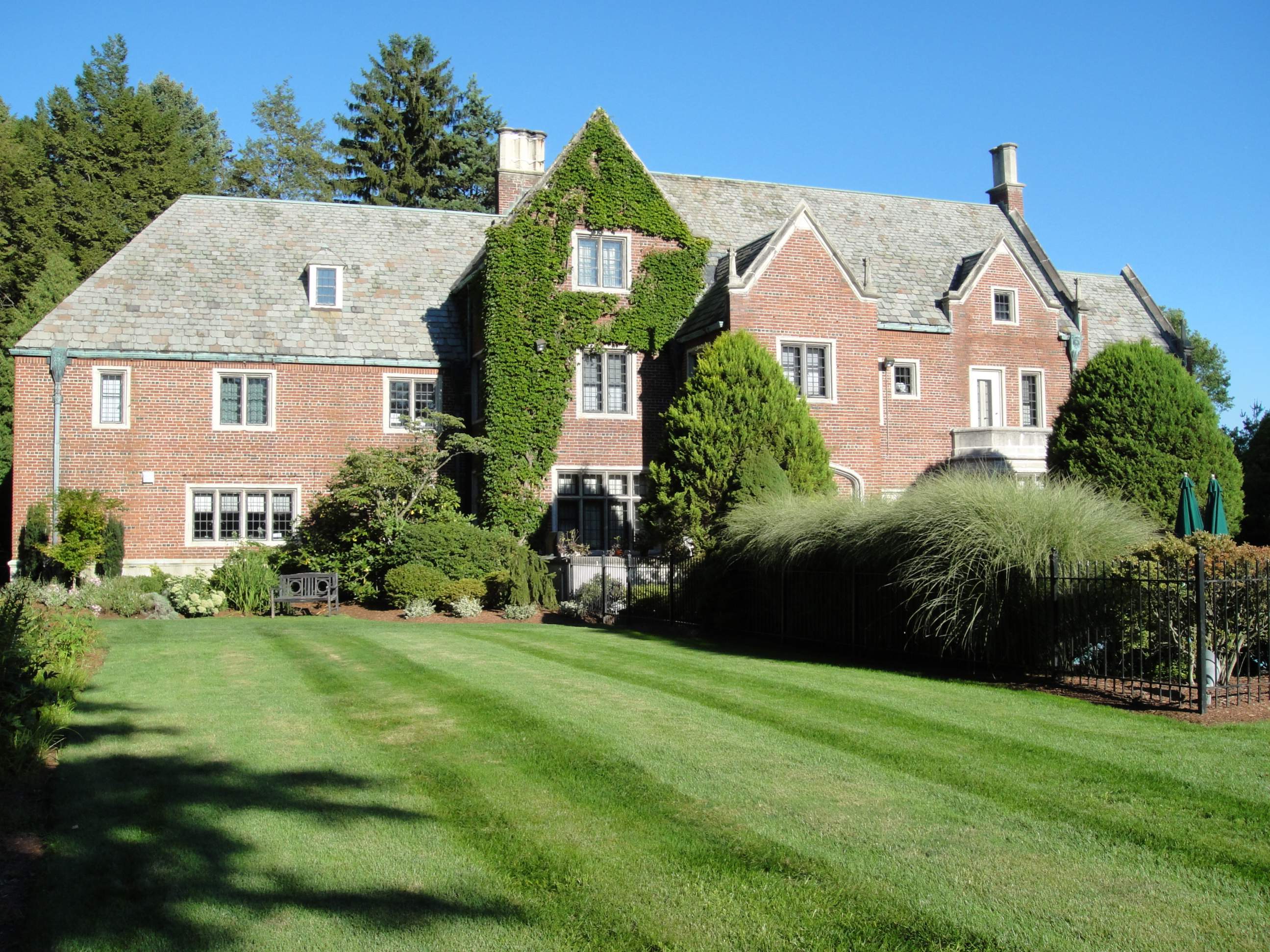

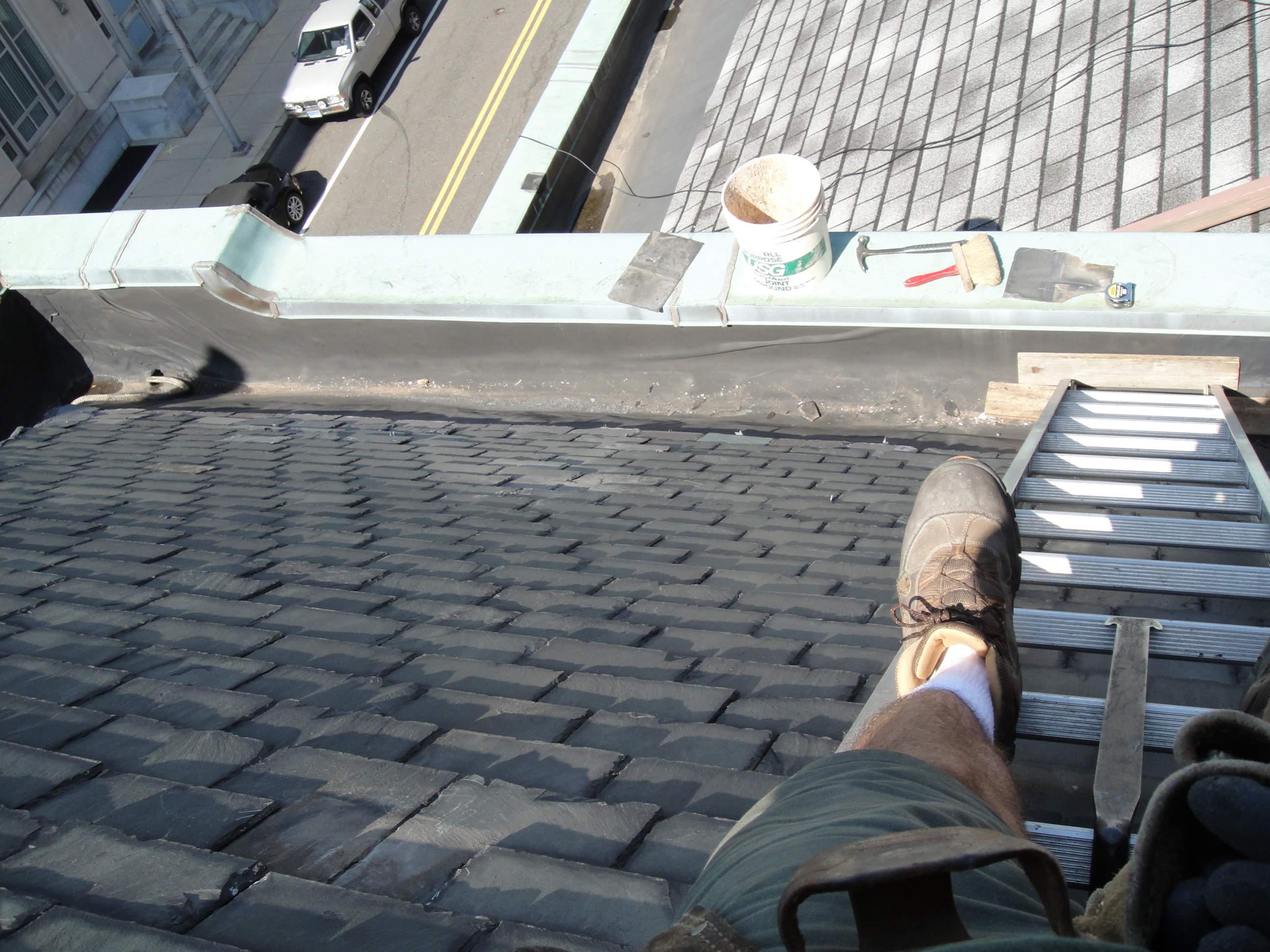

Sounds like they just don't have experience in it. Personally I enjoy working on slate, you can tell by my showing off the pictures. Slate roofs are mostly found on historic and high end homes and institutions. Working on those types of places sets me apart and above all the other roof monkeys, at least by a little :)
