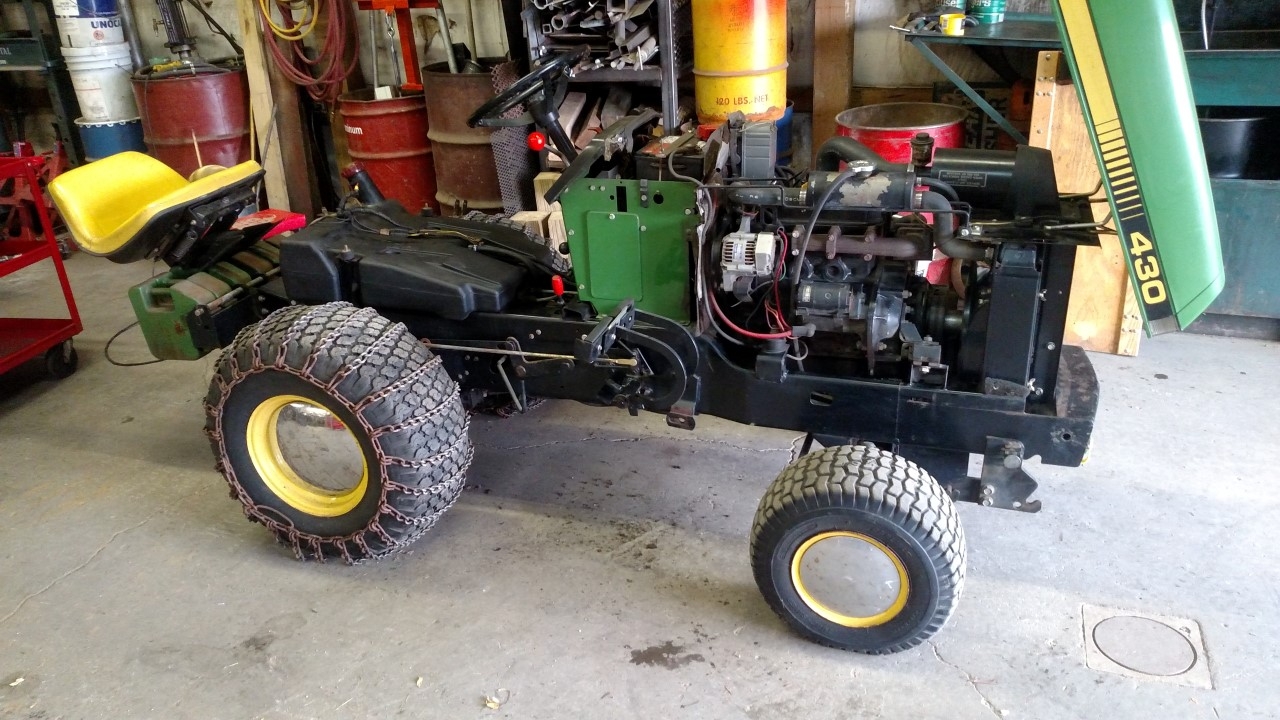

I bought this 1987 430 which has under 800 hours, to eventually replace the 1976 JD 300 we have been using for over 30 years for all-around hauling of small stuff and mowing of rough areas, where I don't want to take my Kubota F mower and tractor with flail mower & loader would not easily fit.
The JD 300 has served us very well and is still in excellent condition, but I have wanted to switch to Diesel with power steering for some time!
The 430 is now parked in my shop with the sheet metal removed and I am in process of inspecting everything over time, changing fluids and repairing or replacing anything that is needed.
This is not meant to be restoring project - just inspect & repair as needed, and will probably be completed sometime this fall or winter.

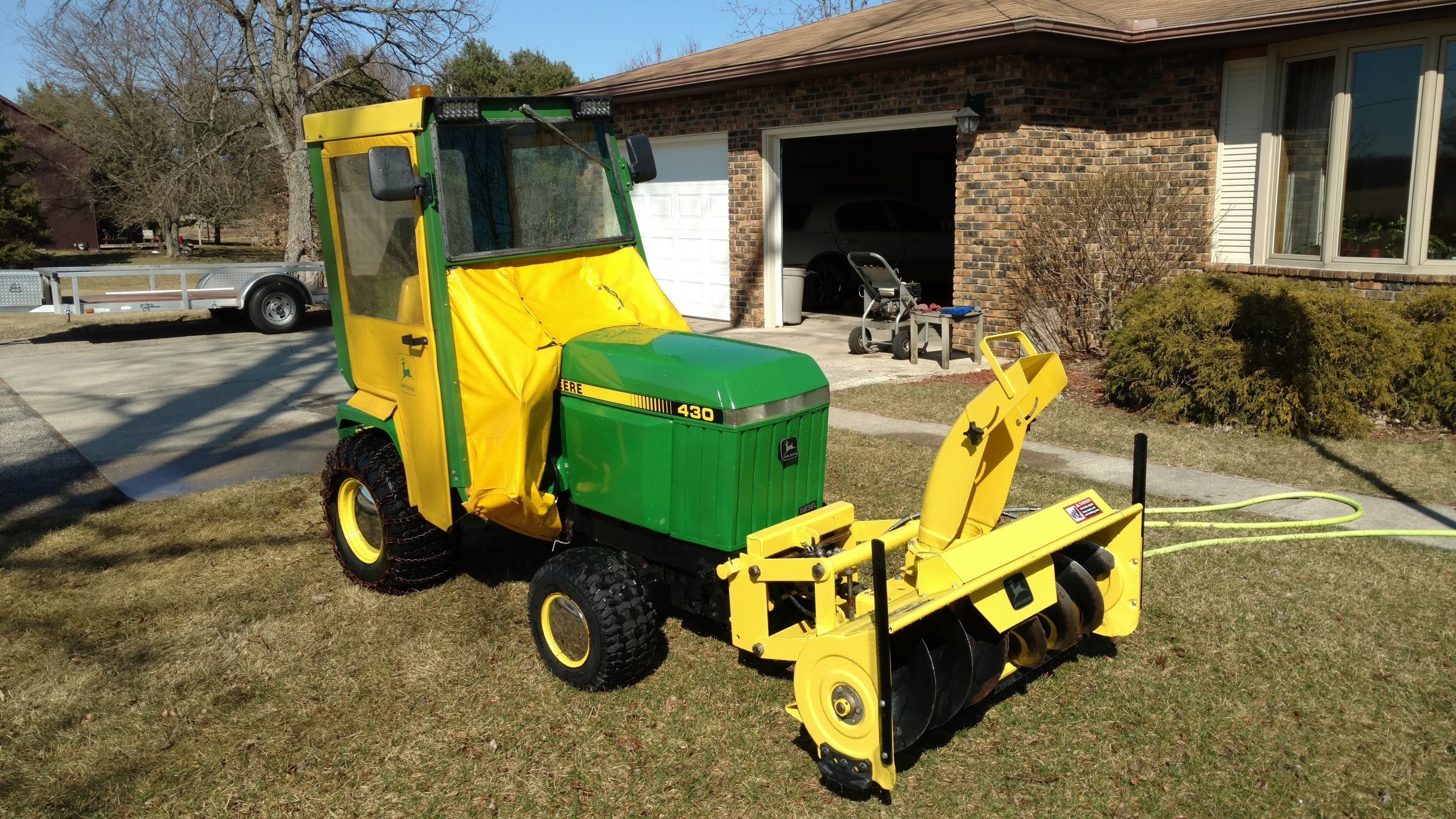

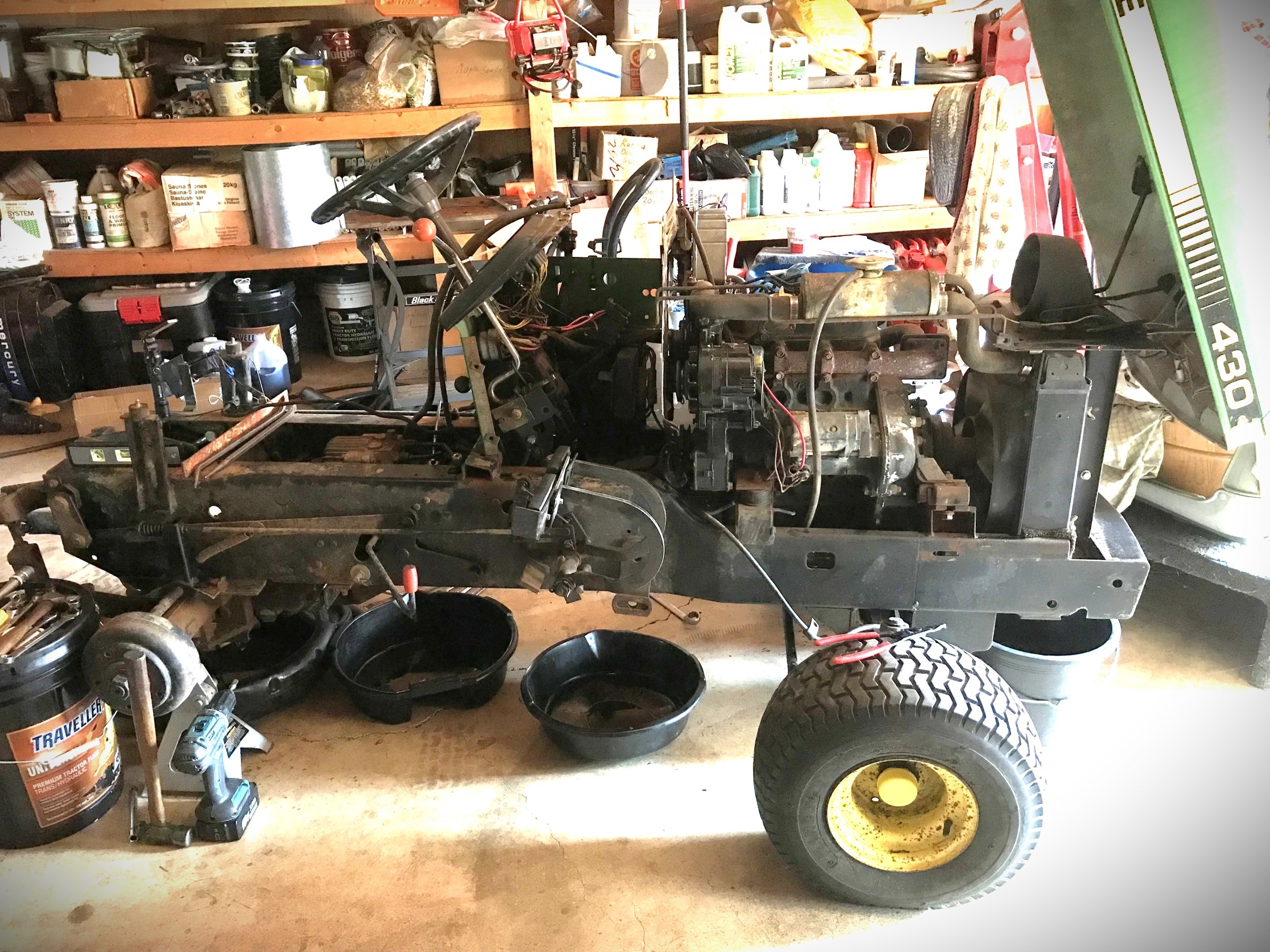

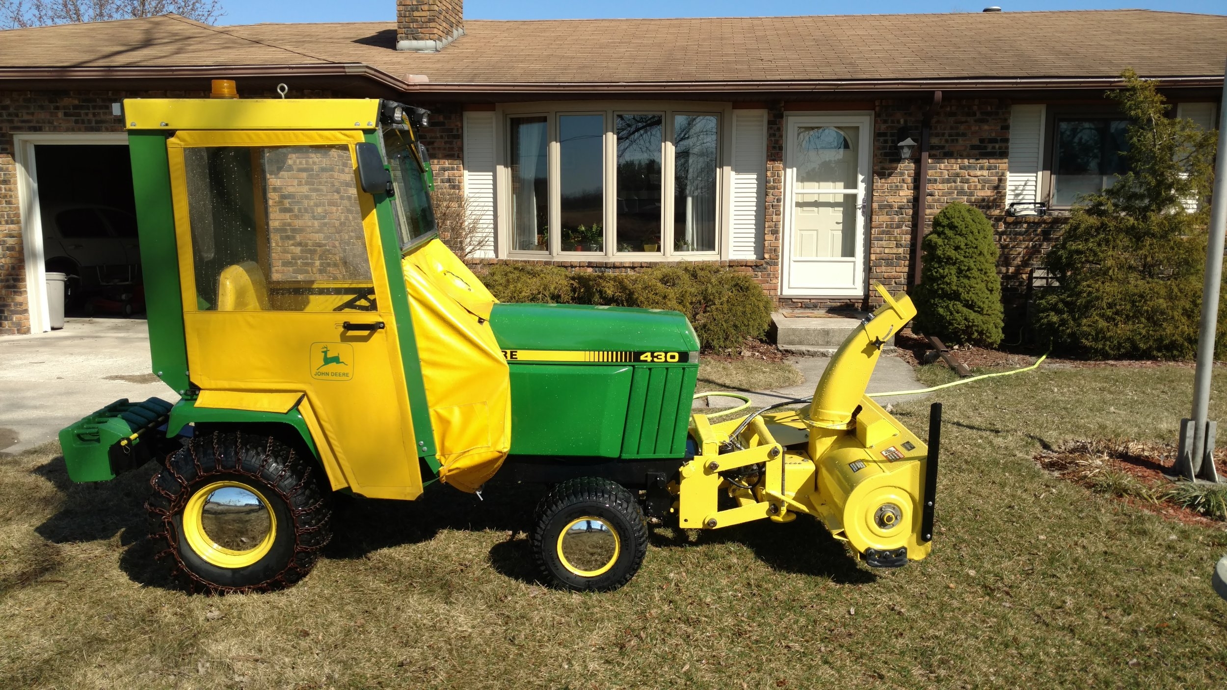

I bought my 430 in 1993 with ~200 hours on it. I've used it for mowing and snow removal ever since, still has only ~1100 hours on it. I pulled all the metal off a couple of years ago and had it blasted and powder coated JD green, also had the hood painted and new decals all around. Since I bought my BX2230, the 430 is dedicated to snow removal, which has been pretty rare in the last few years.

I bought mu 430 in 1993 with ~200 hours on it. I've used it for mowing and snow removal ever since, still has only ~1100 hours on it. I pulled all the metal off a couple of years ago and had it blasted and powder coated JD green, also had the hood painted and new decals all around. Since I bought my BX2230, the 430 is dedicated to snow removal, which has been pretty rare in the last few years.
View attachment 881770View attachment 881771View attachment 881772

I noticed the tire chains in your photos and am bit concerned about traction (or lack of) in 430 with the Diesel engine up front. My old JD300 has it's traction limitations, but I have learned to live with it over the years and will use a 4x4 tractor or ATV when heavier hauling is needed.
I ordered cast iron rear wheel weights and hoping those together with the differential lock will be sufficient most of the time.
The last time I had to plow my driveway was December 2008...

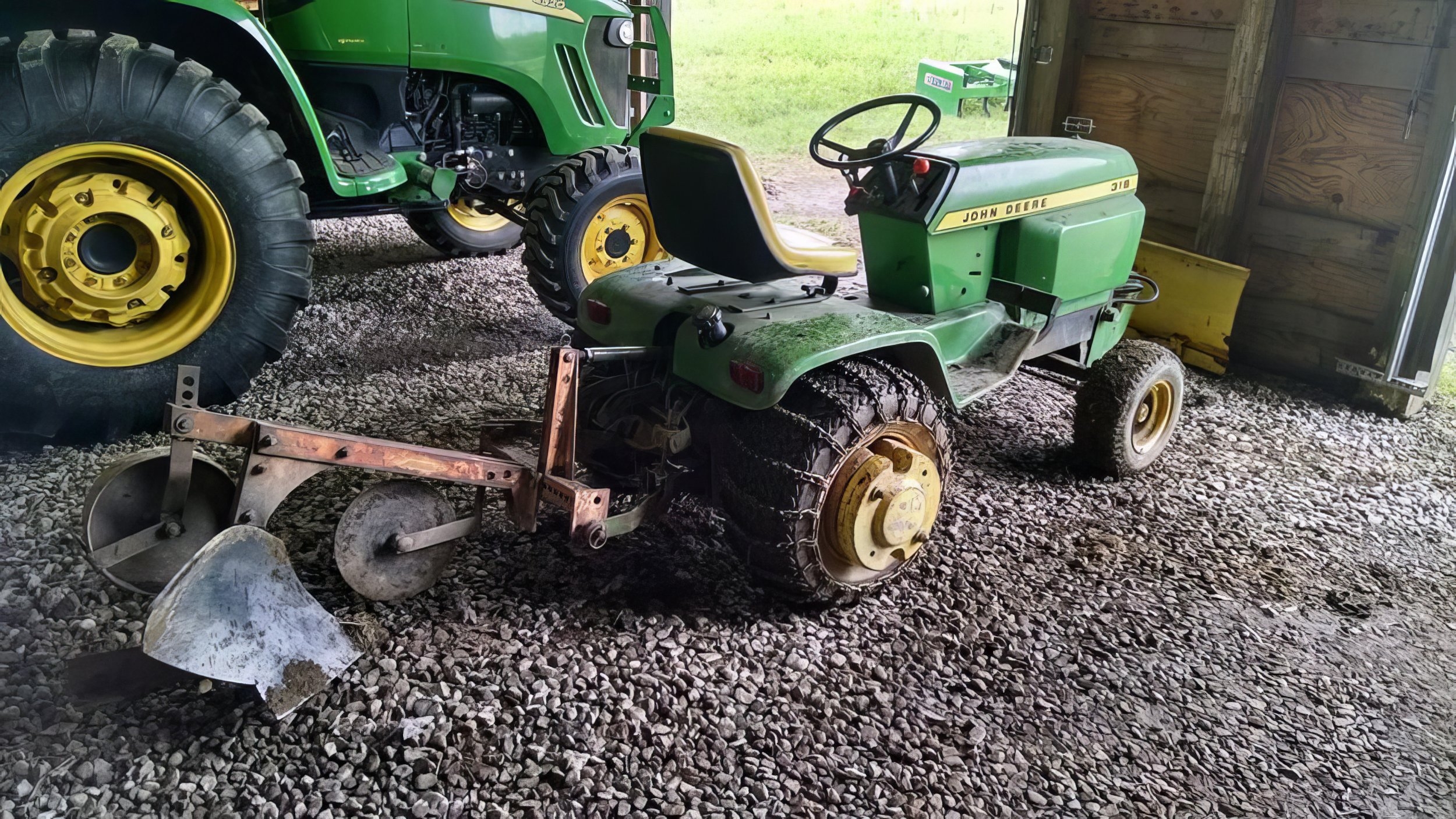

My dad bought a JD 140 H3 back in 1969. The wheel weights you see on my pic of the 316 are the ones he bought. Was in the process of selling that tractor when I wondered if those weights would fit my new Kubota BX 2680. Well, they fit like a glove. Nice to know I still have some of dad's tractor with me.

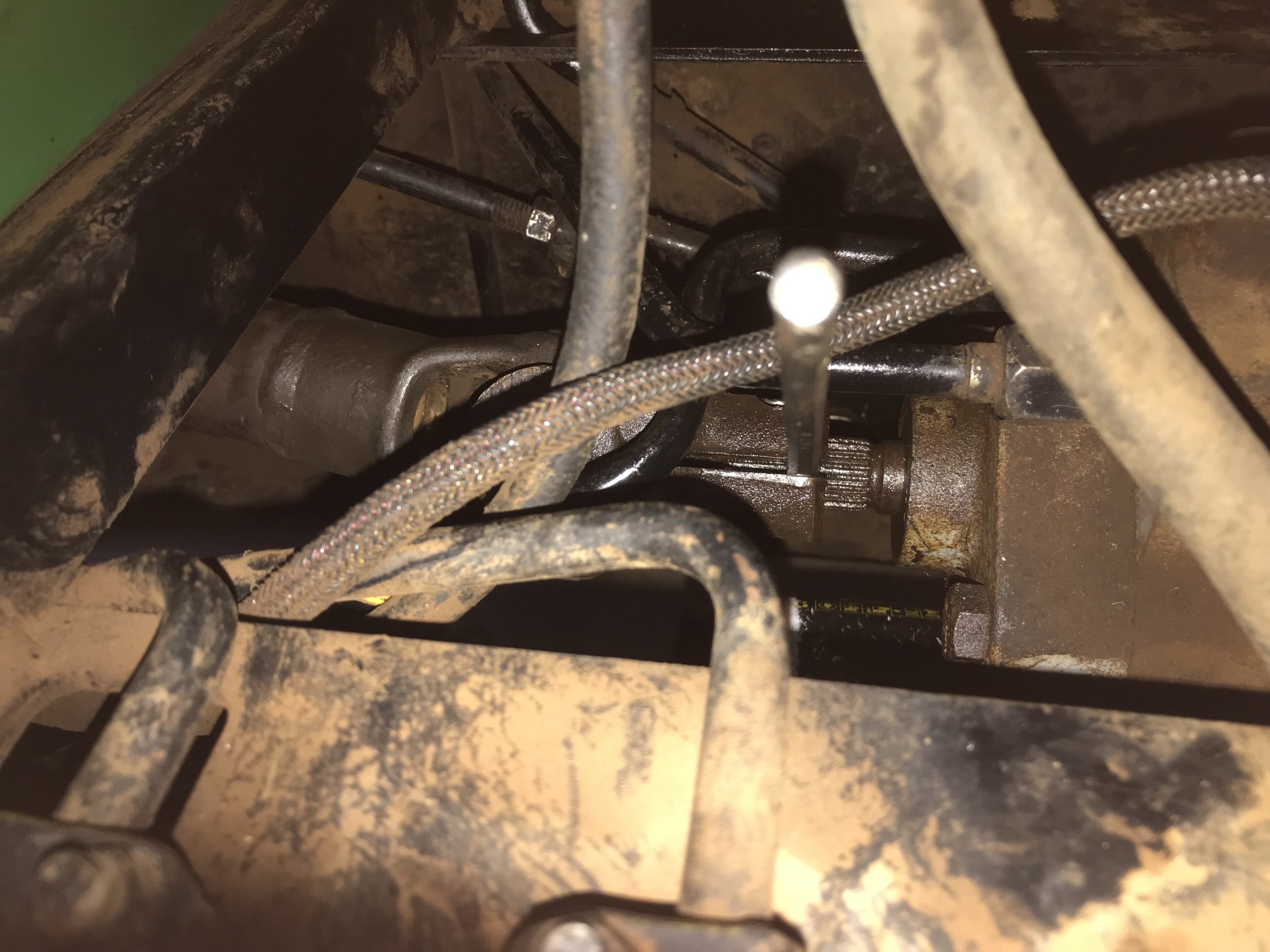

My plan all along was to service & dismantle my "new" 87 JD 430 enough to be able to inspect hydraulics, drive train, belts, drive shafts etc. in order to repair or replace whatever is needed, in order to make this into a long term use reliable garden tractor.
I have ran into a little difficulty when trying to remove the drive shaft rear yoke from the hydrostatic pump shaft!
It looks like it has never been removed previously, and has gotten stuck in the shaft (IE. rusted in place over 37 years). The front end is already loose and has cleared the engine V-belt pulley so that's not holding it.
I've been spraying WD40 over two or three days and trying to removed it gently, without hammering chisels in too hard in order to loosen the yoke.
Hammering chisels in too hard could easily damage the hydro pump outboard bearing & shaft surface.
Anyone else here who has had to deal with the same issue?
Panels removed for better access:
Two chisels, one on each side of the yoke split:
Lots of WD40, but so far it has not budged:

Not to disappoint you, but WD-40 is not a very good penetrating fluid.
A very good one, but not well known is Blue Creeper, by LogRite
Another is Kroil.
But heat may be needed if absolutely necessary to get it to move off those spines.
Wish you well. Admiral plan to try to do this up right.
/ John Deere 430 I just bought #13
Is there room to get a ball joint removal tool, or pickle for in between the yoke and housing and put some pressure on it?

Arto.... From personal experience, mix up equal parts of red Auto trans fluid and Acetone in a spritz bottle and apply that to the stuck part and do it over a couple days. That mixture has to be the best unlocking solution ever made. I keep a spritz bottle handy all the time now. You will have to agitate it prior to using as it will separate if left sitting. Better than even PBlaster and much, much cheaper...

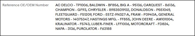

Edit:
It is Stanadyne Model 80
Replacement filter part No. 27288, John Deere part no. AM101004
Cross Reference:

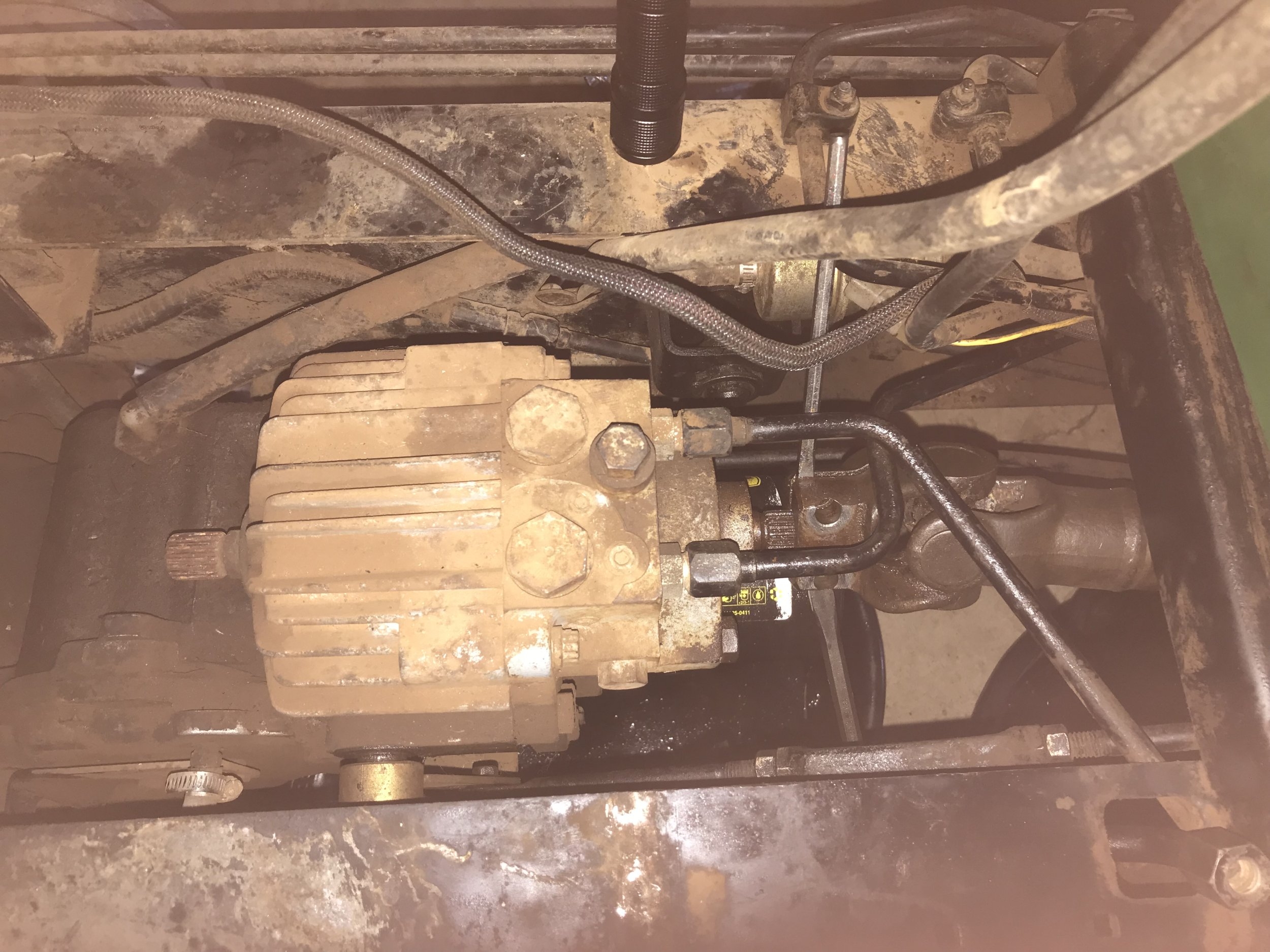

Can you do something on the other end to get some pull on it?
I don't think it's advisable to start pulling or prying the pump input shaft outward too hard, at least at this point yet - I have tried prying it just enough to notice there is a spring loading pulling it back towards the pump!
Still studying the Sundstrand Series 15 Model 90 manual I found online and checking YouTube videos to see if anything is mentioned about axial thrust or pull, but so far no luck.
Here's the other end of the shaft:
It's a tight fit but according to JD manual it will come out, once the other end yoke is off the shaft.

Just thinking out loud I pictured doing something on the other end of the shaft. I assume it has a u joint also? Putting something through the u joint that lets you pull or hammer on to get a straight pull. My guess is a good pull will pop it off.

Good idea, holding it back somehow from the back end would help for sure!
There was nothing at the back end of the "input shaft", behind the hydro pump (see the middle photo in post #11 above), but the spline indicates there may have been rear PTO shaft connected at one time?
I am getting a good used spare driveshaft delivered in few days and perhaps the yoke on that one can be attached temporarily in order to hold back the pump shaft.

In addition to 5030's suggestion, after applying the mixture, smack the U-joint in the area where it is over the input shaft, with something heavy. But you will need an assistant for this as you MUST have something even heaver on the opposite side of the U-joint to absorb the energy.
I suppose you could place a sturdy jackstand under the U-joint and then lower the tractor down until it is resting on the stand, then hit the top of the U-joint.
Heat will also work, but I would be afraid of ruining the oil seals on the input shaft.
