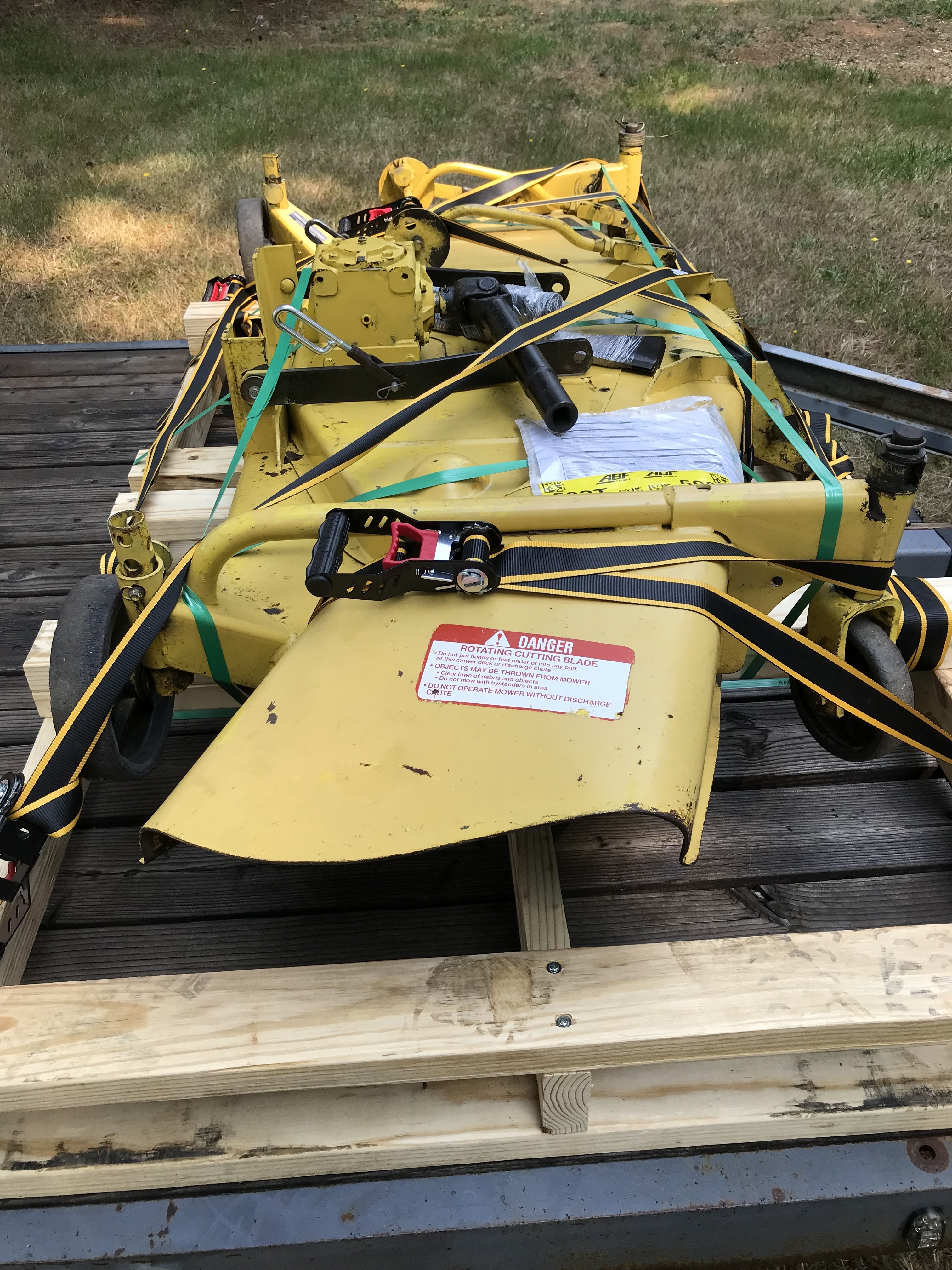

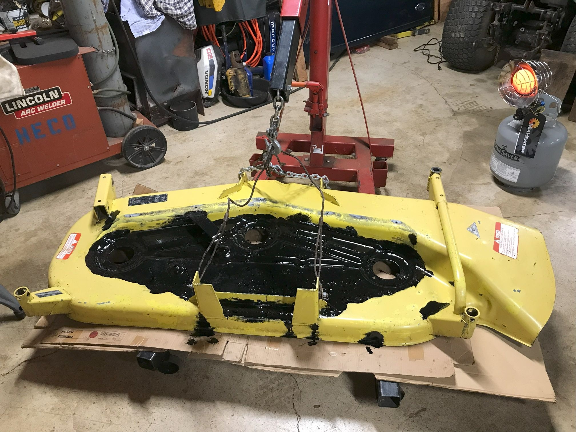

As mentioned in earlier post #24, I bought a used 60" JD400 mower deck in October and instead of using it as is decided recently to take it apart & overhaul completely.
Underneath the deck is in excellent condition and practically does not need any work, but it had some surface rust up on top where the safety shield was.
Under the shield there had been some (wet) grass clippings, hidden from the previous owner!
Here it is after surface prep and coat of Por15 paint:
After surface prep and a new coat of top paint:
I will probably delete the shield...
Overhauling the spindles & refitting new idlers, wheels etc. is in progress now.

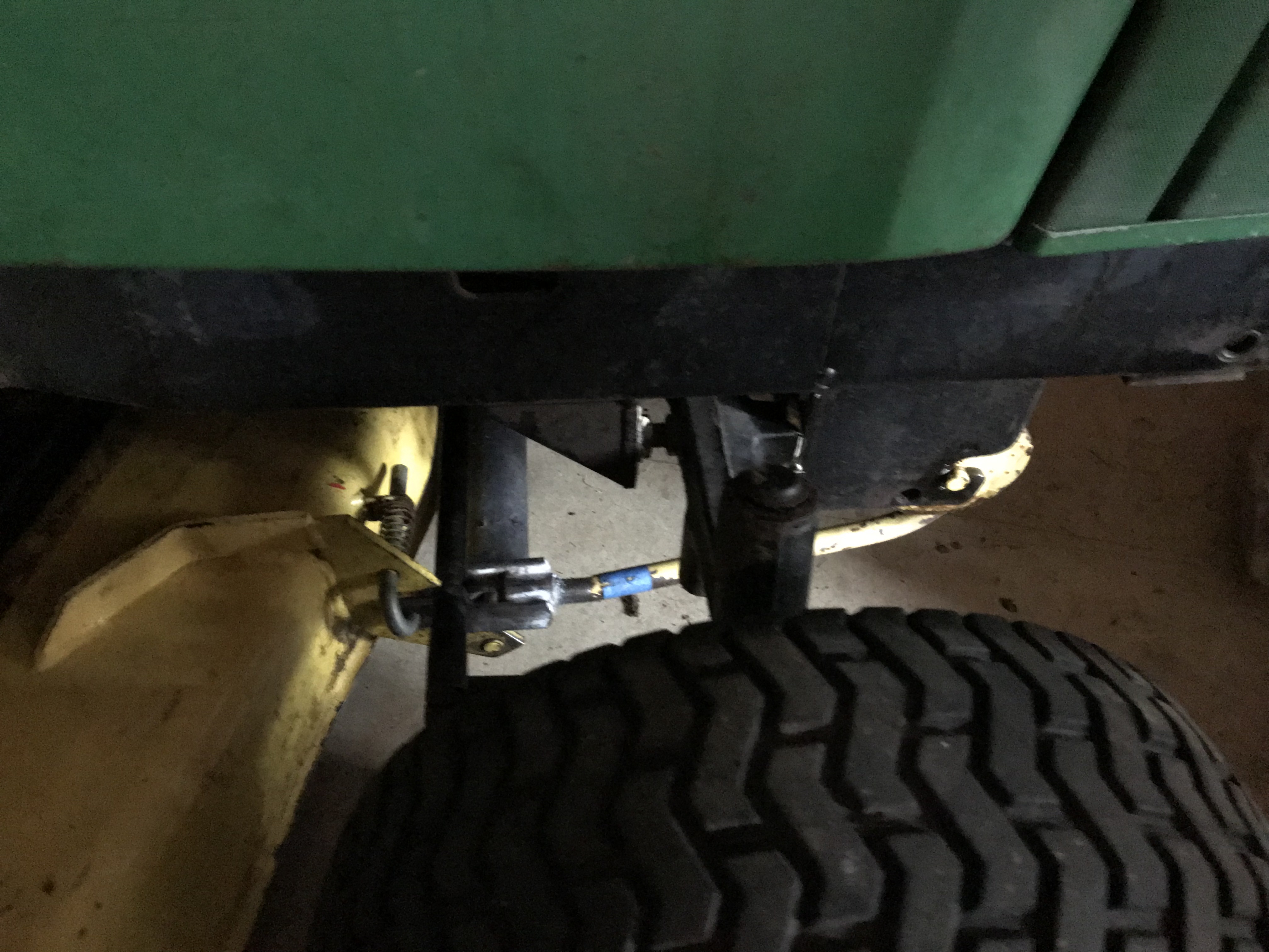

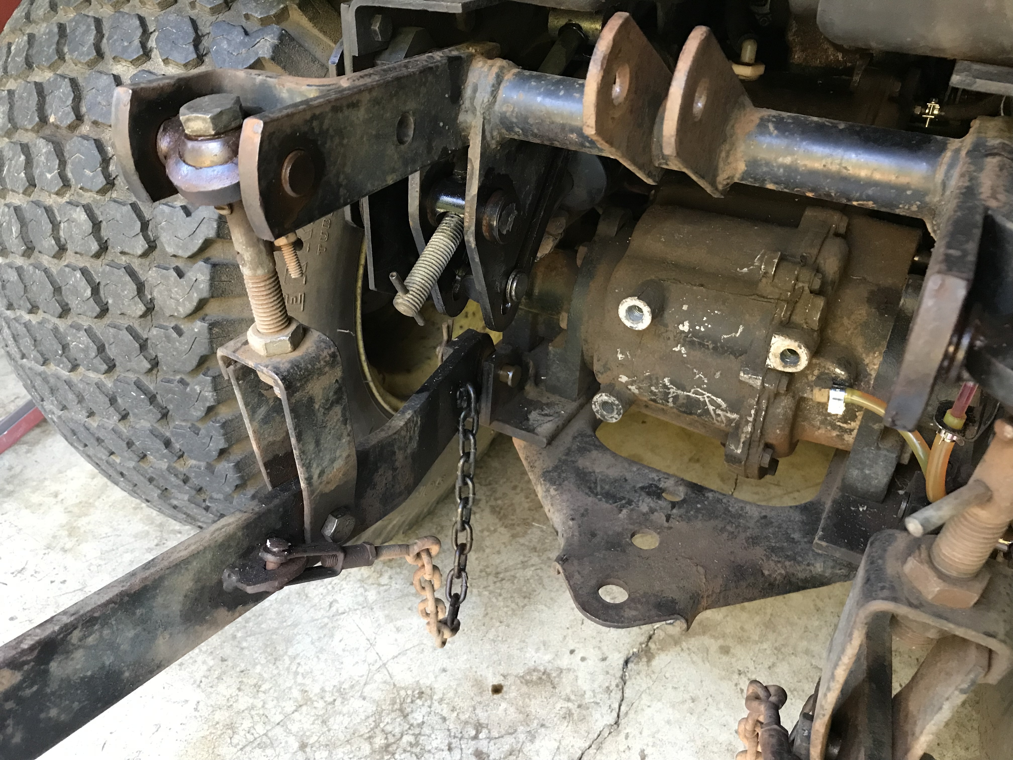

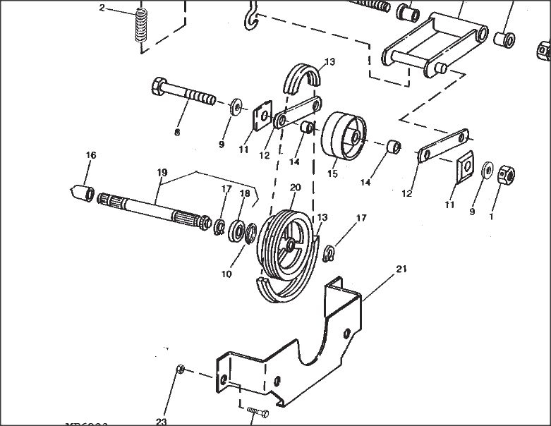

Am I correct that by front axle "outriggers" you are referring to items 24 & 23 (M16 x 40 mm bolt & nut)?
It was easy to adjust the excess "slack" on the right hand side on my JD430, but the left side bolt is seized tight and looks like the easiest way of deal with it is when I will take the front PTO apart for inspection in couple of weeks.
It should be pretty easy to remove the front axle and deal with the seized bolt at the same time when inspecting the PTO belts etc., shaft bearings & front axle pivot bushings.

Front PTO:
It's noticeable that the muffler setup in this JD430 has been worked on at some point in time, and it is all intact now.
We will see how well it holds up in future...
Yes, 23 & 24 look like outriggers that rub the axle saddle in the frame... adjust out the slack and you'll be good!
