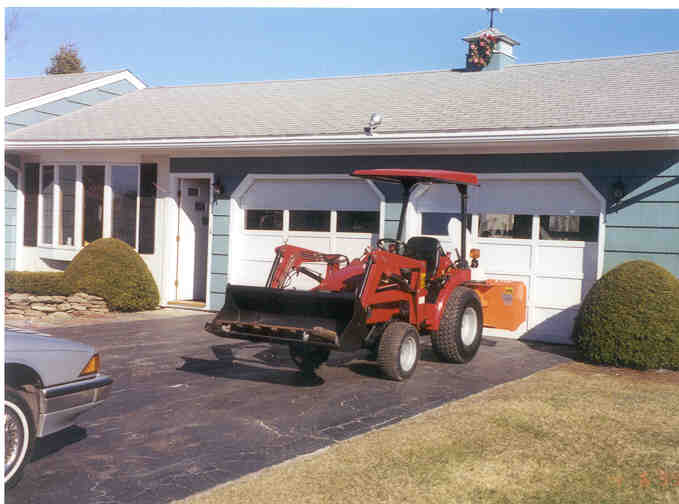

I have a 1994 Case 1120 with the CNH/KMW-ALO loader and the cool remote control located on the free-standing pedestal and that loader came with the factory 54" bucket. The bucket is great since it clears the turf tires (I believe CNH used a larger turf tire on both front and rear Bridgestone than Mahindra does. I will say it lifts gravel just fine but is not over powered while it is going that way. I would like to see the 2015 and the 2415 with the 54" option.
Brian
Boston, Ma
/ Larger bucket on a ML104 loader #5
Here is my baby. Paid $8500.00 cash in 1995 for the tractor, loader, grader blade, bush hog and full factory remote Hyd and the OEM sunbrella. The guy paid $15,500 from Hazelton in 1994 and left it outside for a year cuz he could not get it in his garage. I guess he never figured out the ROPS folds. I already had the Kubota 2551 thrower and that is a Woods RM550 finish mower.
