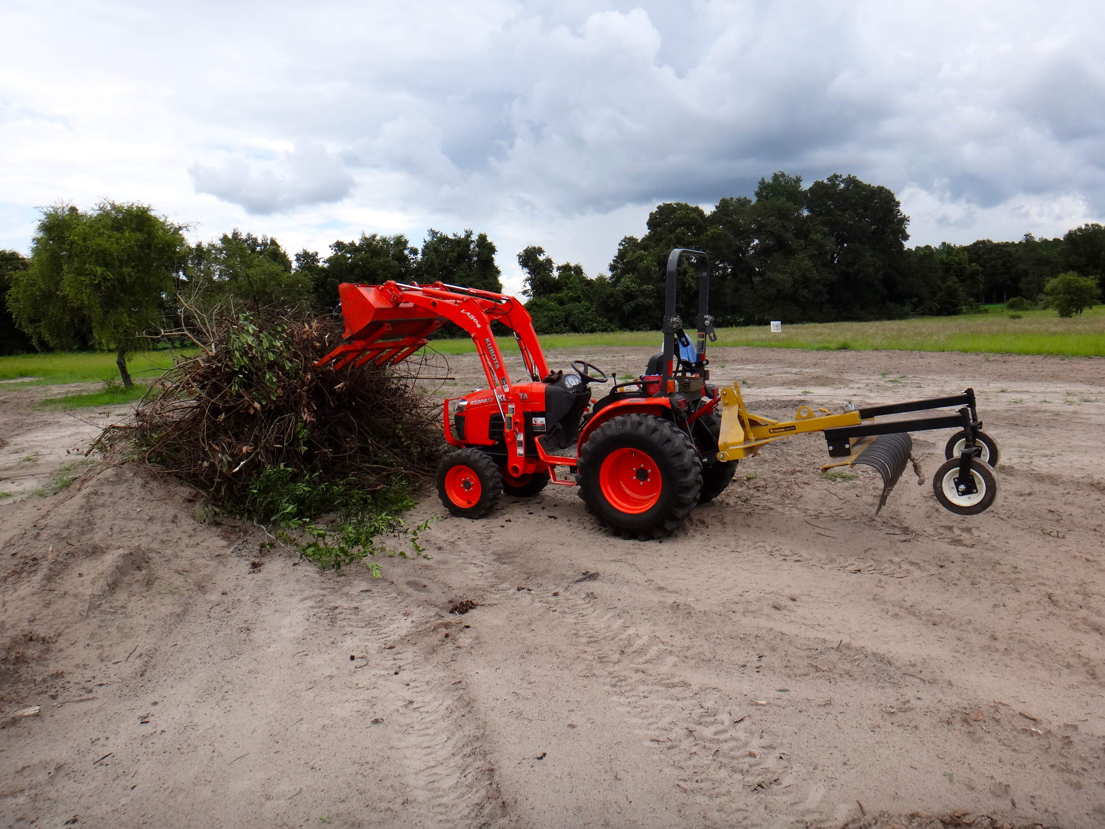

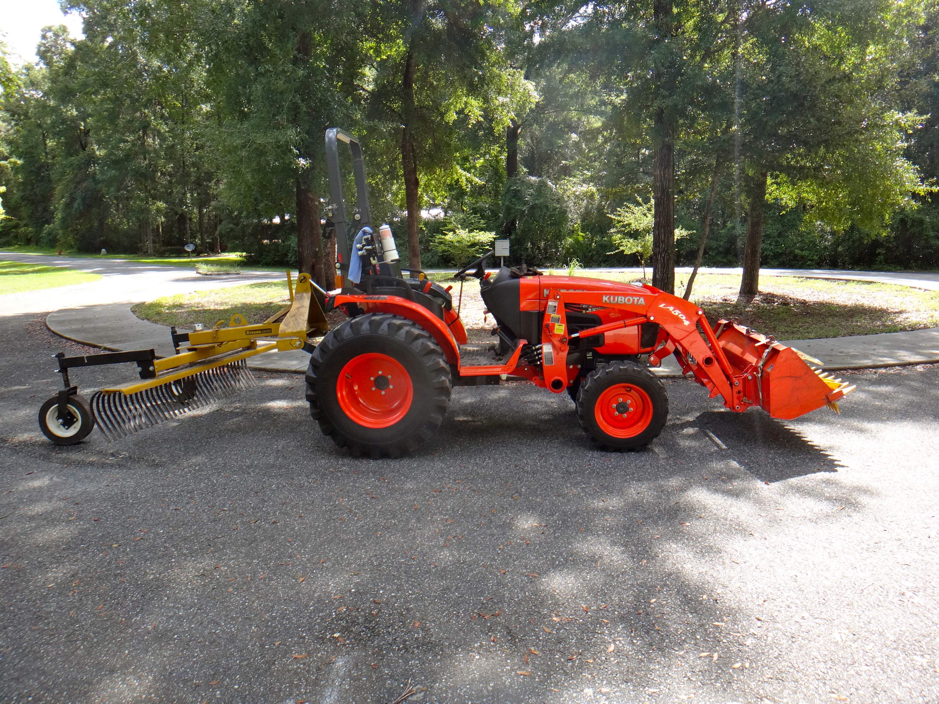

I have never tried a rock rake but own a 7' KK landscape rake. I cleared a 1/4 acre food plot in the middle of my woods and the landscape rake worked great at raking up all the debris. I'd get it in a pile then use my grapple to move it to where I wanted it. The landscape rake works great on other things as well such as gravel roads and driveways. For smoothing gravel or dirt I turn the rake backward.

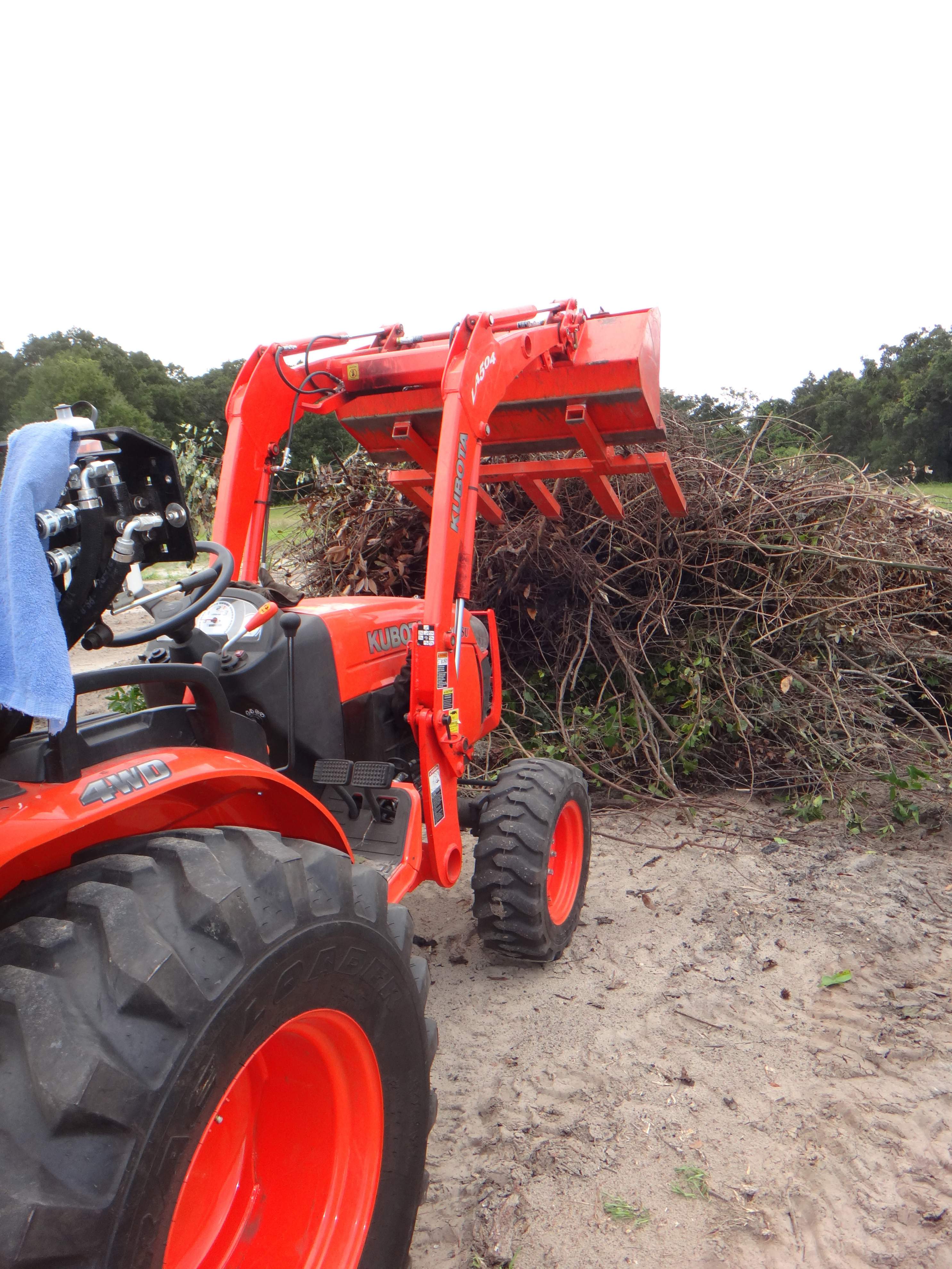

You will until you buy one! The grapple is probably my favorite attachment.
Here is my favorite woods weapon. Grapple on front and backhoe with thumb on back. My brother (in pic) and I were hinge cutting maple trees around my new food plot.
