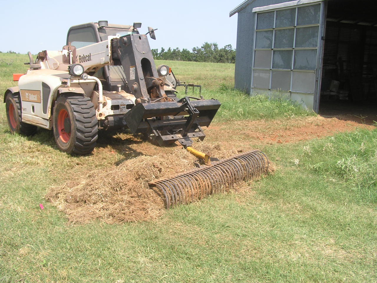

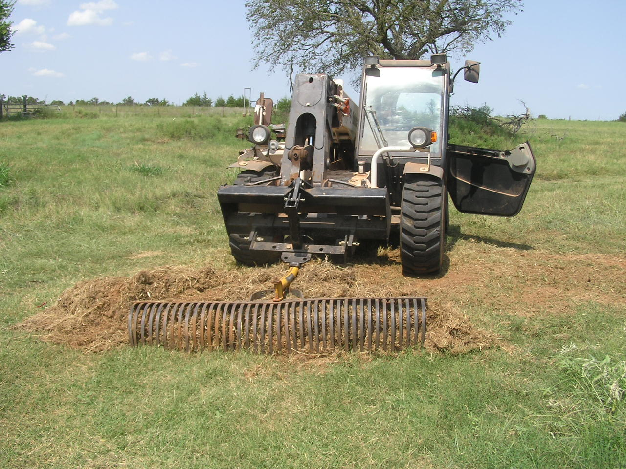

More pics to come as I make more progress and get into tougher stuff but it's working great for now and worlds faster with the rake in front where I can see what's going on.
Yep, out front is gooder :giggle: .
