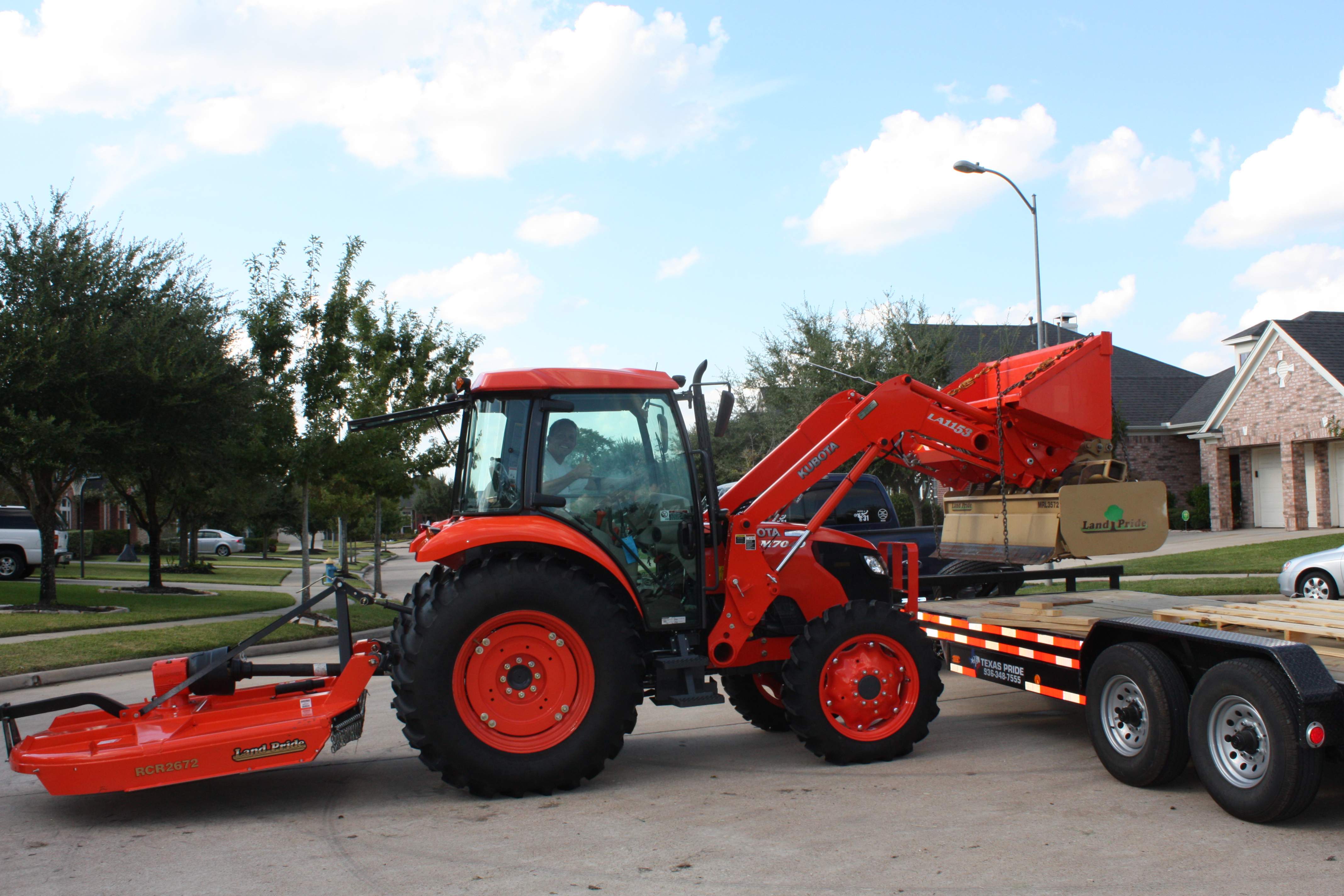

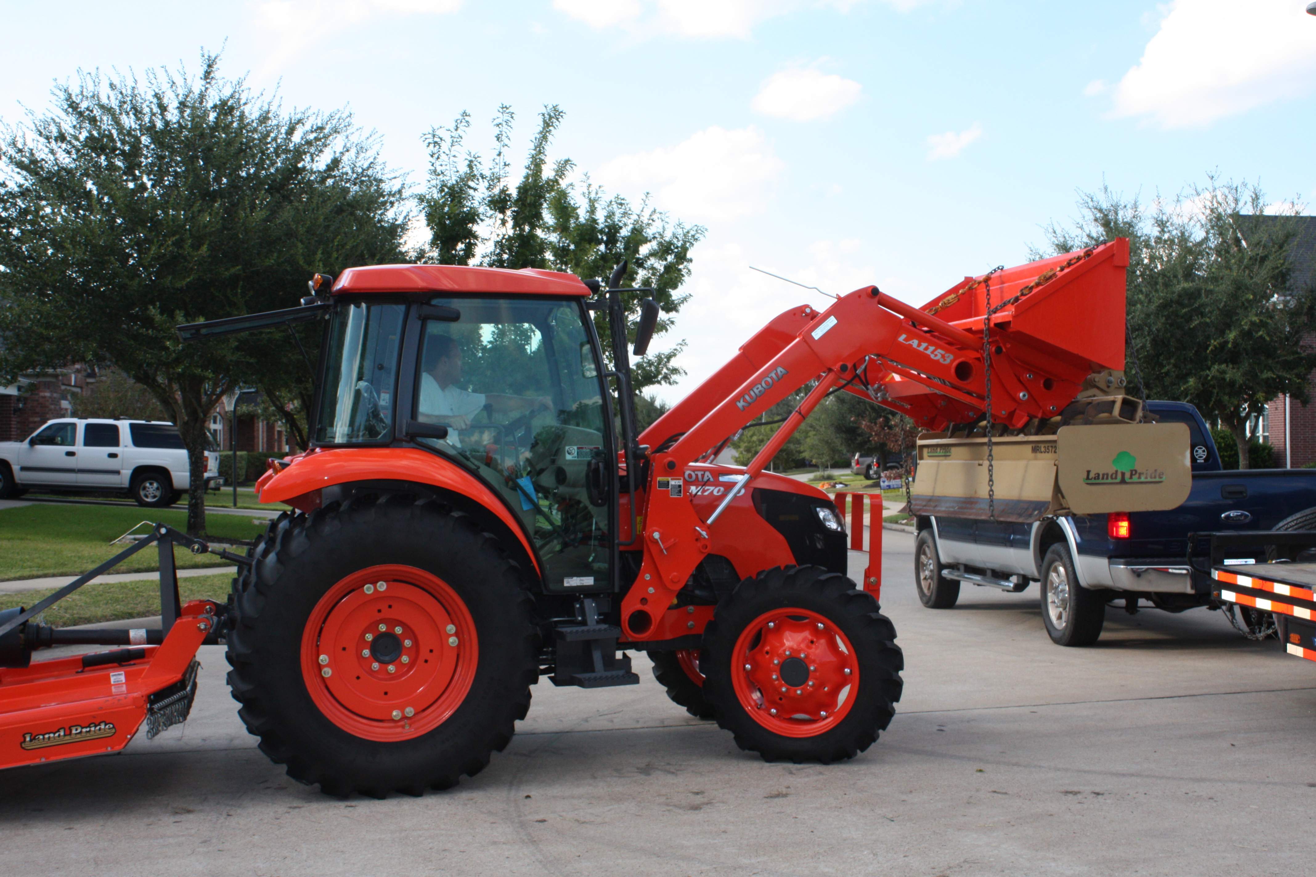

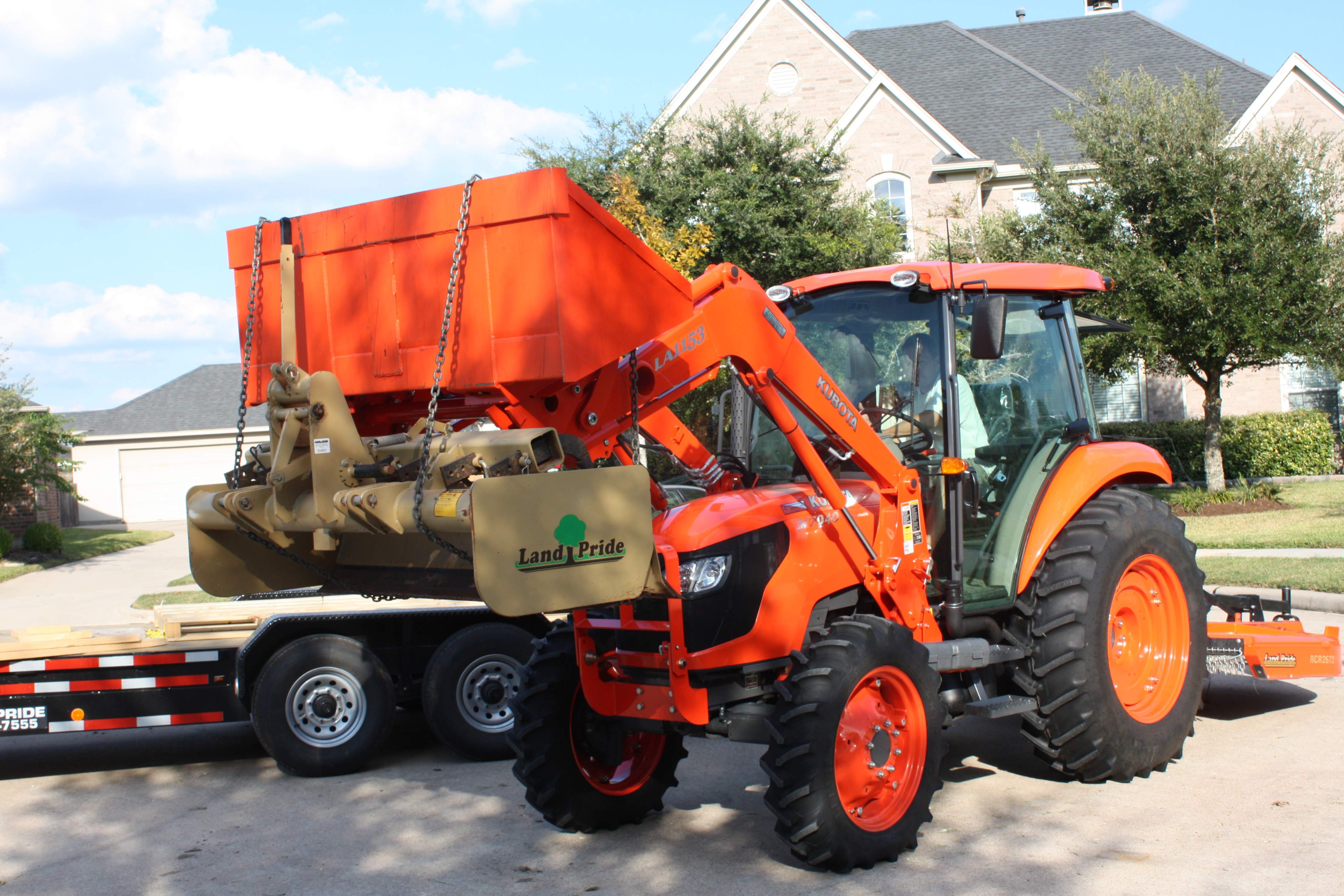

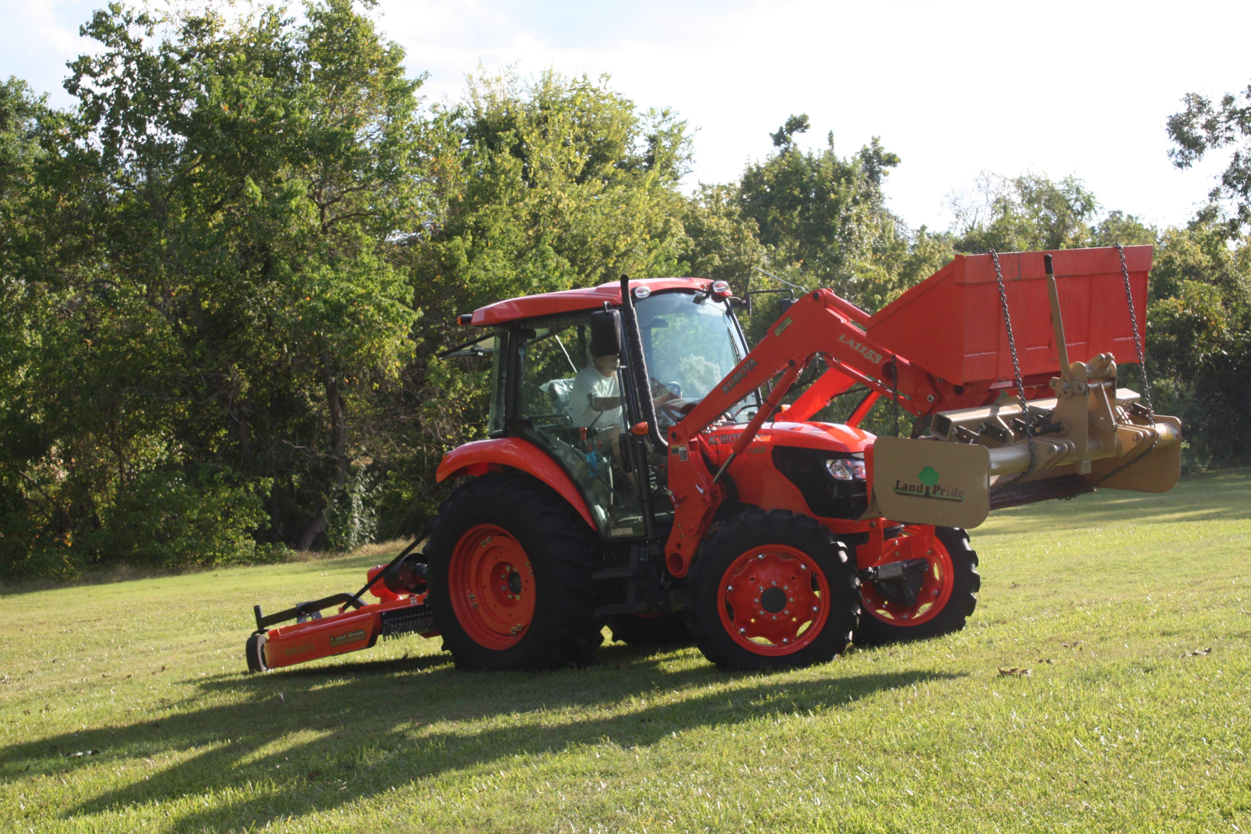

Why is this thread in the Kubota section anyway?
We just bought a Land Pride Box Scraper :D
I asked for advise in the attachment section - nobody replied - so I went with my gut feeling. :D

Very nice looking piece of equipment. I use a lighter duty LP on my L5030 and if I ever get one for our M8540, it will be one like that or the other model with hydraulic scarifiers. We use a wheeled 10' unit now and while it is great for some things, others not so much.
