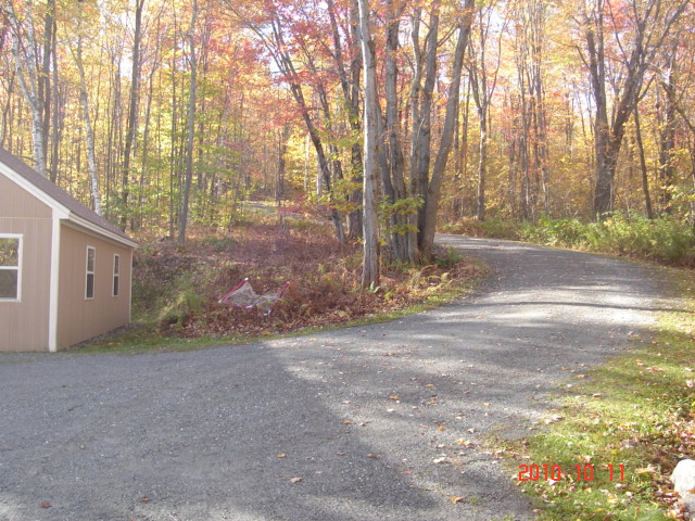

Thanks. I'm hoping it will be just about right for the job.
When I built the house 24 years ago, the driveway went WAY overbudget-- it's quite wet here, with underground flow, and even some springs upslope about a half mile.
Fortunately, the VT gentleman I hired to do the excavation convinced me not to skimp; for the 200' main part of the driveway, he had 360 tons of 5" stone brought in, topped by another 145 tons or so of what we call "crusher run." It was very sound advice, and I'm glad I listened to him.
It has held up admirably over the years, but does require work every so often to fill in the inevitable ruts that form due to water from heavy rains.
Here's what it looks like when not covered in snow or ice (like today....::mad::)

You should have no problems using the DR power grader on that driveway. However, if you wanted to dig down 4" and then smooth the surface I would say you need a grading scraper.

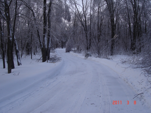

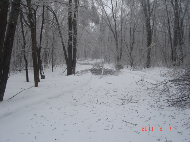

And yes, I'll be happy to report back on the DR (60"); might be a while, however-- got a lot lof trees to clean up after the last storm! Thinking it would be nice to be able to actually see the driveway surface again; this is what it looked like yesterday, and then this AM.

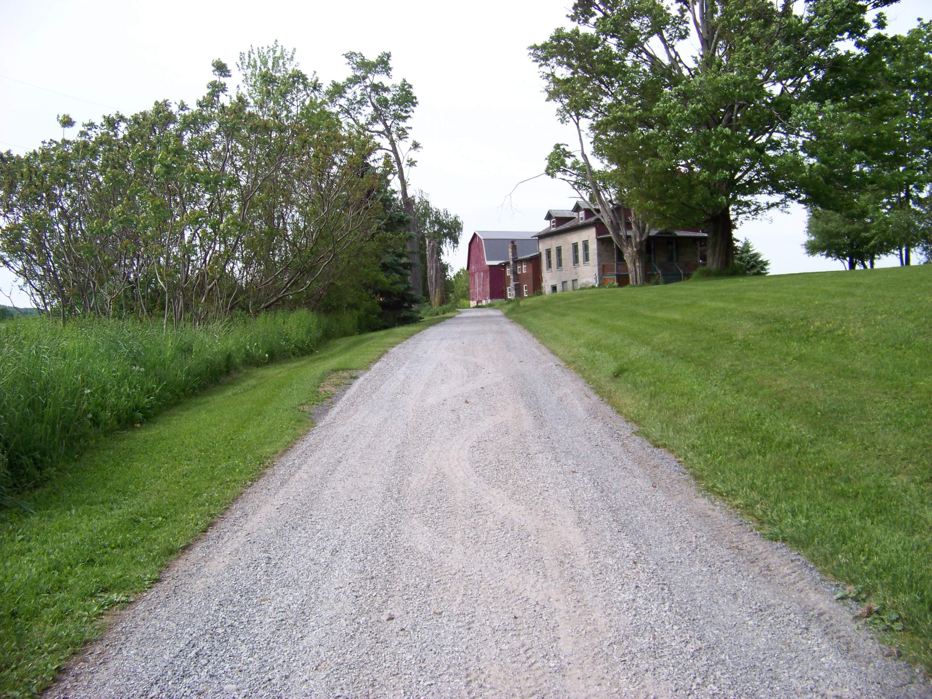

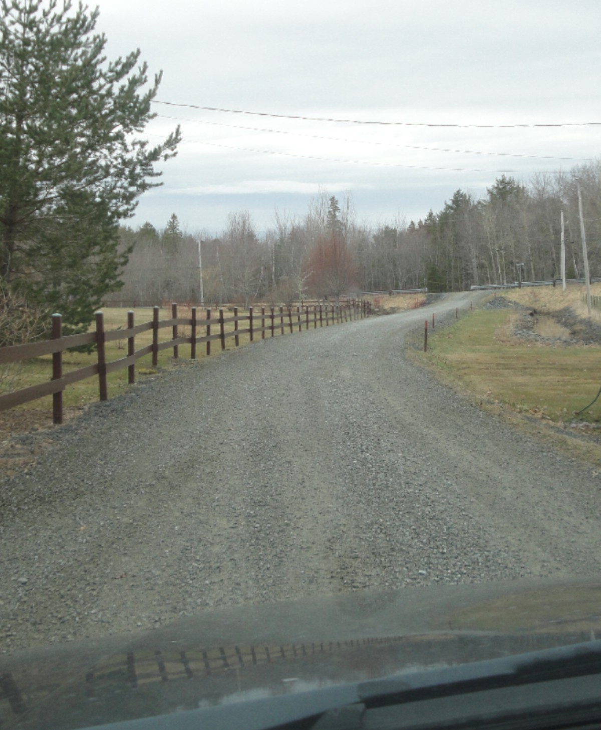

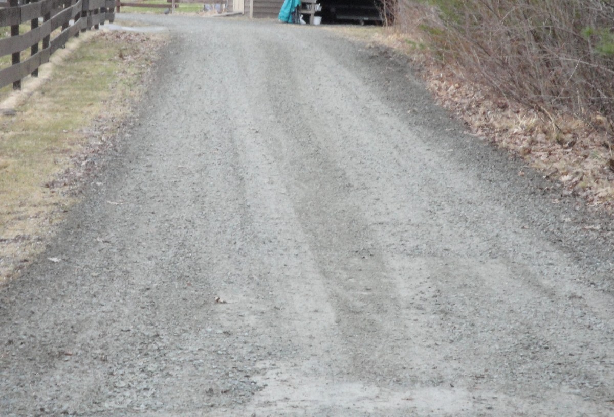

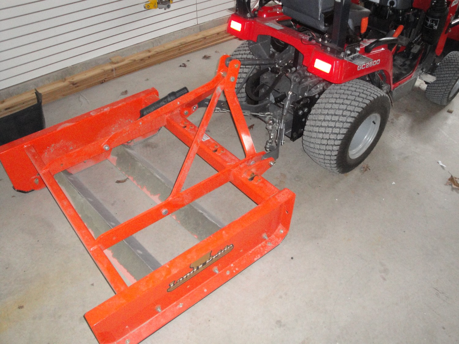

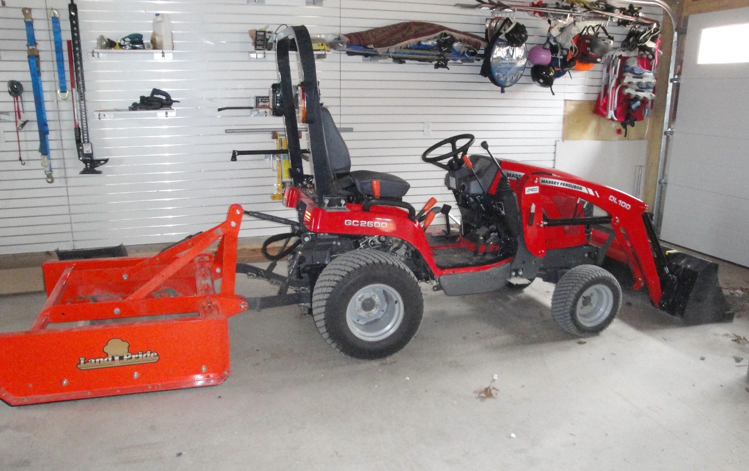

For a quick follow up, I picked up my GS1548 today and within 45 minutes after getting it home I had the road graded. Whatever apprehension I had with whether it would be worth the cost over just continuing to use my boxblade and the question of what size to get have all been erased or should I say obliterated. What a wonderful tool for grading these scrapers are, with no more than the dealers setup which set both scrapers approx 3/4 inch below grade the grader worked far better than I expected and has exceeded all expectations. I managed to finish the driveway, without using scarifiers, in about a third the time it takes with the boxblade and the end result is remarkably better (excellent mix of fines and course stone).
Regarding the size question of whether to get the 48" or 60" scraper I'm glad I listened to those here who convinced me to to go with the smaller unit. The pull on the tractor is a little more than I was anticipating with the grader loaded up. It's no problem at all in low range but more speed is definitely your friend with this grader than low range can muster. Operating the GC2600 in high range at 2500rpm is just about a perfect match of gearing and power, if I went with the 5 foot model I'm sure there'd be some bogging at times. The 48" model feels just right with the GC2600.
The only thing that has attempted to take the shine of this purchase is the dealer ordered it in orange not yellow and the scarifiers did not accompany the shipment. Despite the implement being this rather nauseating and putrid orange color to say I'm pleased with this purchase would be a slight understatement. :thumbsup::thumbsup: I thought my boxblade did a great job, and it did, but this grader/scraper is definitely the correct and better tool for the job.
Here's a couple photos of the grader and a couple snippets of the final product.

You have become another believer, no longer a doubter. :thumbsup: These grader blades are simply unbelievable with how well they work. ALL of them, big, small, heavy, light they all seem to work very well. It seems like unless you have used or seen in person how well that they work, people just do not believe how well that they do indeed work.
I have not come across one single person here on TBN that has one of these grader blades that is not happy with it and yet when someone asks about them, there is always someone that is against them for one reason or another. Those of us that have them know better. Sorry about the paint job. You could always repaint it, that's what I did. ;)
/ Land Pride grading scraper #139
Thanks for reporting back. Glad you are happy :thumbsup: and got the size that was right for you. Seeing a picture of your tractor it looks to me like you made the right choice. As Brian said, everyone who has one new you would be happy. Have fun.
/ Land Pride grading scraper #140
Much of my apprehension purchasing this grader was due to watching the two videos floating around on youtube of the unit in action. Imo, both the Kubota dealer vid and the Everything Attachments vid both portray the grader in a rather unimpressive light. In both videos it appears to me that it would take an unusually long time to grade a road using this grader when, at least in my circumstances, nothing could be further from the truth. Perhaps it's just me but when both the blades load up with cascading gravel it's symphonic.
