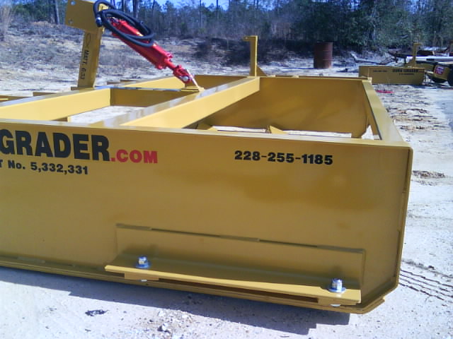

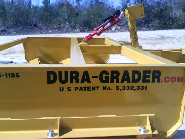

I own a model 700 Adj Dura-Grader and it works very well. From what I have found is that the people who manufacture the dura-grader model developed and patented these types of graders and have been building them for 30 plus years. The unit I own is adjustable. The cutting edge assemblies can be adjusted from an angled position for crowning and grading my roads to a straight position for spreading material and leveling without moving the material to one side of the unit. I have adjusted it into five different positions to due different types of jobs and have come to realize that I would have had to purchase four or five other name brand graders with the angles in the different positions to take the place of this one unit. Also the unit I purchased has a hydraulic top hitch which allows me to adjust the cutting pressure from the rear cutting edge to the front or vise versa while in motion. I am very pleased with this grader and would recommend it to anyone who is in the market for a grading implement. I looked at the land pride I just don't see any reason I would use scarifying teeth to rip up my road. It just seems like it would tear up the top pan of my road and leave streaks in the road which would most likely promote erosion when it rains. That's just my opinion wwww.dura-grader.com is the website where I bought my grader

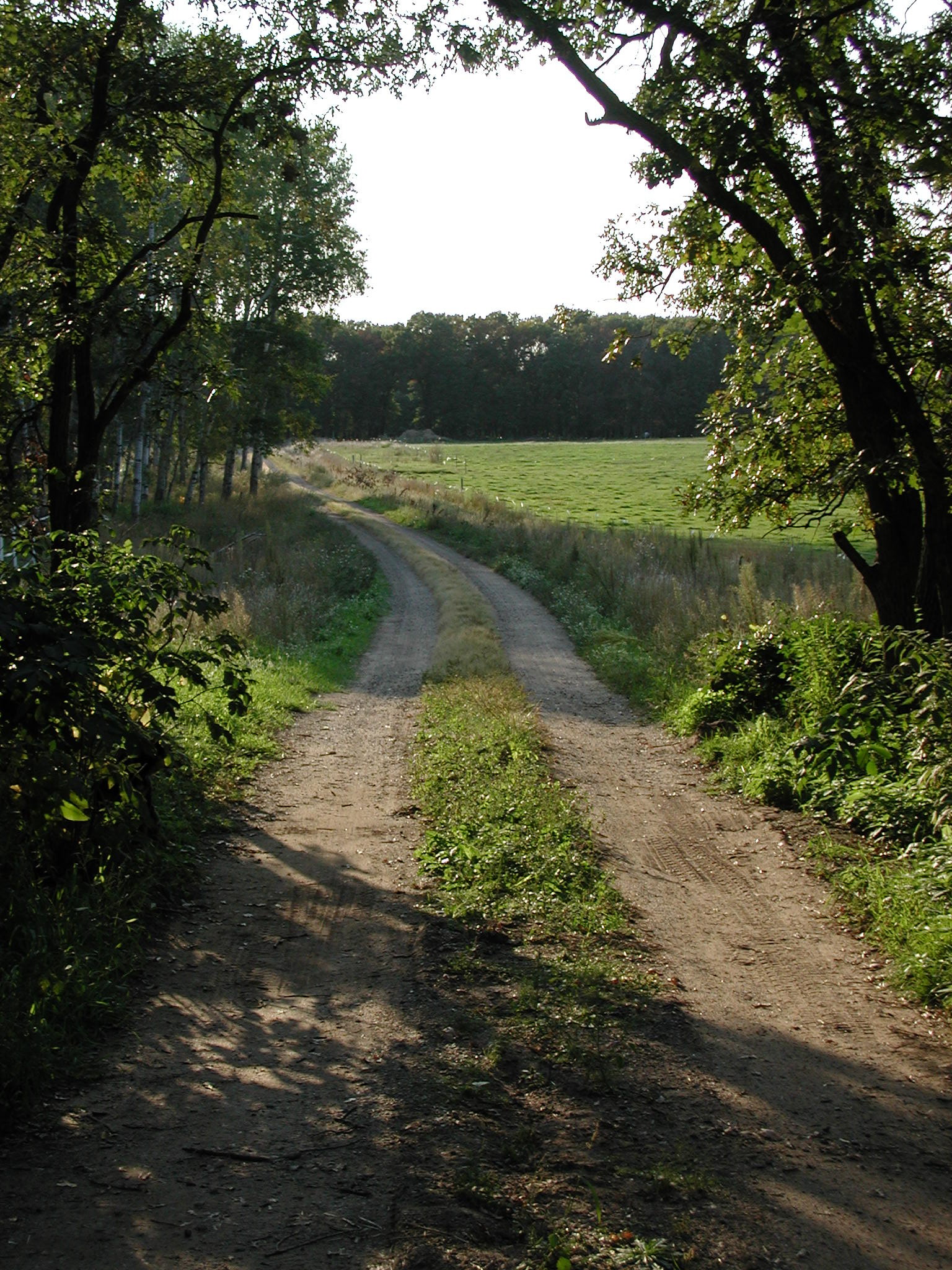

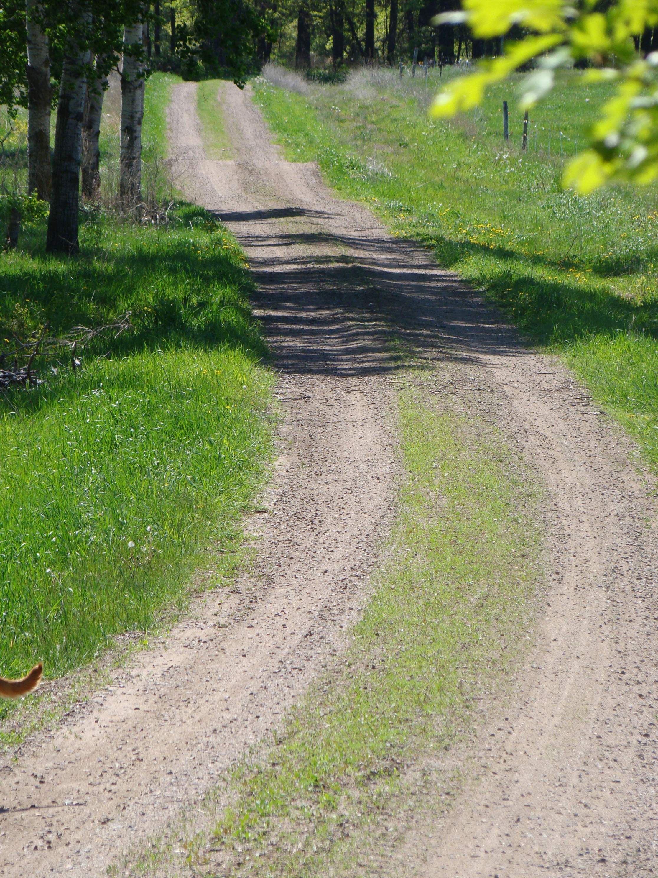

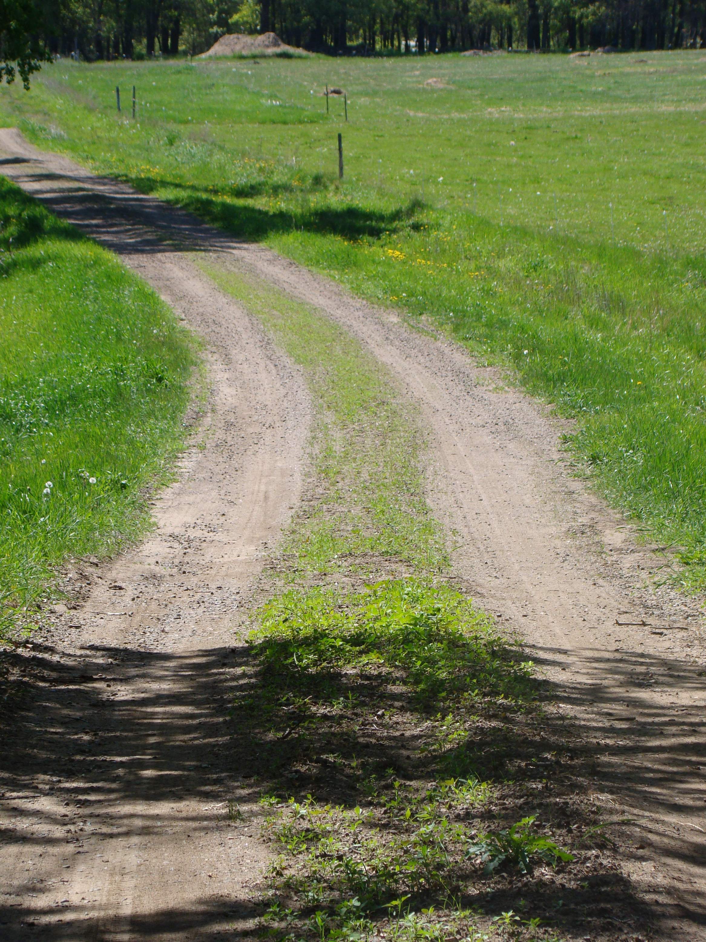

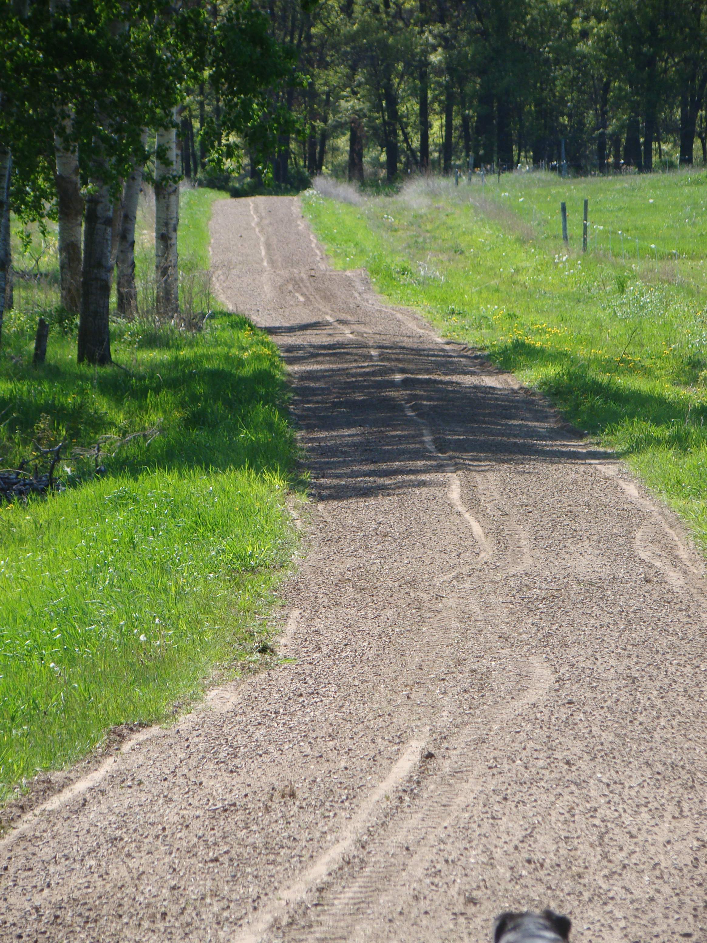

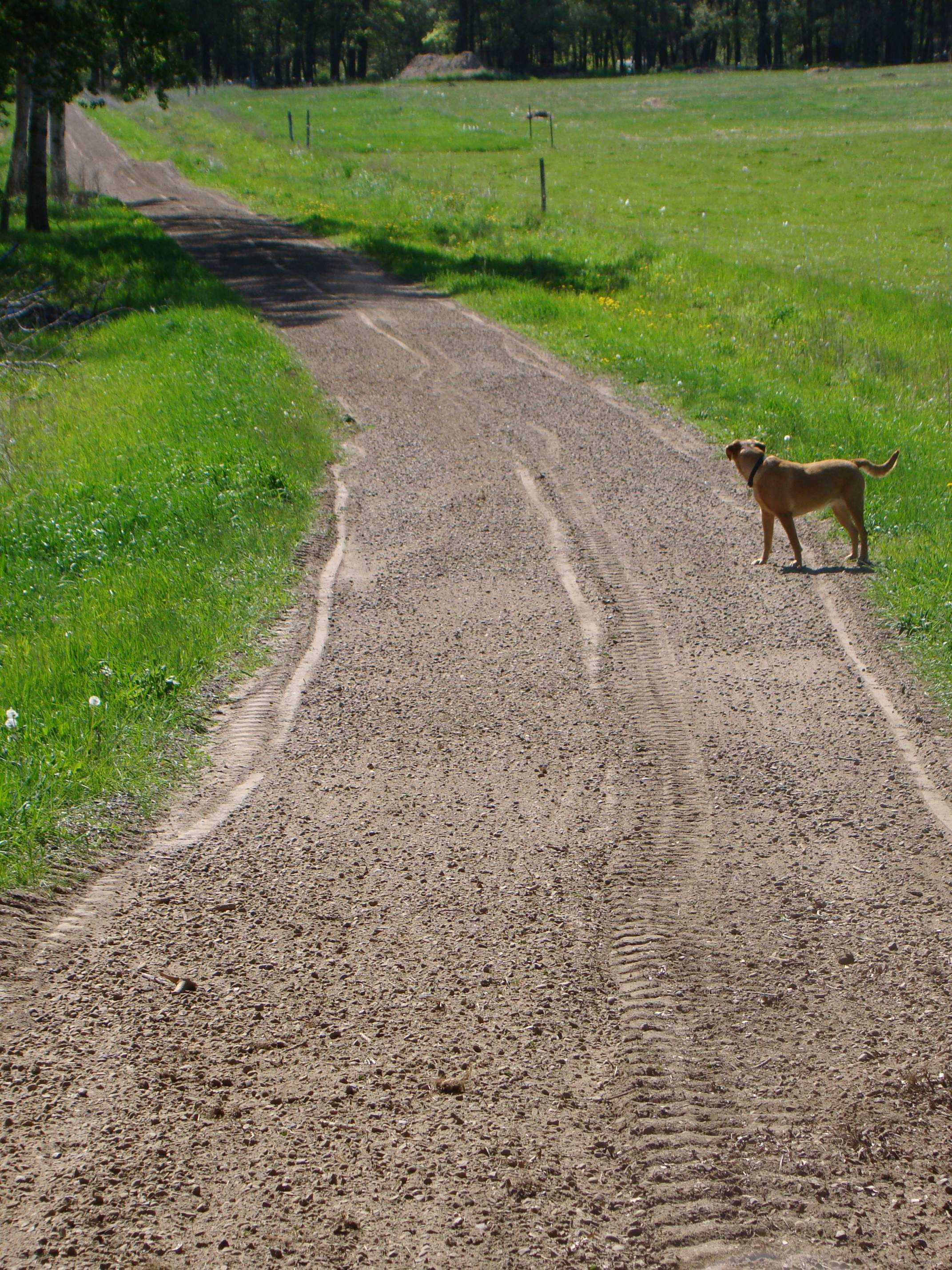

My drive was begining to get a little growth in the middle again and the tire tracks were starting to make ruts. One pass down and back and its in perfect shape again and looks freshly graveled. It has been dry for well over a week. The material does flow much better from right to left when it is dry to maintain the crown. If the material was dry and you made some blade adjustments it probably would not be to tough to create a crown if the road was flat. It would probably take a few passes though. Each time I use my LP grader blade I am more happy with the purchase. I only use the scarifiers to tear up heavy vegitation or get to the bottom of deep pot holes. Otherwise I flip them upside down to keep them out of the way. Here are a couple before and after photos of the work I did yesterday. Once down the drive and then back. Super easy. For those of you who like seat time this may not be a good thing. ;)

I might be out of the norm, but I'd rather have the 'before' driveway. :cool:

mlevendo, don't know if you have this problem or not, I see a little in your pics, but sometimes I end up going back over the center because of a lot of material being left there. Anyway, I do it going backwards and the twin blades make it smooth out just about perfect. ;)
Just a tip that works good for me, may or may not work for you. Your road looks good by the way.:cool: I sure wish that I had grass next to my roads.:(

To each their own Willl. The center grass makes it more of a pain when it comes to snow removal so I like mine grass free.
MntView - I found I get more of the center buildup when material flows over the rear blade too. It also does not spread as evenly when it goes over the rear blade. I have my back blade set all the way up so it does not dig into the gravel (flush with skids). The front blade is set about a quarter inch or so below the skids. I then adjust the top link so it raises the rear of the grader so the rear blade is about a half an inch or so off the ground. The material then flows over the front blade and the rear blade smoothes it out if it become excessive. I don't have too much of a problem with excess buildup in the center of the drive. I do have the driveway crowned down the middle. If you do a more aggressive dig and particularly with both blades you will get the chuncky build up.

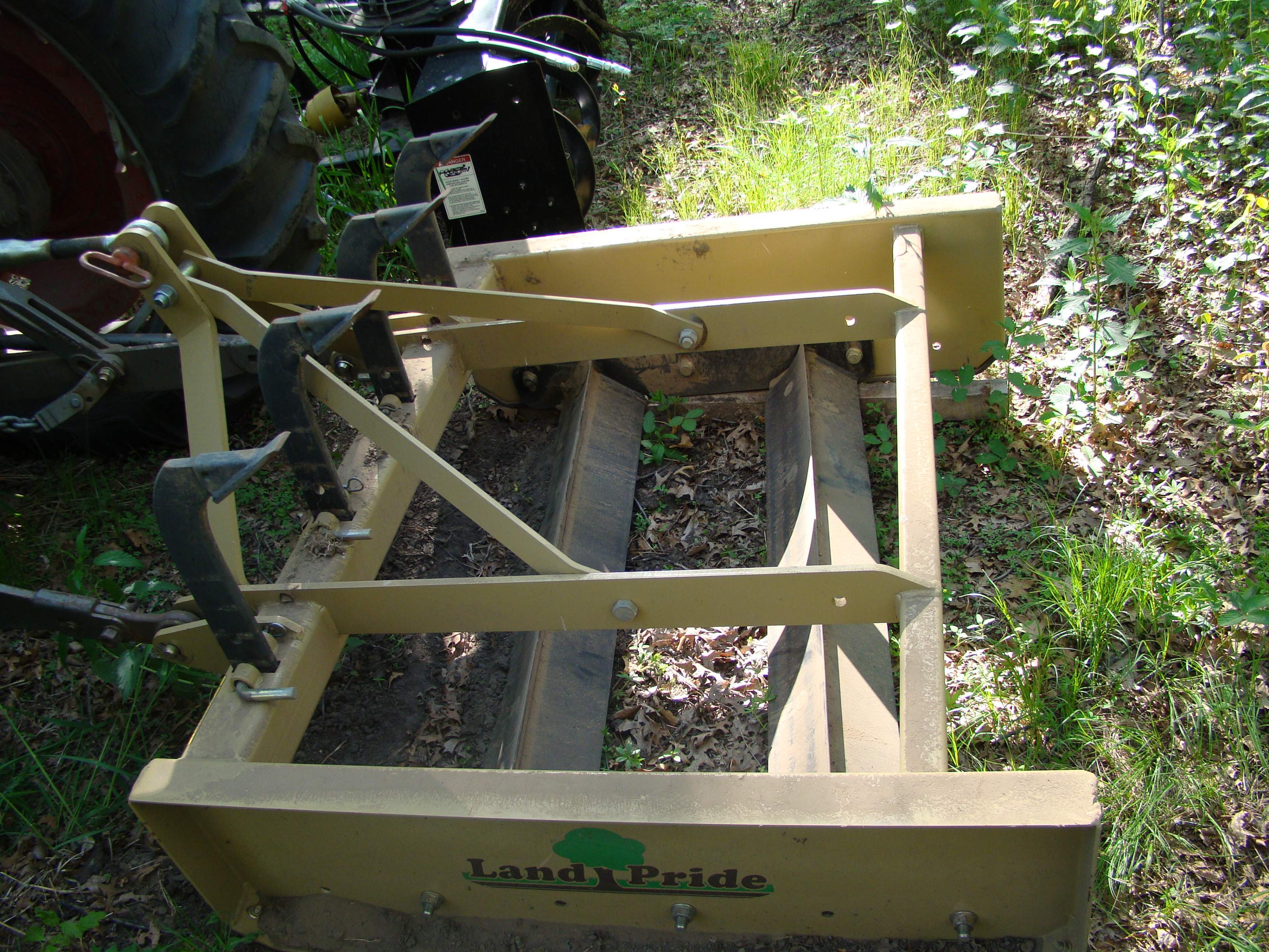

I attached a photo of how I posistion my shanks. I noticed at some times that they can hinder the material in front of the front blade even when set in the highest postion. I like to keep them completly out of the way when not needed.
