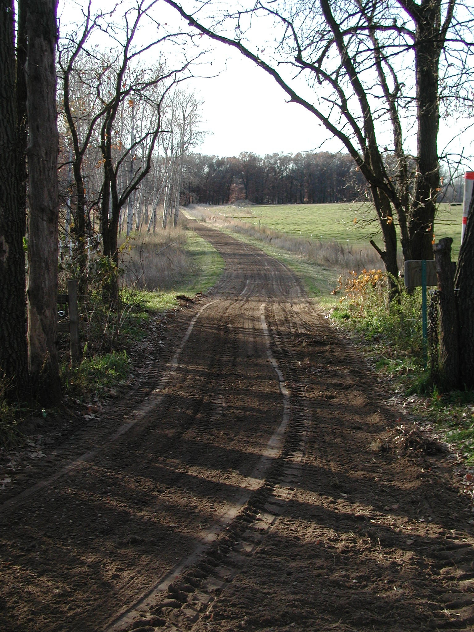

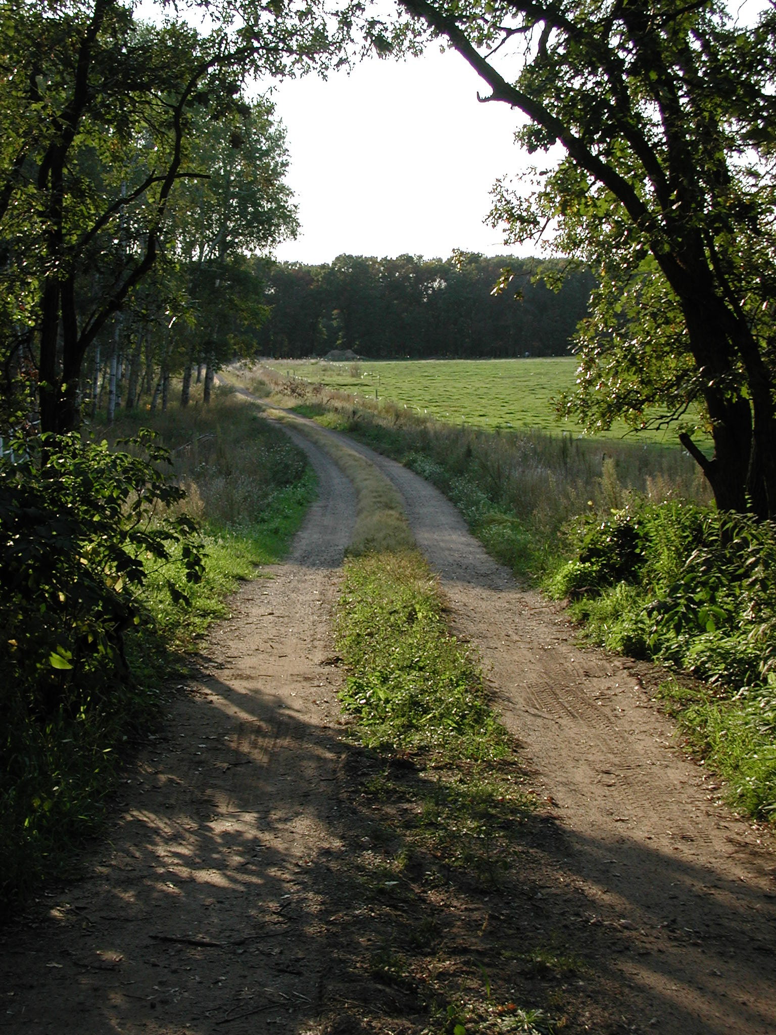

Here is pictures of before and after I removed the center weeds that grew up in the summer.
/ Land Pride grading scraper #23
Per Tom H's question:
Top 'n Tilt would not be needed for a grader scraper. This implement is ment to be dropped flat on the ground and dragged. My blades are adjustable from 1/8 an inch to 1.5 inches below the skids depending on how aggressive a bite you want to take. I have mine set to about 1/4". Due to the length (my 48" wide unit is 54" long) it does not follow the the pot holes and does a very good job of filling them and leveling it out. I set the top link once so the unit is flat on the ground when dropped down and that is it. Just drop it down and drive down the driveway to maintain it. Simple and very effective.

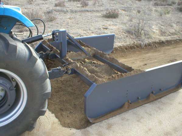

Below are a few pictures of a driveway that I did for a customer. My grader weighs about 1200 lbs. So cutting grass out of the center of a driveway is not a problem. Since building my grader, I've made several thousand dollars with it. I also use a hydraulic top link. That allows me to change the front cutting blade angle and how much it will scrap off the top of the driveway.
Before picture
After pictures
Another after picture
