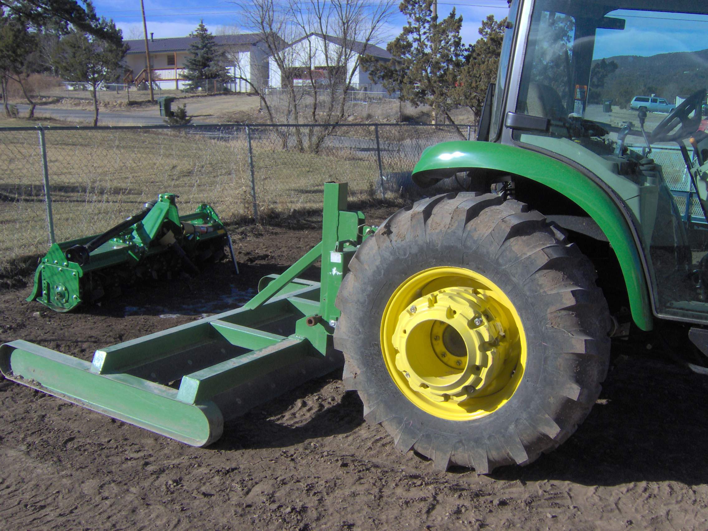

Here is a few pictures of my lpgs that is similar in size and with straight set blades. I think you will find that a hydraulic top link will be a great asset to have. I used mine to smooth over a new field area after laser grading today. I was running it with my Deere 4520 and pulled it at 3.4 mph in low range about 2400 rpm, pretty good pull.

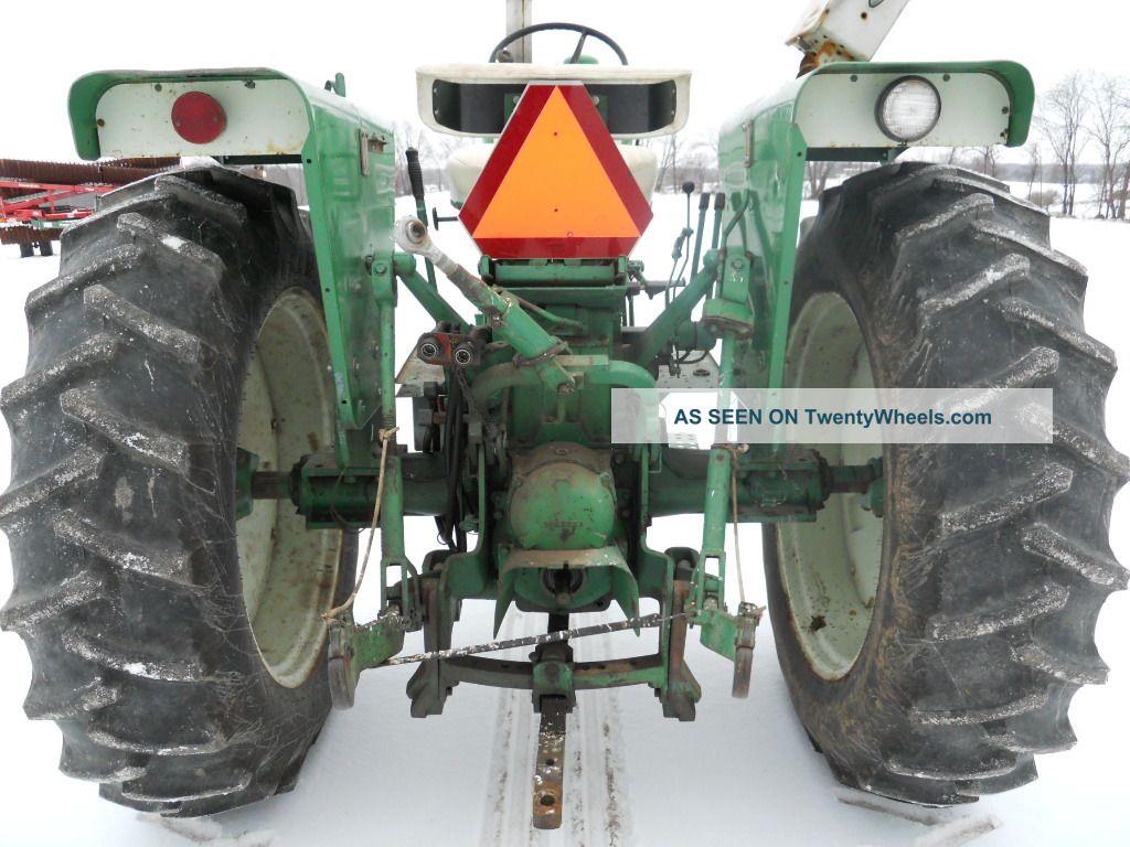

While I would love to have a hydraulic center link, the way my Oliver is setup with a yoke that the short link is fastened to, it is not an option. (Photo is one I found on internet.)

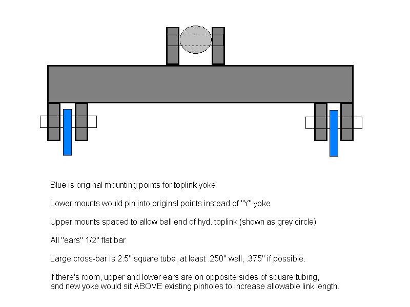

"While I would love to have a hydraulic center link, the way my Oliver is setup with a yoke that the short link is fastened to, it is not an option."
Maybe not true - It might just depend on how bad you want it. You obviously have a welder and know how to use it, see if this idea makes any sense - OliverToplinkMod.JPG
Just a thought... Steve
Actually it is, you just need to talk to the right company. ;)
   / Land Plane - Yet another build #26
I agree, I don't think it would be a problem for Brian to get you set up. As long as you have the hydraulics you need the top link would be an easy fix.

Butkitcase, that is what I did so I could use a post hole digger. I'm just not willing to risk the housing for the pto clutch by having something connected which may go low enough to make contact. The cylinder I got off a fork lift to try is 4.5" bore & touched. I have looked at the "Fit rite" site before but they only show a single point attachment setup.
   / Land Plane - Yet another build #28
The reason Fit Rite shows a single point attachment is because that is what 99% of the people have. Contact Brian to get a custom mounting made I can vouch for his being very reasonable and good to deal with.

My drawing is a REAR view - everything added would sit ABOVE the existing ears to AVOID interference, but a 4" cyl. is a bit large for this :D - My advice is free, and worth at least TWICE that :rolleyes: ...Steve
