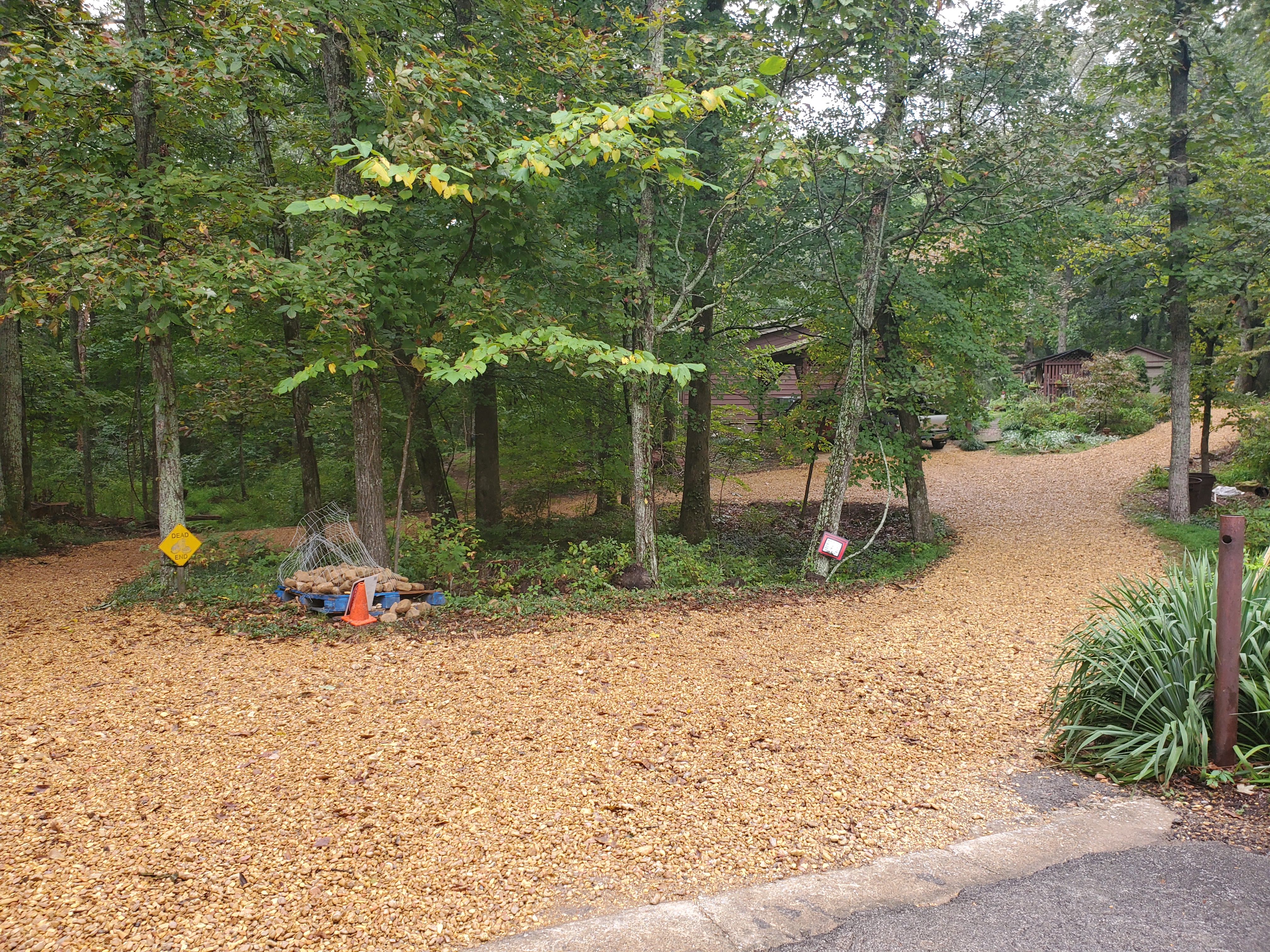

I have an extensive graveled parking area plus drive. I've recently had the entire area re-graveled. There is one slope connecting the parking area and the drive. My contractors advised purchasing a grader-scraper for the gravel, which tends to migrate downhill/downstream over time. The little Ford supposedly develops around 13 HP. I'm looking at the Land Plane, now owned by John Deere, I think, and the Land Pride scraper-grader now owned by Kubota. The Land Plane is available only in 5'. The Land Pride has a 4' model, which is something like 430 lb+. The 5' Land Plane is around 70-80 lb heavier. The Land Pride is about $300 more, as priced around here. The 5' Land Plane requires a minimum of 18 HP. The 4' Land Pride says 20 HP minimum. My landscaping contractor says that the Ford will handle either easily, just moving gravel. Any experience out there?

Thanks. That's helpful. My tractor isn't fitted with the front end, so I have to use the 3 pt. At 881, it sounds like the 70-80 lb lighter of the 48" Land Pride (Kubota) may be really important. It's just not the steel; it's the extra gravel the 5' would pick up. Here are some pix of my back parking area and drive to give an idea of the job... 20190914_122854[1].jpg20190914_123123[1].jpg

The gravel in the pictures looks almost like clean stone and what people around here would use for landscaping / mulch. Doesn't appear to have "fines" mixed in to lock it in place. If that's the case, you'll have plenty of seat time with the LP. Sorta like driving on marbles.

That's very acute. It's actually the second application. The first had to be scraped up and hauled off. Through a truck driver's mixup (or a bait and switch), the first load didn't match what the contractor had picked up at the yard. It had to be hauled from around 50 miles away. Rather than the fine gravel ordered, the rocks ranged from 3" to 7". It was impossible even to walk on. Fortunately, the contractor was able to donate it to a city museum at the other end of the mountain I live on - for mulch. Now there are two sizes of the replacement load. The smaller stones have settled down nicely. When you pick up a handful, they are quite angular, not rounded at all, and they've locked down well. It's hard to show in pix, but there's a slope where our back parking area joins our circle drive. Larger stone went there because the pea gravel we had originally washed badly. There was some left over and I consented to have it placed atop the smaller gravel, not only on the slope, where it was planned, but out where street dead-ends at our drive. The larger stone, as you say, has not settled down at all, and it is indeed like driving like marbles. Right now, we're discussing having them come back, scrape it up (again!) and place it on the drive we have in the front of the house, not pictured. In our area, there are only two types of stone easily available - river stone and crushed limestone, which is not very attractive, but effective. We lived for a time over in NC, where they use crushed granite. They had something they called "mill run," which I suspect is similar to what you're describing. It eventually packed down to almost an asphalt-like state. Sorry for the length but this has been a long, painful project and your comment picked at a sore...

Thanks. At this point, my main worry is the slope for the reasons Chim set out above. Last evening, my wife and I went out to the symphony and, when we exited the drive, where the large stone is laid down on the small, and deep at that, I noticed her AWD Subaru fishtailed a bit. I think I'll first load the tractor down good - I have some really heavy locust logs which need to be transported up to my shop apron, where the splitter is - and make sure it can negotiate the slope...
