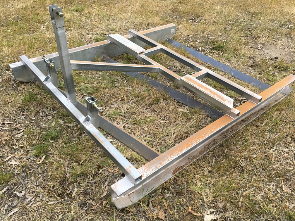

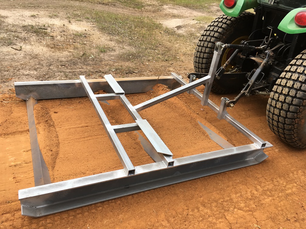

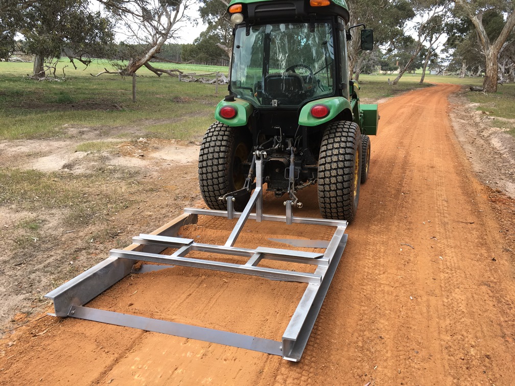

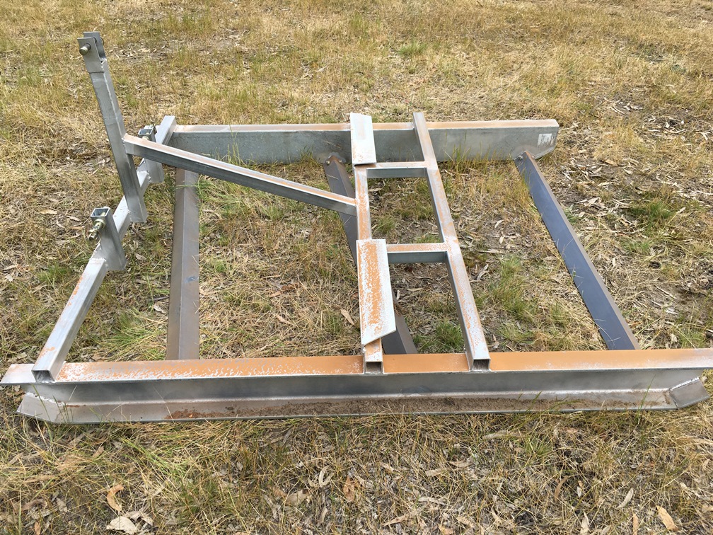

So, I've built my new plane. Some info and pictures, to show either what to do :thumbsup: or what not to do! :thumbdown: depending on your point of view :D
It's 1,625mm wide overall and 1,800mm long (plus the upturned ends). The skids are bulit from 2 metre lengths of 180x75mm galvanised PFC. The tube frame is 50x4mm galvanised SHS. The blades are 75x6mm mild steel angle, set at a 10 degree angle for the first two. I was going to use stainless angle, but it was going to be three times the price. The blades are bolted to angle iron carriers, so they can be mounted either on top of the carriers (as per currently, where the blades do not protrude below the skids) or underneath the carriers, giving just under 20mm of protrusion below the skids.
Total weight is 163kg. It was built for my 3720, but my X495 just manages it too.
/ Land plane dimensions #6
Looks very nice. Good job. ^^^
/ Land plane dimensions #7
How did you galvanize it? Or was the raw material galvanized before you got it? Know it can be very unhealthy to weld.
It was galv stock. Oh yeah, smokes and spit 'n sparks and carries on when you weld it. The tube is OK, but the PFC is awful, even after grinding it back a bit.

I think the longer you make the plane the better, if your intention is to grade the flattest you can. The features I find valuable are:
* An adequate supporting surface to stop the blade sinking too far in soft soil. I used PFC in my last build to help spread the weight of the plane and on my first build I added angle iron 'wings' to the tube frame to help support the plane. Too little support and the plane can fill up like a box blade, requiring constant input to the height of the plane to get a smooth surface. I have built three planes over the years, all with three 'blades', so I don't know if the above is an issue with single-blade planes. Perhaps others can offer their experience.
* Angled leading and trailing edges to prevent digging in. Having angled edges on both ends allows the plane to be pushed or pulled and glide over an unexpected root. I promptly busted the first plane I built as I snagged on a root just below the surface.

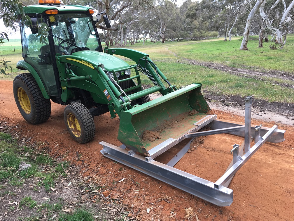

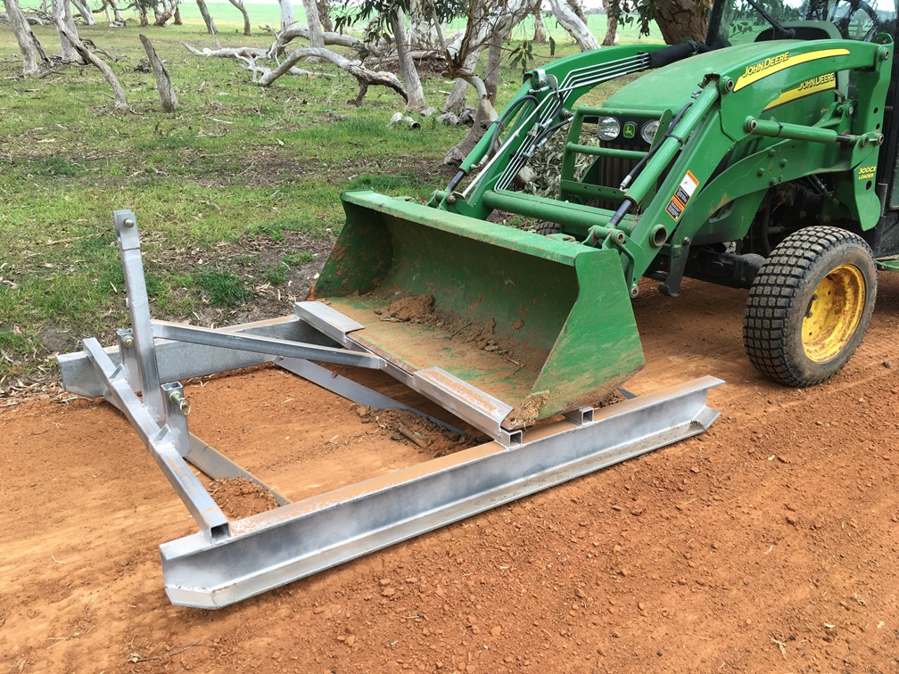

* A frame to enable the plane to be maneuvered with the FEL bucket. This allows you to quickly do a small job without having to change 3-point implements. It's also useful to move the plane and transport it. Often I will drive the tractor to a job with the box blade on the rear and the plane on the bucket.
* The frame also allows you to add weight to the plane when needed. I find the weight of the plane alone is enough to use in soft soil, but extra weight is sometimes needed in the first couple of passes over a compacted driveway.
It looks like you have the last point covered in the photo you posted.
SSQA to 3pt adapter. I welded a Quick Hitch to a SSQA plate. Let's you easily carry any 3pt implement around for loading or transport. Made a 2nd after the first one ran off with my old tractor (was the mount for my snow plow).

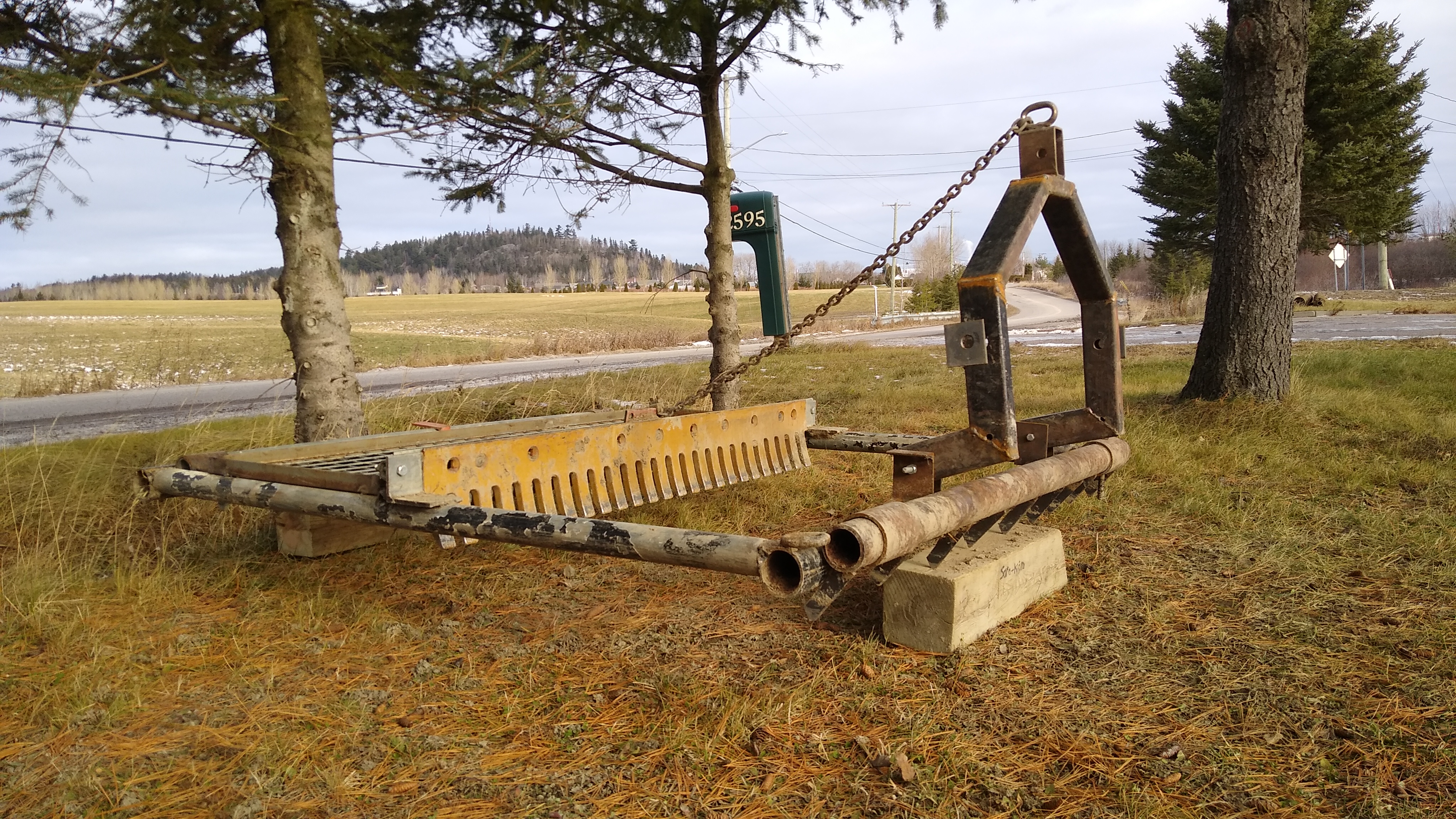

All of your implements need to be QH compatible though. But modifying them so they are is a good idea anyway. It does mean you can end up at a job with no bucket though.20200419_165207.jpg20201018_113017.jpgIMG_20150117_153806.jpgIMG_20150117_153833.jpgIMG_20150819_201451.jpg20201018_113008.jpg

I am in the process of scavaging the material to build one of these myself. My last and probably the hardest thing to make a decision on is what to build the side plates out of. The unit will be used for the most part on my gravel driveway which has several hills and valleys.
Do you guys think there is a significant advantage in the length say from going to 4 foot to 5 foot of should I consider 6 foot?
For the blades, I have 2 used cutting edges off of fairly large machines. The blades will be backed up by 4" x 1/4" angle. Does a third blade at the end work well?

i am planning to build one eventually as well and GS2572 is a good exemple of well designedLandshark Also. if i do i will use 1/4 or 3/8 side plane the heavier would be the better and 5 foot long at maximum to save the 3 point if it swing and turning also as most model available are 4' long approx. and i would build it with 2 blades only without scarifier Capture d’écran 2021-02-03 194648.jpg
