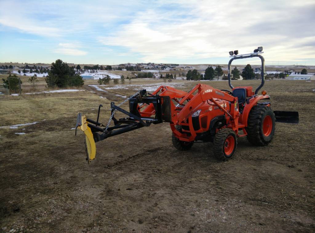

Good info, today was a long day of cutting and welding.
I have never used one so all info is good info. I have to remove my BH to attach the 3 Point lift arms so I do not use the 3 point very often. I found that my box blade works well for rough maintenance but the dressing is always done with my 72" bucket in the FEL.
One thing I have noticed in every video is that the rear blade's job is more of a "wiper" than a cutter.
A benefit of using the blades straight is you can cut/shave evenly across the width of the plane. If you tilt it forward to cut more aggressively it works better to have both ends of the blade the same distance from the leading edges of the skids. I recommend you building the whole thing with rigidity of the frame in mind. Heavy is ideal. Good grader blades are important, I use 6" x 5/8" x96" with center mounted plow bolts reversible edges. This works best mounted to 4"x4"x1/2" angle iron. When I built my 8' I had some 8" flat bar 5/8" thick and added two pieces of heavy angle top and bottom to help stiffen the blades up. You might also want to consider a pipe roller on the rear skid that can float up and down a few inches too.

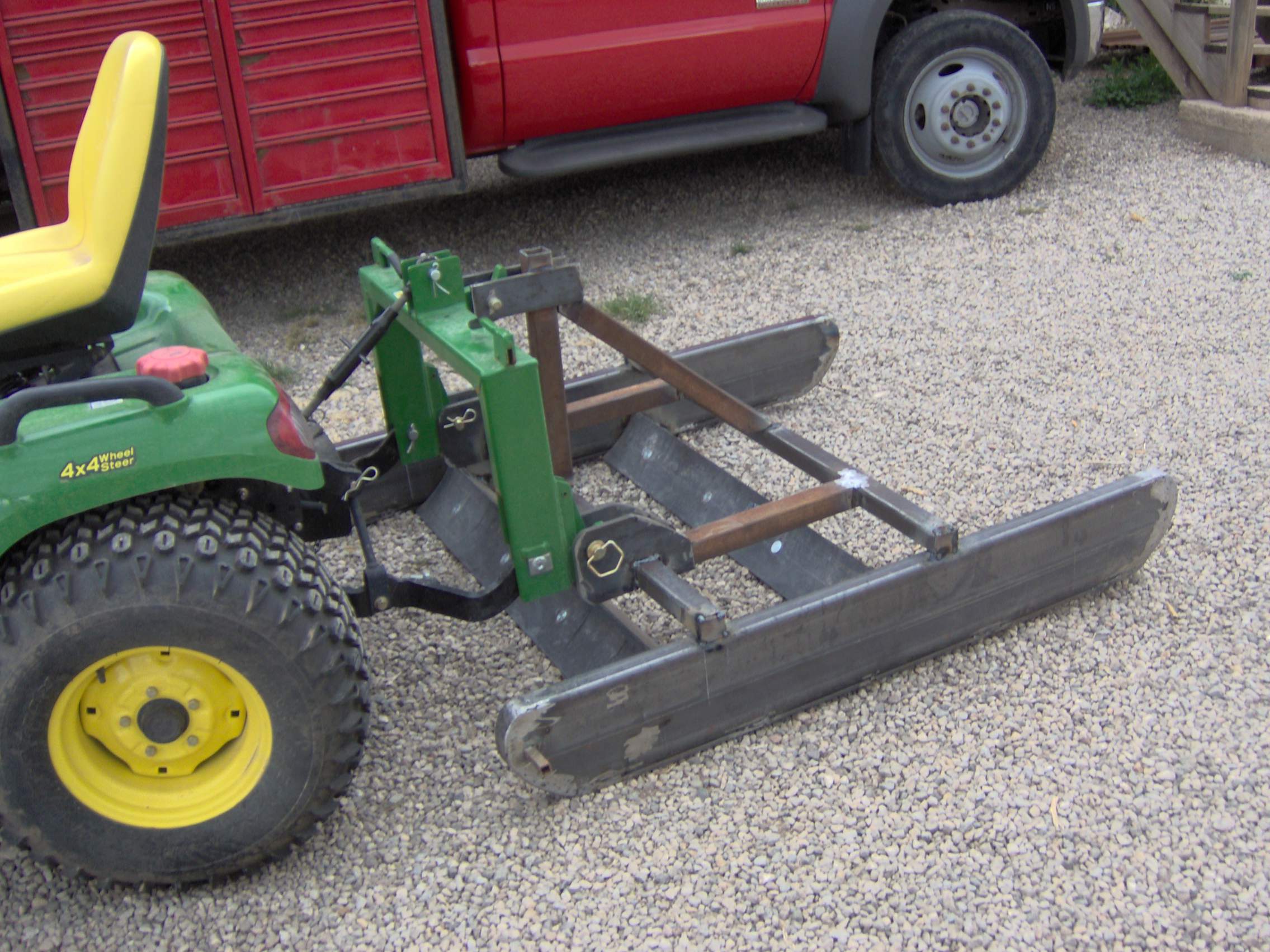

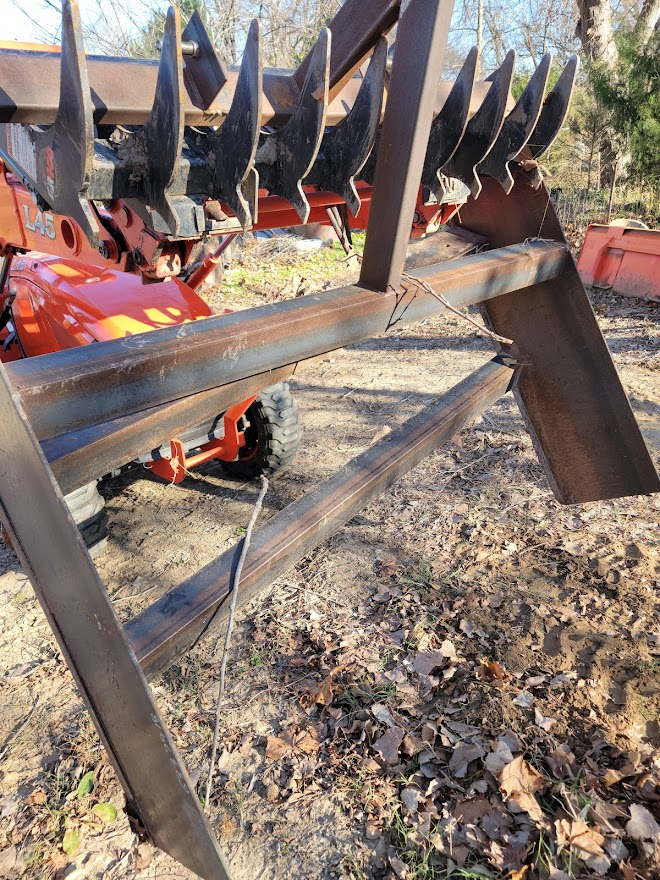

here is how it turned out, noticed today while taking the picture the welds on the cutting edge have broken loose in all but 2 spots. penetration was good but, you can see the holes where the weld penetrated the edge but they have still broken loose.
I am not sure if heating the edge with the torch first will help or not, maybe just bolt it onto the angle iron. I was also thinking of making a serrated edge to go in its place hmmmm.
