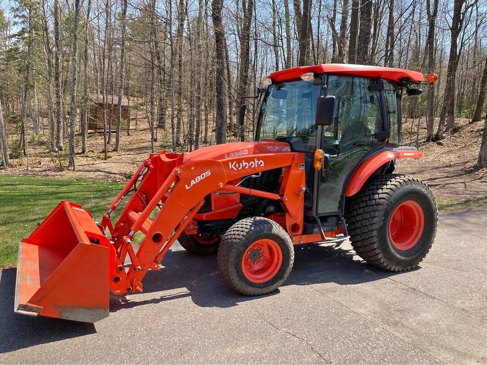

Got a Kubota L3560 come up for sale near us for $40,000. 2021 with hours with 72 inch HD bucketL4479, 6 foot front mount snowblower 3 rear hydraulic remotes. Filled turf rear tires, Heat/AC, Bluetooth radio etc, etc.
If you have one, hows it been for you? Looks like the BH92 Backhoe got on it. If you got one, please comment on its use.
If you have one, hows it been for you? Looks like the BH92 Backhoe got on it. If you got one, please comment on its use.View attachment 3474334
Seems high to me. A year ago I was quoted $33,300 for a new ROPS 3560 with 805 loader. What does the cab add $8000? So that would put a new one at around $41,000. Not sure what a used snow blower and 3 remotes is worth. But it seems their asking price is awful close to new price. I would think a new one with 0% financing may actually be cheaper.

My cabbed l4060 was valued at the mid 30s by the dealer a year ago. A blower & a backhoe are $8k each. Not clear if a hoe was part of the deal. My l4060 is a little short on hp for serious production work, but does me fine for a side gig. At my Colorado altitude I probably have less hp than a 3560 at sea level.

And what is kubota using for bucket quick connection system? Looking on Google, I'll I see is the commonly used system. SSA?
/ L5740 or some tractor #5
SSQA Fyi. Kubota uses a 2 camlock attachmet that will engage with any (not Euro style) quick attach. While I prefer the more rubust ATI attachment fixture, I happen to have them both, the OEM Kubota unit on one tractor and the ATI on the other.

Arly I went on Kubota and did a “build” on that tractor, it was about $63,000. The snow blower alone is about $7k. That’s considered a Grand L and would be a nice rig.
Edit, if it has a backhoe I didn’t do that on Kubota’s build, that would add several thousand more.

How many hours Arly, I think that got left out in your OP. I went on Tractorhouse and looked at several. Unless it has a lot of hours that might be a great deal.

35 horsepower is a little small on a machine of that size, but not so much so it should be a problem. Outside of that, it's a low hour, cab, Grand L, it's a Cadillac of a tractor.

That's a nice machine. My L3700 has about the same HP and has never been short on power. Maybe the hydraulic system could be stronger but if anything is too heavy for it, I use the skidsteer.. 40k and you can use it for 5-6 years and get back most of your money
