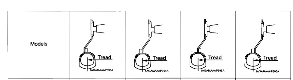

Consulted the L3130 owners manual and found a page describing tread adjustment (see attachment). For the 17.5L-24 industrial tires the data suggests an extra 4.4" of tread or 2.2" per side can be obtained by repositioning the hub disk/rim interface. I realize this data is for a 30 series tractor, but the 40 series shouldn't be all that different. Perhaps someone with a Grand L 40 can confirm.
Never paid any attention to this page before because the turf tires couldn't be adjusted.
Fat Tire, Agree it was weird they didn't know anything about it. One of them is consulting Kubota Technical tomorrow to find out.
Note: 4.4" based on 58.7" - 54.3" tread positions.

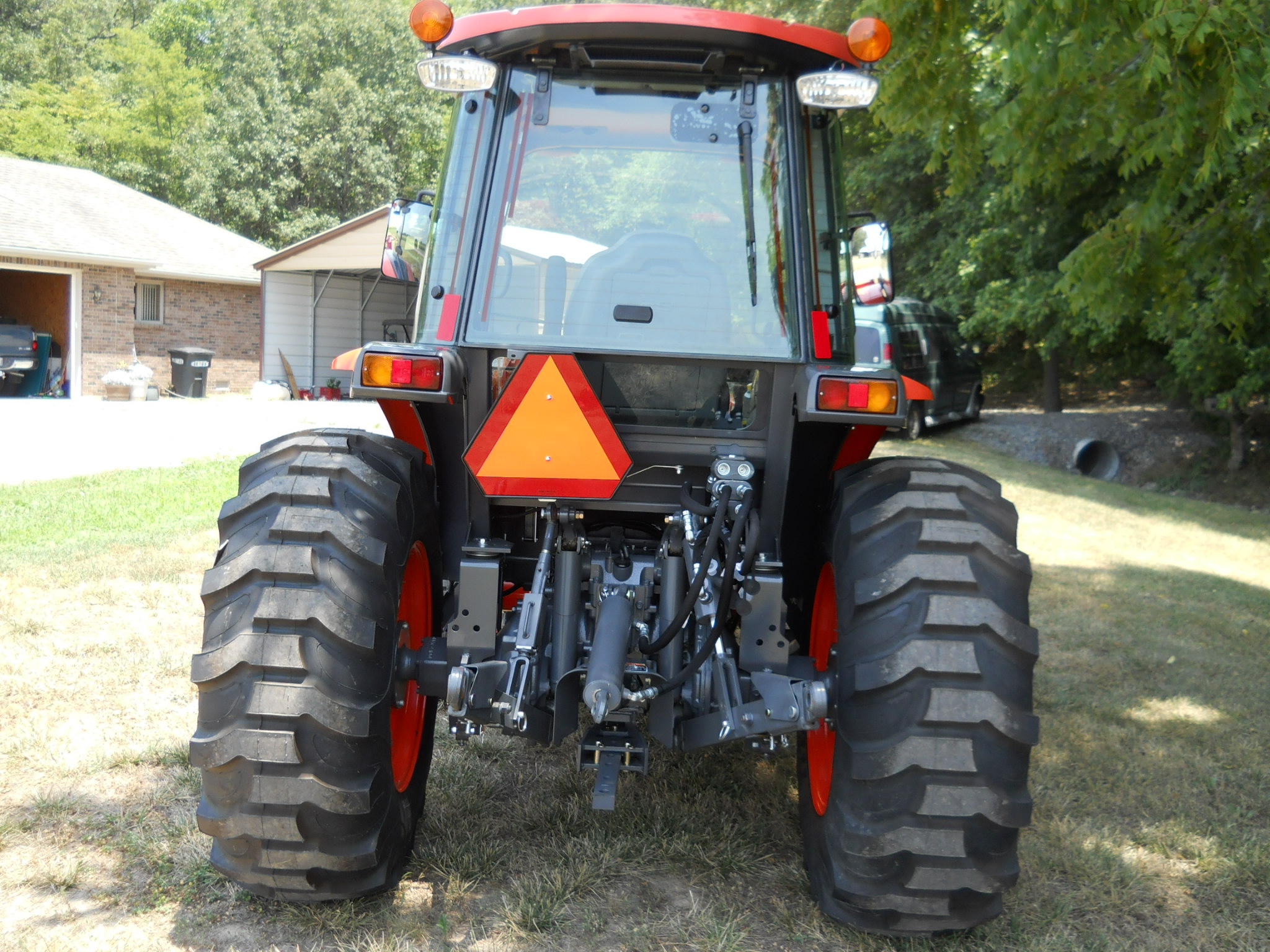

Thought I'd share what the dealer sales person relayed from Kubota Technical concerning repositioning 17L-24 R4's.
They claimed the tires/wheels are already at their widest position and can NOT be made wider. I've included a picture, so you can see first hand what they are "claiming" is the widest setting. I didn't say anything, as I believe others on this forum who present solid evidence their rims/hubs are repositioned for greater clearance.
Picture 1: Measurement of tire/inner fender clearance
Picture 2: Orientation of rim and hub disk. You'll have to zoom in to see the hub disk is positioned outside the rim.

That 2 (or 2 minus) inches you are showing looks like what the dealer sent me for my L5740. In a perfect world it would be enough, but in my world not quite. Funny, Kubota apparently has no idea about TripleR and dstig1's solution. Should have my 5740 by the end of next week, maybe in time to use during the multi-day storm forecast for the last few days of the month.

That ain't enough room for a rubber band. What happens if you put the tire on the other side of tractor, I need chains so I'd see how durables spacers are and how much $, should be cheaper then a AG tire set-up.

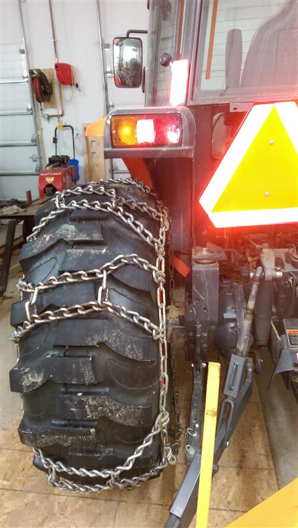

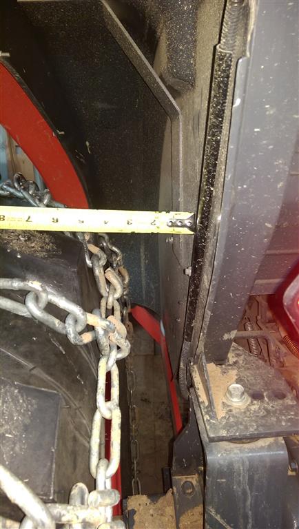

I finally remembered to get photos and measurements tonight. The tape measure isn't the easiest thing to see, but it was a little over 3" from the chains to the metal piece that protects the wire running down the inside of the fender. That would be the closest point where a chain could contact, as best I could tell. I didn't take photos of the wheel/hub setting as it is exactly the same as TripleR's

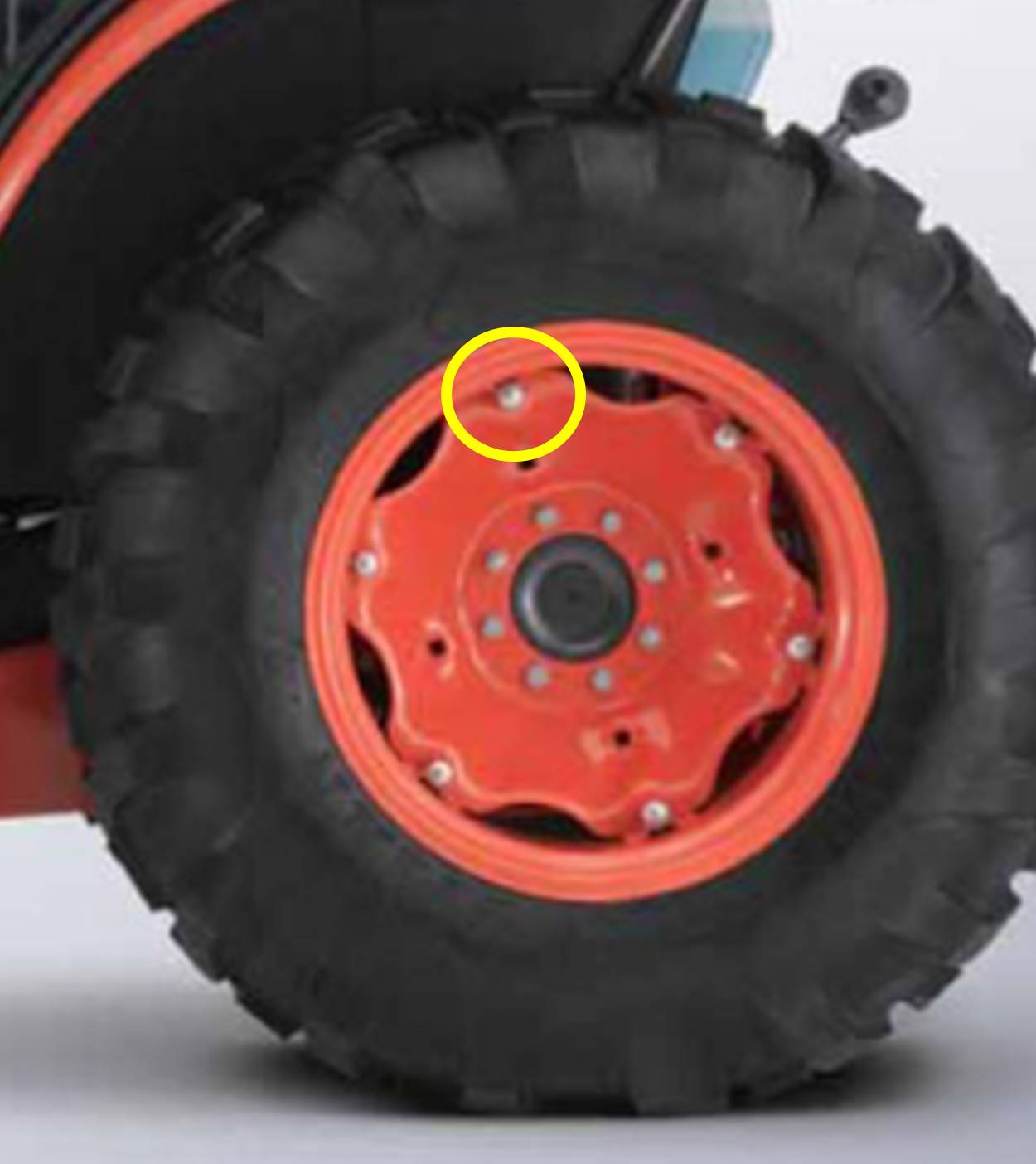

It is hard to tell from the photo, but the hub disc appears to be inside the wheel rim mounting points. Still there may be one wider setting by flipping the tire around on the hub (and you would have to swap sides too). The mounting points on the wheel rim are not centered on the rim, so for the widest setting you want them positioned so they are in the closer position to the tractor. Then position the hub behind them so the hub is closer to the tractor than the rim attachment points. Here is the diagram from the manual that shows it (albeit, not the best graphic, IMO). They go from narrow to wide, left to right.

Few months back I purchased a used L4740 with R4's. The tires are very close to inner fender as you described. It looks like my hub and rim can be flipped around to gain more clearance. I'm hoping to learn from your experience before going through the labor of doing so. The downside of doing so for me is this will likely exceed my front snowblower width...

I held out some hope that I'd have enough clearance with a careful chain installation. So tried it, and if every single link was perfect I still only had about 0.1" clearance on certain links. No way would the chains stay that way during actual use.
My local dealer (farmer's CO-OP) said they did the thing with turning the tires/hubs around and swapping sides frequently, so I looked into that. After measuring and talking to them again, it looked like that was going to give me TOO MUCH clearance. I've forgotten what we determined, but I'm thinking it was an extra 3.5" per side. That would be too wide for my blower and even for my 84" rear blade when angled. In the end I decided on 2" wheel spacers from BORA (Motorsports-tech of Reno, NV). Those spacers are nicely made, I had the dealer install them and load the tires at the same time. BUT, even with only 2" per side my blower is now a bit beyond my rears (looks like about an inch per side) and the 4" total extra tire width is a lot more noticeable when grading with the rear blade than I expected.
Unfortunately we have had very little snow here (southern Rockies) and I have not been able to test the blower to see if I care about the width or not. If it seems to matter I'm thinking I could either add some wings to the blower or I could sell it and go up to 7 ft. I didn't pay too much for the 6ft blower, but finding a 7ft 3-point blower in good condition around here may take quite a while. I regret buying a 6ft anyways, it wouldn't cover the tracks either way in a bend. Don't know what I was thinking...
I want to suggest that you could take some measurements from your own machine and see what you think you'll get by reversing the tires. The mechanic at our dealer said something about "not all these wheel assemblies were the same". I couldn't pin down if he meant not all the wheels were the same across the different models, or across the range of years. I'm not even sure if he knew --- they just don't seem to pay that much attention to it. BTW, I never measured my old MX5100 hubs during the 3 months that I owned both machines, but they sure looked the same as my L5740's and I was pretty sure at the time there was no difference. Only later when I got into it did I wonder if they were exactly the same or not.

Can you post a close up picture of your hub/rim orientation where they bolt together. I believe yours are set the same as mine are currently, but would like to verify. The chains are way more aggressive than what I could use, but it's nice to see the design works in our situation. Can you provide a website? The chains I've found for R4's typically relatively large link diameters which reduces clearance, I'd be ok with smaller diameter (weaker or less robust) chains, if they would fit as well as yours do. Thanks for your contribution!
