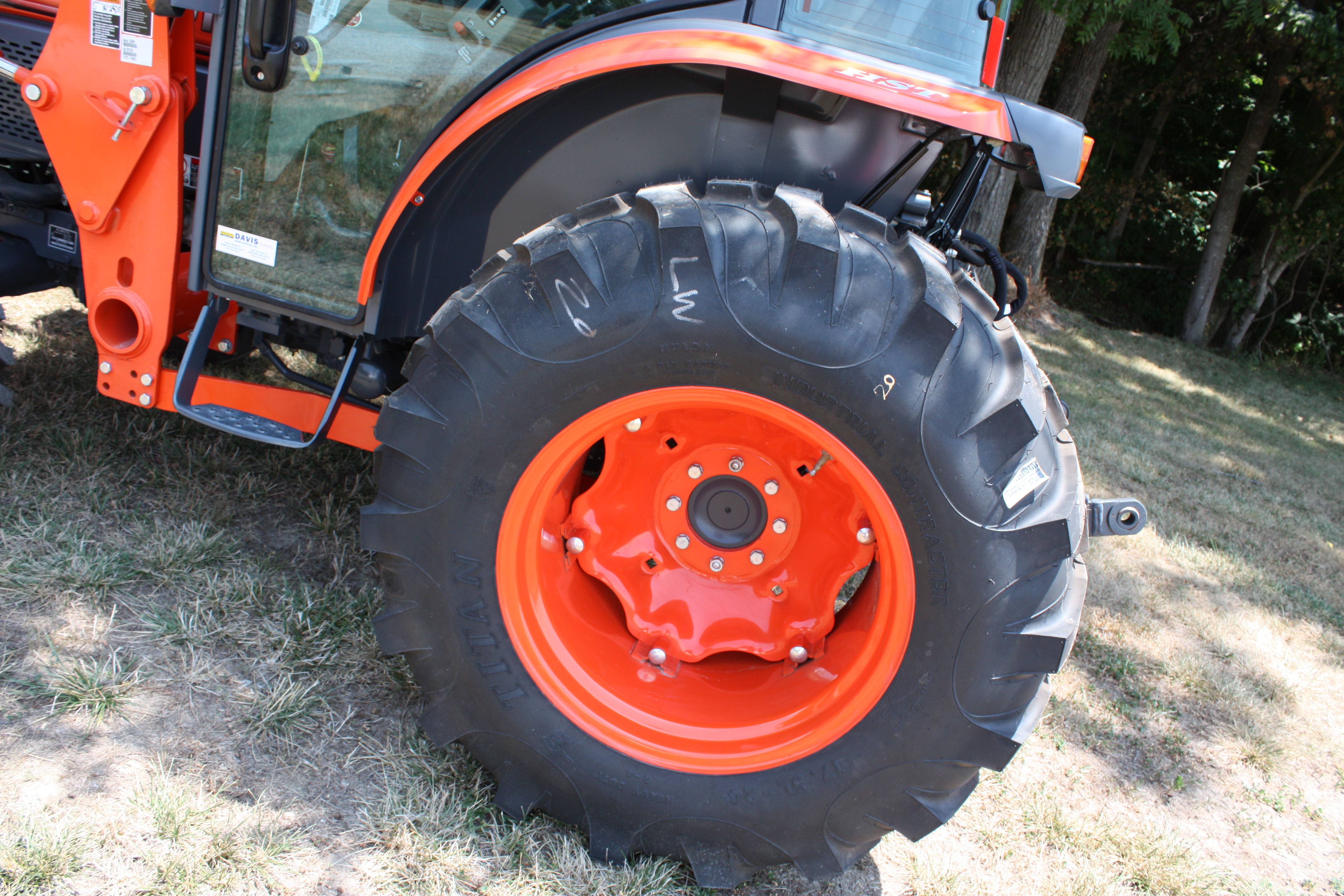

/ L5740 Cab -- clearance for rear chains? #16
Here is how mine are set.
#17
Ok, I see, this must be the same setup as mentioned by dstig1 above. How much clearance do you have with that set up?
/ L5740 Cab -- clearance for rear chains? #18
I really don't know exactly and can't get down to it to measure, but it looks like plenty. I mucked a pond out with it and loaded the tires up pretty good with mud and they never rubbed. Here is a picture I just found.
#19
Looks good! So that means I won't have to buy anything or make anything, good news.
