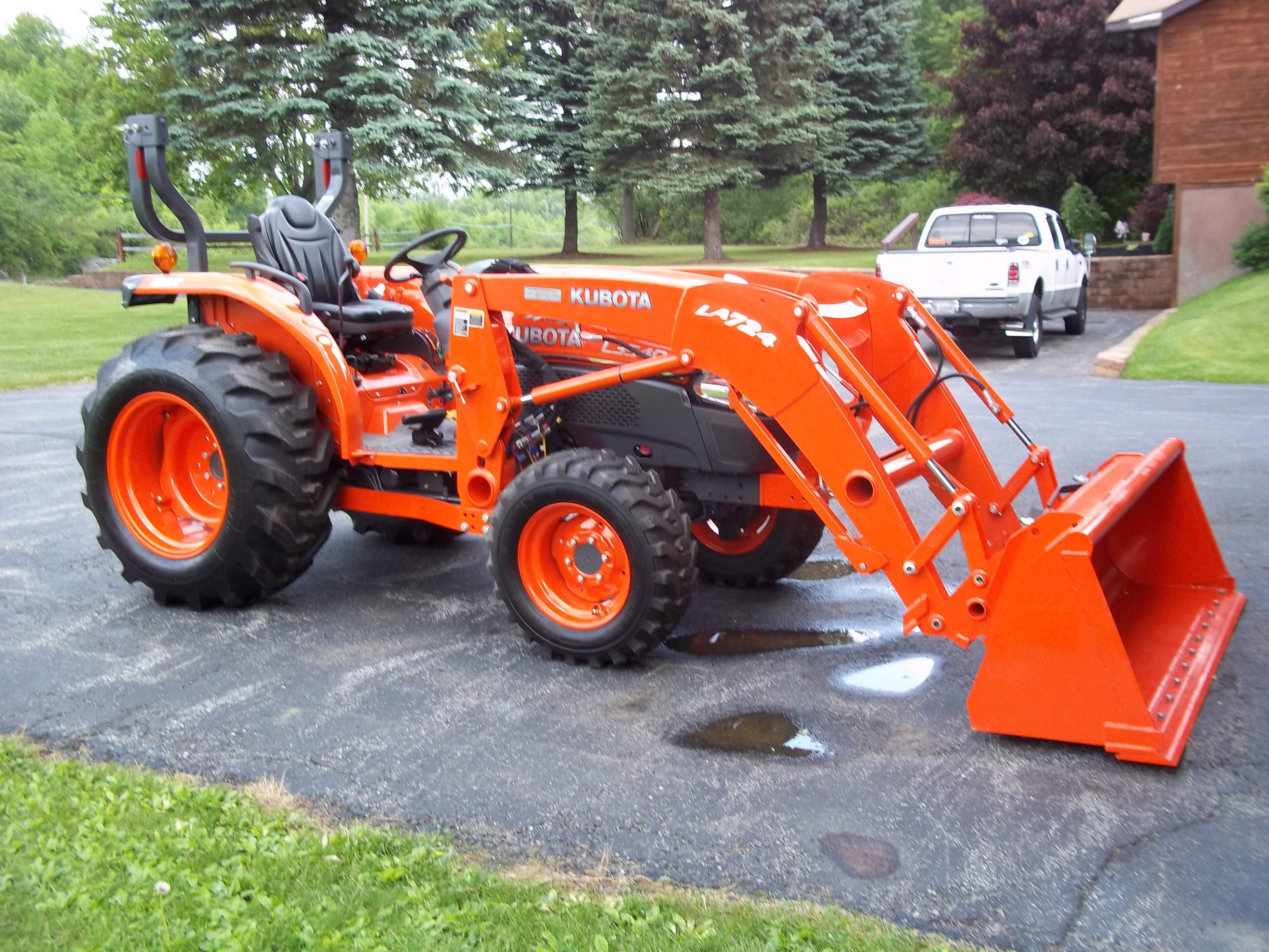

Looking to pull the trigger on a L4240 before the end of the month.
Currently looking at:
L4240 with GST
R1 tires (loaded)
LA854 loader with QA Standard Bucket
1 rear remote
Have I missed anything?

Consider the HD bucket/separate cutting edge?
Bucket hooks.
Maybe some worklights.
You were smart to get the rear remote - wish I had done the same.
Nice machine you're getting!
-Jim

Exactly what baby Grand has said, look @ heavy duty round back bucket with bolt on cutting edge( Real heavy Duty) also @ least one rear remote.

Thanks for the replies. The L4240 will be a compliment to a Ford 3910, a Ford 8N, Farmall 140 and a Kubota B21 TLB.
Intended uses include bush hogging / finish mowing / planting corn / drilling beans / picking corn / driveway maintenace along with the assorted uses for the FEL.
I already have plans in the works (and materials on hand) to add a cutting edge along with a removable toothbar and to weld some chain hooks on the bucket. I priced the HD bucket but couldn't justify the extra $$$ considering the price and availablity of used and aftermarket buckets in my area. I would be interested if any one has had any trouble with the standard duty bucket from anything other than misuse / abuse.
Worklights are also in my plan to be added on later, not sure if I am going with HID or standard halogen. The FEL on my B21 is pretty much useless after dark if you are utilizing the factory headlights. I would be interested if any one has had success with mounting worklights to the standard ROPS. IMHO you can never have enough lights.
Probably won't do draft control, we have already converted to no till for the corn.
The single rear remote will be needed by the corn planter and disc, when it is not hooked to a hydraulic top link (already ordered). I figure if I need a hydraulic outlet on the front I will add a few feet of hyrdaulic hose and some bulk head fittings on the FEL. (or add a second valve body).
I already have the B21 TLB and the Kubota BH option was almost as much as what I could sell the B21 for so I plan on keeping it.
As far as the mid mount PTO I don't have any attachments that need that.
Thanks

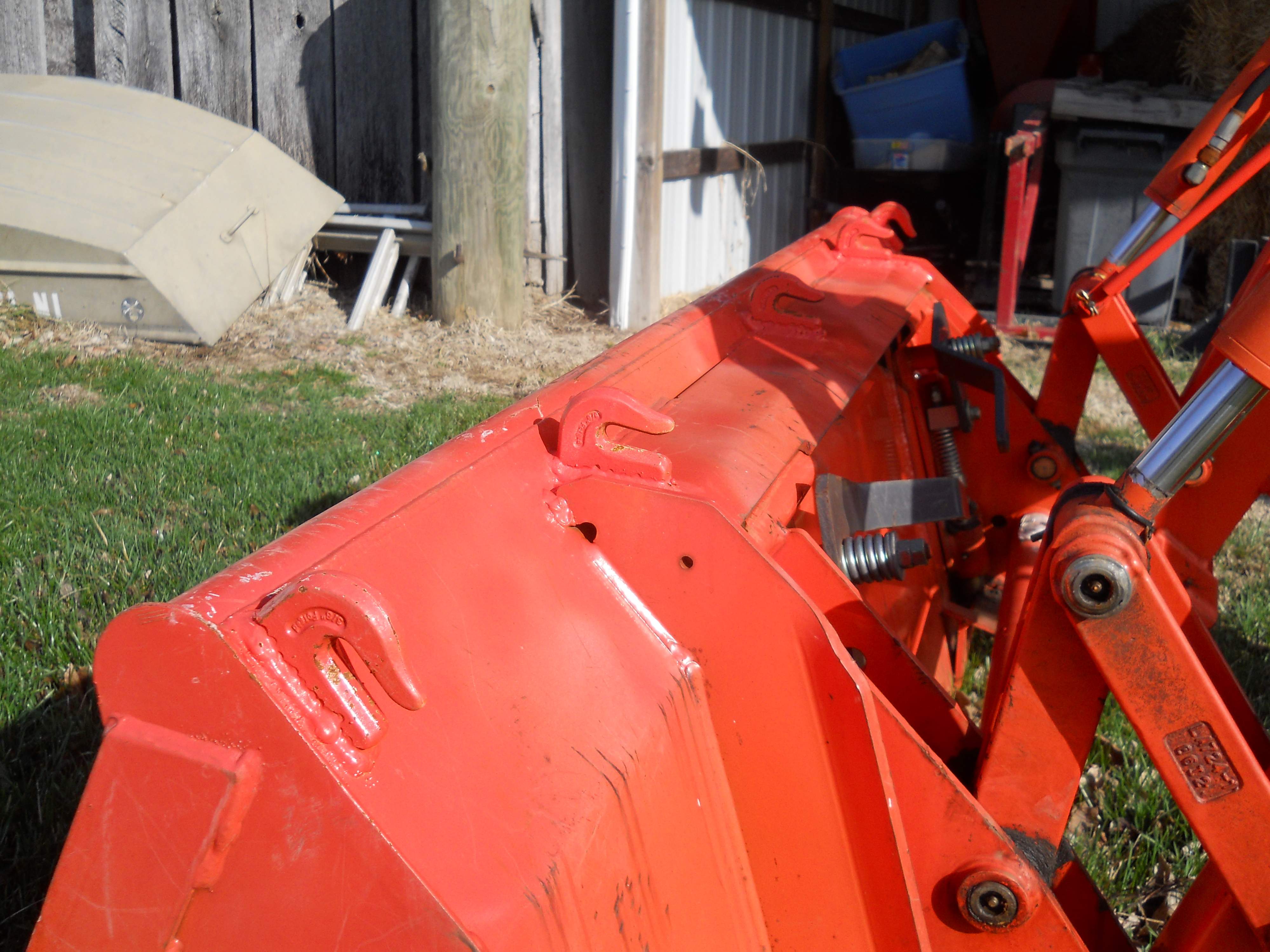

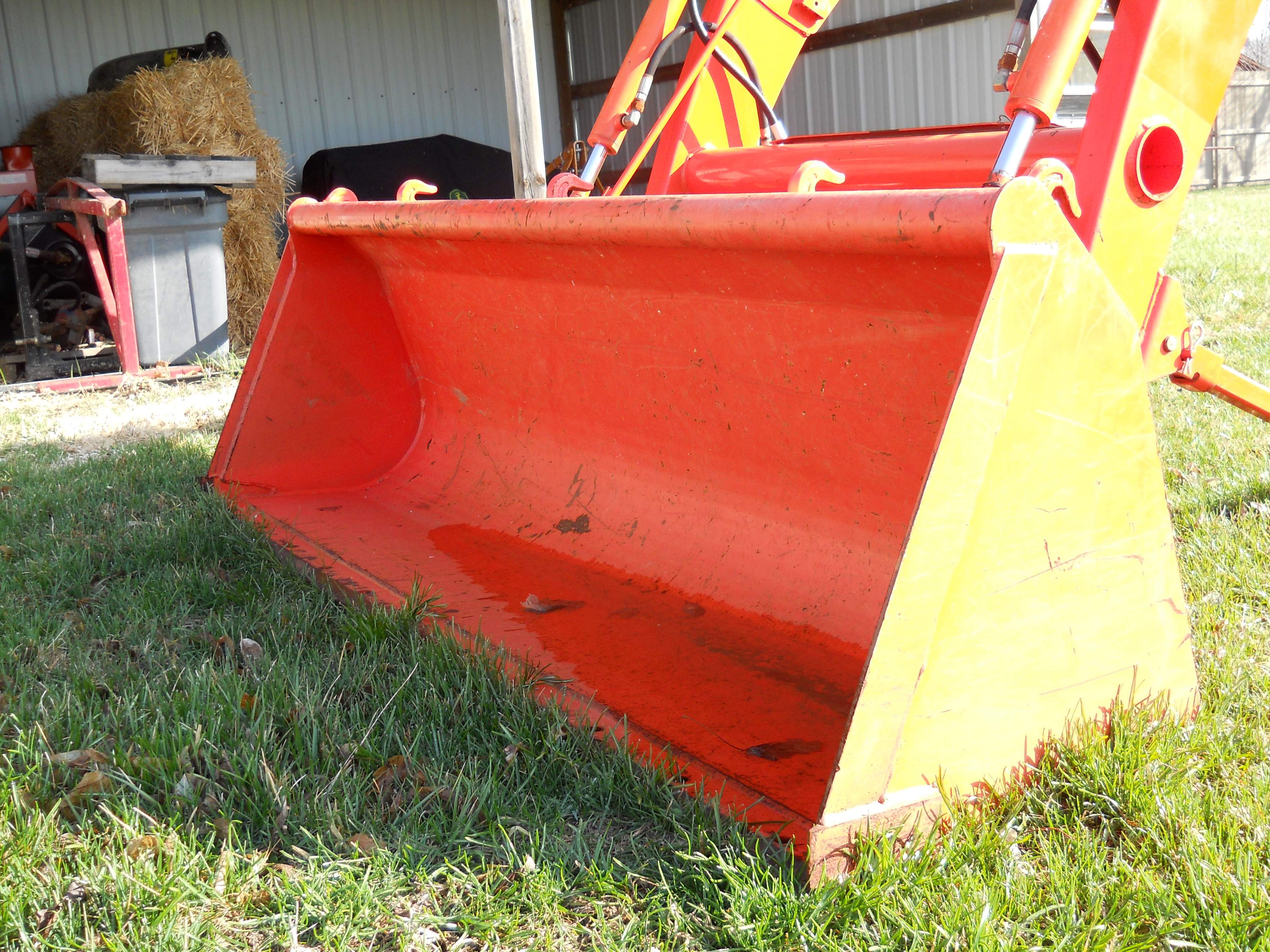

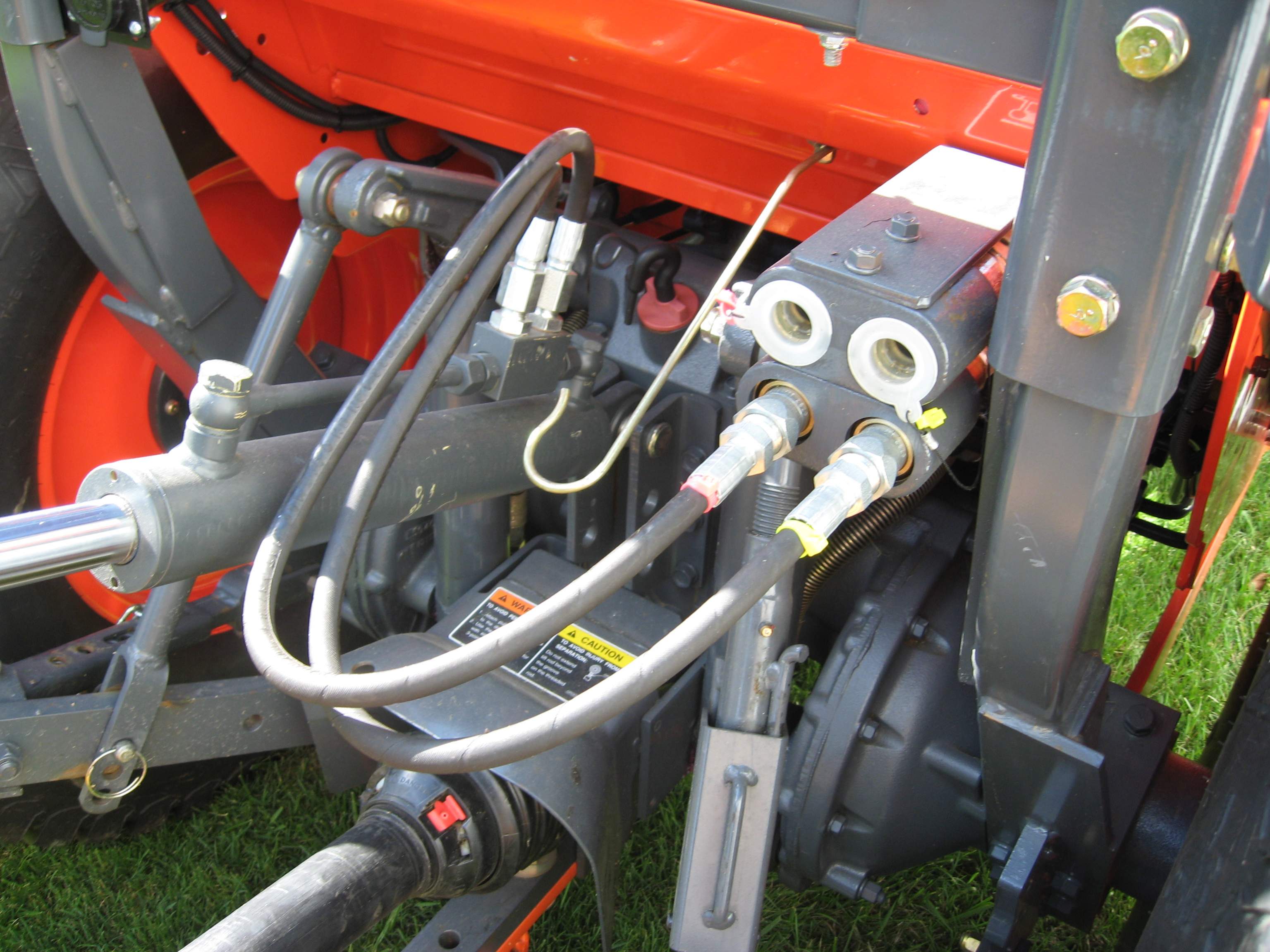

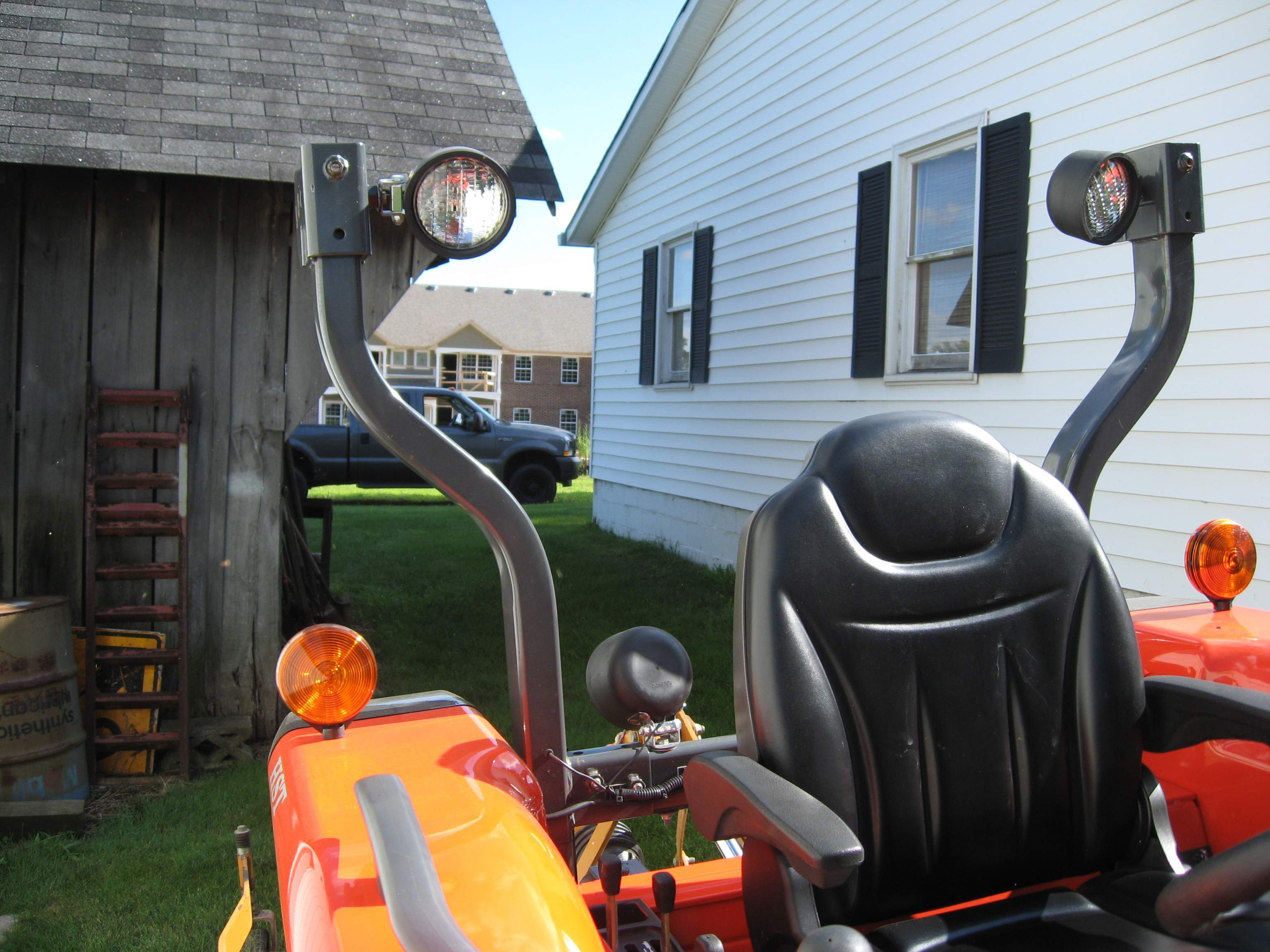

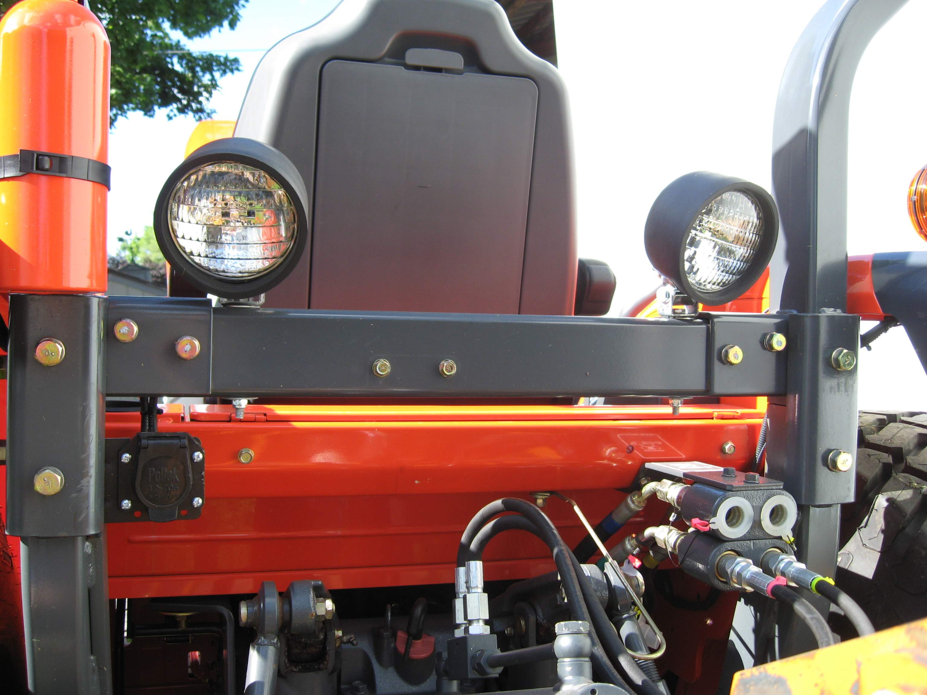

I would go for the heavy duty round back bucket, that is what I have, and from filling with rip-rap to lifting with hooks, I have never had an issue. I started with no remotes, then went to one, and just recently added the second. So, I would also get two rear remotes. Here are my lights, but my thoughts on rops may be different than yours. Philip.

U bolts or get some muffler clamps to attach working lights to ROPs. there be a few folks i have seen recent pictures of doing this.
the rear work light would most likely be ok. but front work lights off ROPs. don't know. never been in that situation before. all i can think of, is "shadows" from me and fenders and FEL arms and not showing a good hard constant light were you might want it. for using FEL at night. perhaps front work lights kinda like ears on your head and sticking off sides of ROPS with maybe a little short extension.

+1 on getting the heavy duty bucket. Wish I would have on my jd 3320. Also bucket hooks are much more usefull than i imagined.

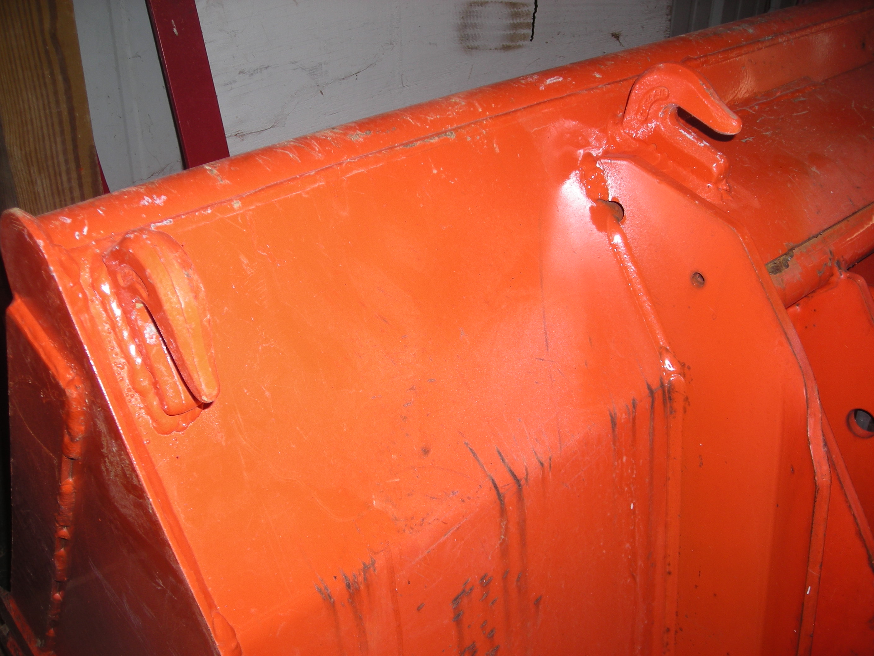

One of the things that makes the HD round back bucket so strong is the pipe going across the top. I did not reinforce my hooks when I welded them on because of that. With a standard bucket, you may want to add pads to help spread out the load under the hooks. Philip.
Very nice, I need to set the bucket on my L5030 that way.:thumbsup:

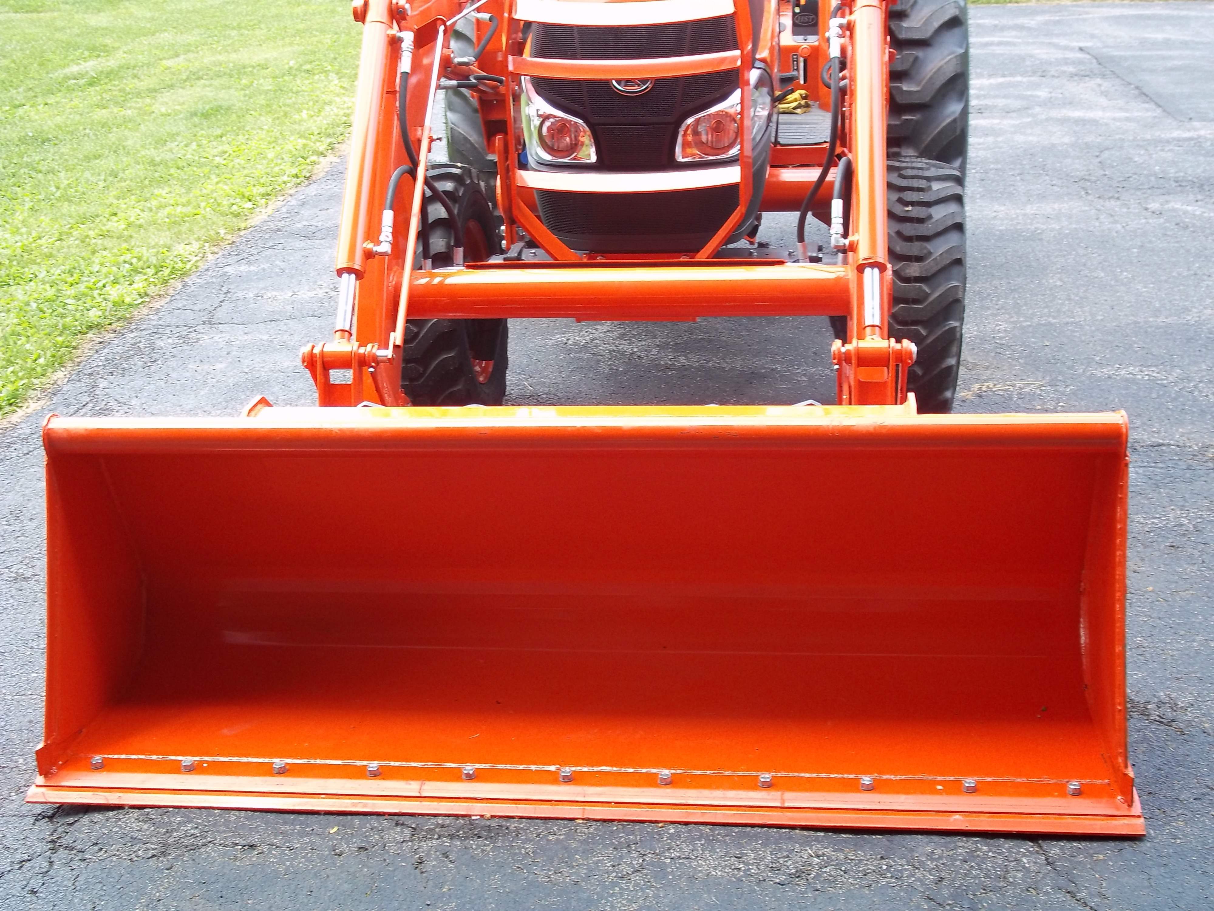

Saw a lot of talk on here about front and rear facing worklights, we manufacture a light bar that u-bolts onto the ROPS to face down over the FEL bucket, its is completely watertight and includes switches for the lights in the bar, check it out at:

$275 for two front lights and one rear light! You gotta be kidding me! Plus, the way they hang out there, I would have them knocked off in a week. I have less than $50 for all four of my lights, two waterproof switches, fuse, wire, and bolts. You can get one of these nice light bars from Northern Tool for $140, and it has four lights built in. Get two, one for front and back, with eight lights total, for the same price as yours! Nice product, but there are better options. Sorry, but thats my honest opinion. Philip.
