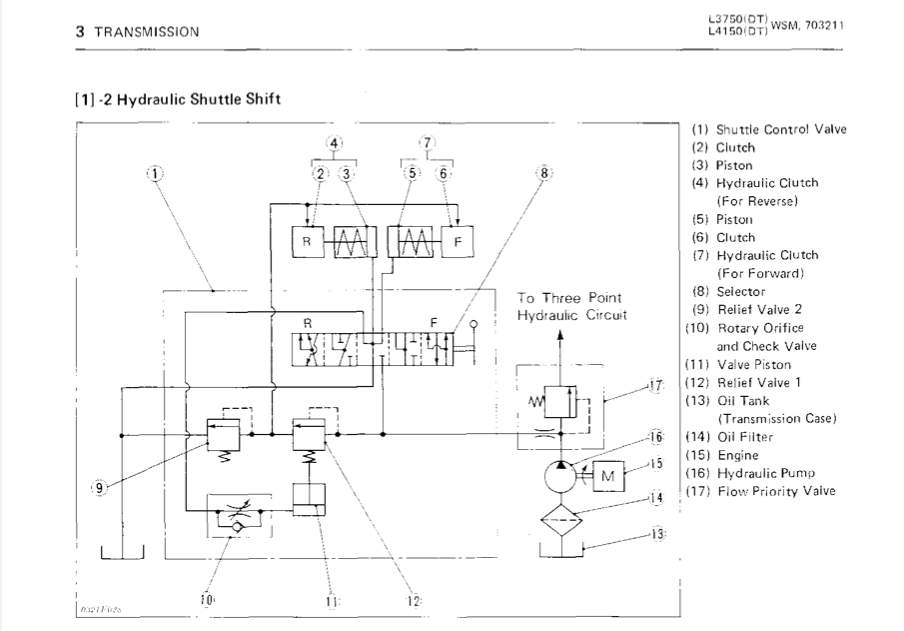

I just picked the tractor up, PO had health issues, and it sat for five years until he passed away, and I purchased it from the estate. I changed the oil, flushed the fuel, and put a new battery in, and the tractor fired right up (huge relief). The 3 point lift works bucket lifts and has enough power to lift the front wheels of the tractor, but it won't go anywhere unless in the lowest gear. The best way I can explain it is it feels like it's slipping. My automotive experience and knowledge tell me it doesn't quite feel like a burnt-up clutch.
At this point, I feel like I've read everything there is to read on similar issues, and this:
That site sucks, and there is no resolution to his problem, but that's precisely what I am experiencing.
It's raining today. Otherwise, I would be out working on it, but my first course of action is to replace the hydraulic filter, and look for some kind of adjustment on the shuttle valve.
Curious what else I should look out for, and what the best way to definitively figure out if it's the clutch or not.

I'm thinking it has something to do with 4 and 7 in the first drawing. Or 17, the flow priority valve?

If 17 sticks flow will go through open center valves to tank, no pressure for HST but stalling a cylinder (curl up & hold) should divert full flow to HST. If it doesn't I suggest 17 isn't the problem. I also think if it was 4 o 7 one direction wouldn't work, but both? :unsure:

I agree, after further diagnosis and research, I believe it's the single dry clutch between engine and transmission. I think this because when traveling forward and it "slipping" the PTO is not turning.

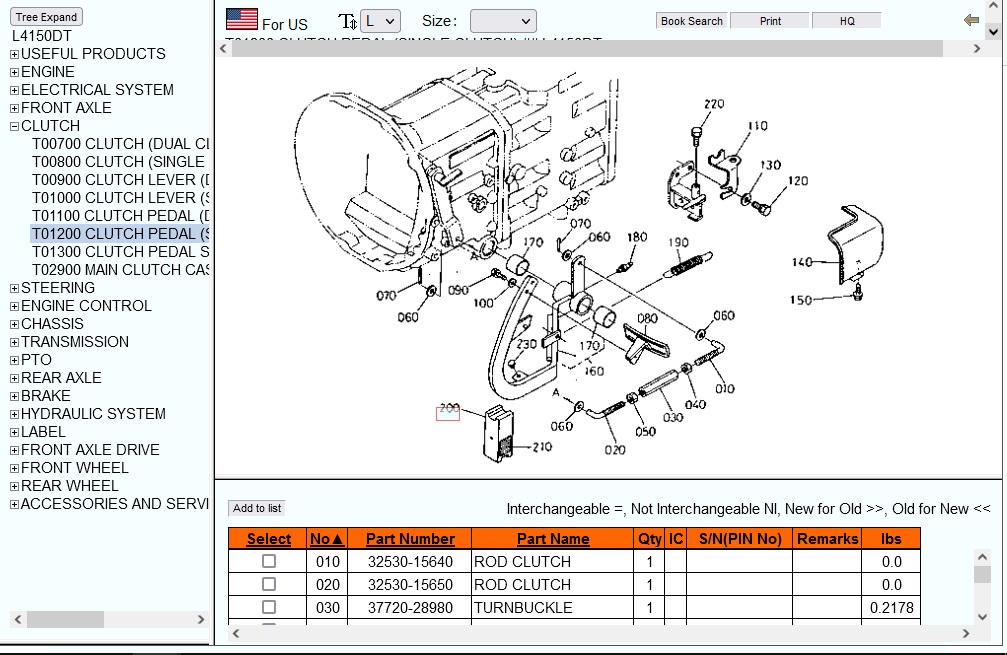

I had a L4150 with hydraulic shuttle for a few years - one of the models Kubota built its reputation on in the U.S. - great tractor. (I now have its brother L5450)
The symptoms say its the main clutch that needs adjustment, not the shuttle valve linkage.
There should be about 1" of pedal free play before the clutch starts to feel heavier (starting to disengage). If tapping the clutch pedal stops drive and pto, the PEDAL linkage under the left floorboard needs adjustment.
The turnbuckle 030 in the diagram needs to be adjusted so there is 1" free pedal play. That should restore motion with pedal up.
You may find that with the clutch pedal correctly adjusted, the pto will no longer disengage with the pedal full-down. If so, post back and we'll go from there. Best luck - and Happy New Year ! Dick B
I did mess with the adjustment and ended up disconnecting the rod altogether to take the clutch adjustment out of the equation and it still slipped. I went on ahead and ordered a new single-clutch disk kit.

This rig sitting so long, strange conditions can develop.
Another possibility is that the release bearing and/or fork has become stuck in the near-released position and won't move back enough to fully apply the pressure plate, clamping the clutch and engaging the drive.
Does the clutch pedal move down freely now? Is it hard to push? If so it could be hanging up on part 080.
I'd try using some extra force to try to get more travel in the release direction. See if the clutch lever 110 or 060 or 040 will move back further - like lifting the clucth pedal but using more force directly on the lever to move it back. If it's not stuck too bad it could free up, saving a machine split.
p.s. glad you mentioned it has the single clutch - the pto adjustment on a 2-stage would make this less nice to fix. Dick B

I went on ahead and did the clutch, the clutch in there was toasted.
It's a lot better and obvious that the single disk clutch was slipping badly, but I am still having some slipping issues in higher gears and it's for sure not coming from the single disk clutch as the PTO still spins when it's slipping.
At this point, I think it could be some kind of internal hydraulic seal leaking, problems with the priority valve, blockage somewhere?
