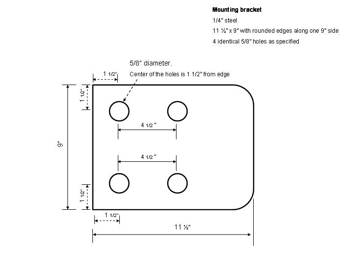

I'll take some pics tonight when I get home. My bracket is very simple, 3 small pieces of 1/4" steel welded together and bolted to the ROPS. The steel cost me $11 (cut to size) and a tin of Skoal to get my buddy to weld it. Literally took him less than 5 min to weld it. The hardest part was drilling the holes so they lined up right w/ the valve assy as my final dimensions were a tad off from what the spec sheet shows. I think that's due to everyone tightening down the valve assy a little differently.
If you don't hear from your guy and like the way mine looks I can send you some drawings and you'll see how simple it is.

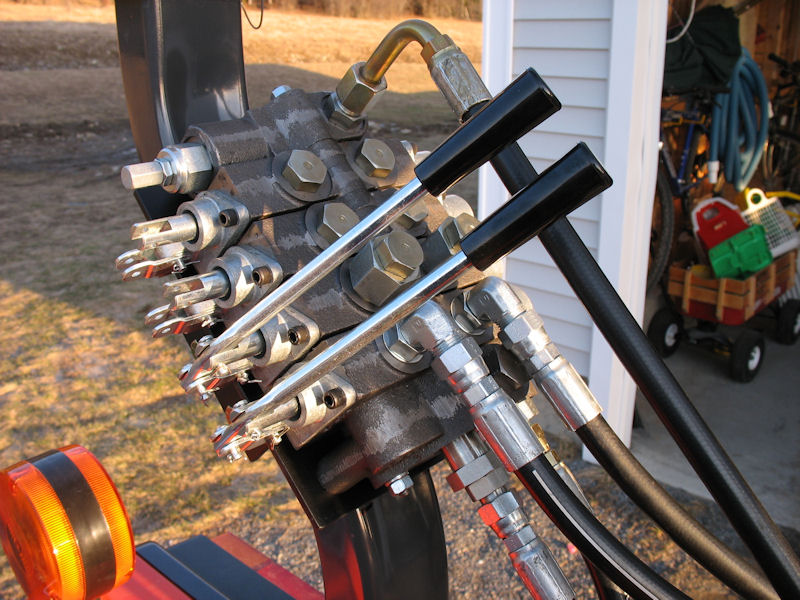

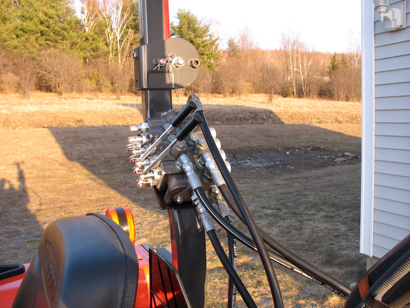

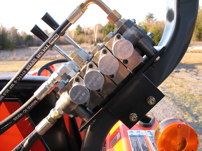

/ L3400 CCM hydraulic top link length #67
Finally got a chance to snap some pics last night. I know, my hoses are a little long, but I was afraid of getting them too short and then being screwed.
If you look at the valve assy you'll see a set of "risers" next to where the top link goes in. That's where the 90's will go for the side link when I get that back from CCM.
Now I gotta see if I can add a cylinder for my rear blade angle :)

/ L3400 CCM hydraulic top link length #68
Canoe,
Per your request here's the mounting plates. As I said before, I used the KISS method. Very basic.
The 2 side plates were simply welded to the base plate, I believe they were 78mm apart. Then I used 2 3/8" x 4" bolts w/ lock washers and nuts to secure it to the ROPS.
The long hole spacing distance on the base plate is the "tricky" one. According to Prince's drawings this distance when you have 4 work ports should be 7.187" between the mounting holes. Well, mine wasn't or I didn't drill exactly right :) I had to fudge one of the holes a little bit. Oh, and I used 1/4" plate steel so 1" x 3/8" bolts w/ lock washers worked great for mounting the valve assy to the base plate.
Let me know what you think.

/ L3400 CCM hydraulic top link length #69
**** I keep posting... but I forgot one other little piece of advice my local hydraulics shop gave me. The fittings on the top and side link according to them weren't ideal. They said because the cylinders will be moving and the hosing moving and twisting that the copper/brass washers that were used will leak. Plus on mine one set of the fittings was an odd size of "British" fittings. You may want to swap yours out when you get them.
#70
SR:
Really appreciate the photos. You've got me all juiced up now.
Irritated that my mounting plate is taking so long. In hindsight I should have bought a chopsaw and some steel, cut it to size myself and drilled holes myself using my neighbours drill press and then taken it someplace to have it welded.
I like the mount location. Another one I thought about was on the angled part of the ROPS but rotated 90 degrees so that the work ports are along the rear of the tractor. This can be done with your mounting plate as is just by rotating. You will have to move around your handles again so that they are accessible if you do that.
I imagine that whatever my mont plate ends up being, I can get it to fit on that angled part of the ROPS instead of where I had originally planned it (the location of the factory valve).

#71
Didn't think that the top link woudl come with fittings but thanks for the advice. I'll swap them out.
Noticed that you didnt' bother using QD's for the top link. Guess you have no plans to take it out eh? Thats one advantage of having a lot of ports on the valve :)
/ L3400 CCM hydraulic top link length #72
Ya, you could flip it to the back of the ROPS, but it's simply personal preference. I tried it there and didn't care for it b/c 1.) it blocked some of my view and 2.) the handles felt weird there. If you do flip it to the back, you simply have to make the side plates a little longer.
I welded the 2 sides on to the base simply for mounting & un-mounting ease. The whole assy just plops onto the ROPS w/out having to fish around w/ bolts holding the whole together. The valve assy is not really light, at least when you're trying to hold it in place w/ one hand to see how it fits or fish around w/ mounting bolts. Again, it's all personal preference.
As for QD's... I couldn't think of a time when I'd not be wanting the top & side link :) No need to take them off.
#73
SR, I've decided to copy your mount EXACTLY. Looks pretty nice to me. It's out of the way but yet accessible. Your pictures and drawings made it real easy to email it out to the guy that is going to build mine so he won't have to come by again to figure out what I'm asking him to do.
