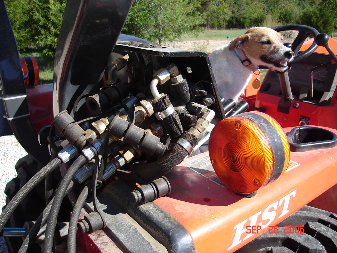

StrangeRanger, these are wushaw's photos of his Kubota mount that comes with the Kubota kit.
Note that the flasher seems to have been moved to a new location to get it out of the way.
I had the guy who is going to weld me a mount up here and decided to have him use the Kubota mount as a reference. The valve can be bolted up vertically like the Kubota one. I'll have to take the handles off and put them on the other side just like the Kubota.
The end result should look pretty much like what wushaw's mount looks like and I won't need 90 degree fittings on the valve ports - as the valve will be vertical rather than horizontal.
He said he's going to charge me 100 bucks to up a bracket - sounds like a great deal to me.
I'm going to have to bite the bullet and muck around with moving my toolbox which is bolted on that size and would not open if I moved the flasher up as in wushaw's photo.... argh! Thats going to leave a few holes in the fender that I'll probably just paint and smooth out.

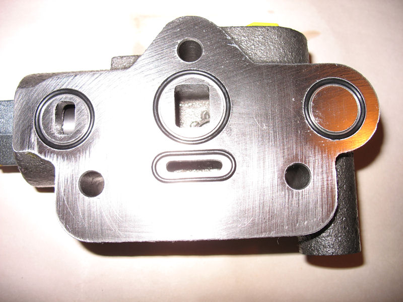

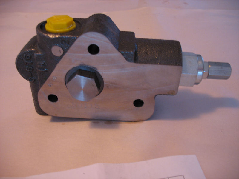

Got my port plug & o-ring yesterday. C'mon CCM!! :)

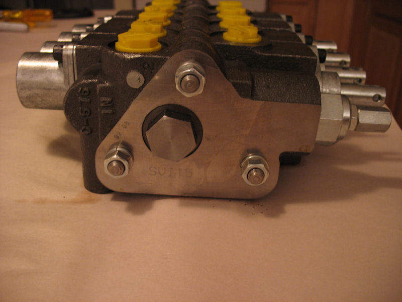

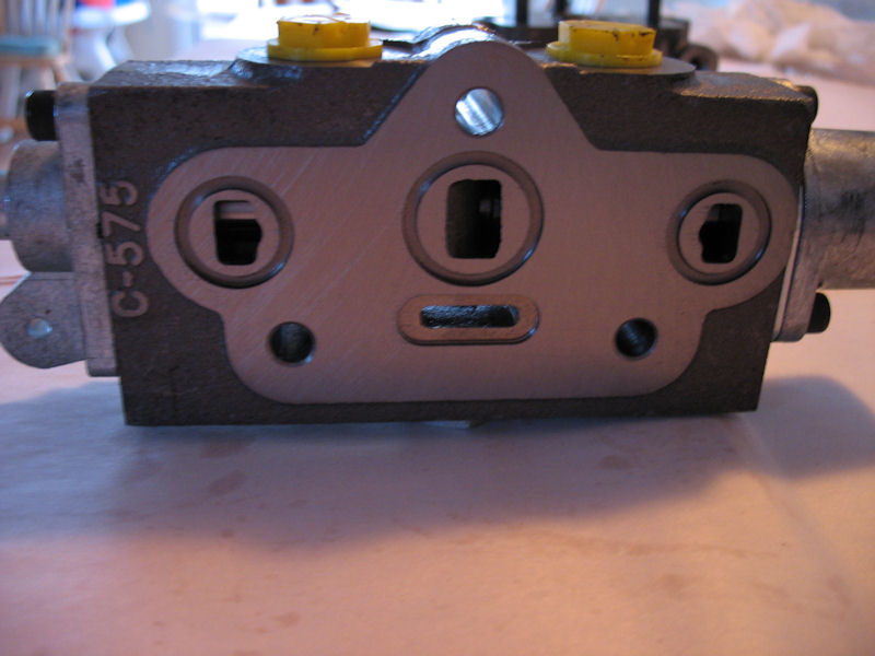

If anyone considering this project wanted some pics, here are some pics of the valve assy.

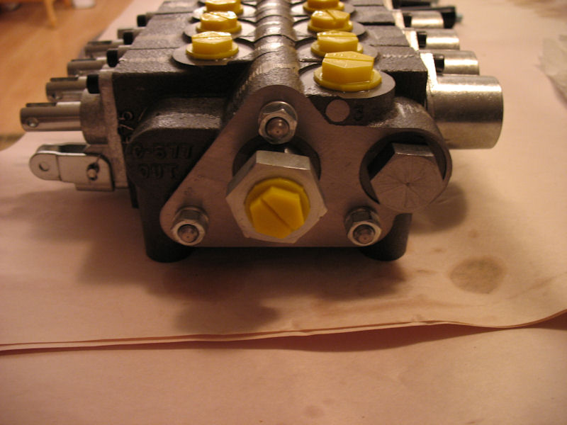

/ L3400 CCM hydraulic top link length #48
And more pics of assy.

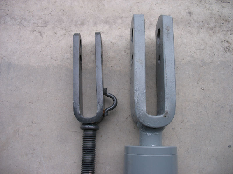

I got my cylinders yesterday, good news & not so good. The top link is sweet. But I'm disappointed w/ the side link. Honestly, I'm feeling a little rooked. The side link was by no means inexpensive and it's supposed to be a "custom" build, but it sure doesn't fit like a custom build. Guess I've got to call Mark and see if anything can be done. Pisser.
After lots of fiddling around I've also decided where I'm gonna mount my valve too. Once I flipped the handle around, it actually fits nicely on the angled section of the ROPS. It might look a little odd there, but of all the places I've tried it that spot offered the best visability, I won't knock the handles by accident, the mounting plate is very easy to make and the hoses will be very easy to route. So I'm gonna try to get some time off from work tomorrow and get my hoses made and weld up the mounting plate. Hopefully I can make the side link work, but that might have to wait. At least the top link will work. I'm stoked!

Yup, I talked to Mark @ CCM and I'm going to take some pictures for him and then I'll have to send my side link back to be modified.
If you look at your side link you'll notice the bottom fork on the stock one is angled to line up w/ the lift arm. My side link from CCM does not have this angle so it binds up when connected to the lift arm. Plus, the hole size is not right. It's got like a 3/4" hole instead of 1/2". I'm gonna measure the hole, I think it's actually 13mm so I'll ream it out when I get it back if that is the case. But w/out the fork having the proper angle the geometry is all wrong.
Attached is a napkin drawing of where I'm gonna put my valve. Once I flipped the handle to face towards the back of the tractor I actually liked it up there. Well, I liked it out of the possible places I could think to try it. Flip your handles and place it up there and see what you think. Since I've got to send my side link back nothing is written in stone or welded in place :) That view is from behind the tractor, looking at the SMV sign. Don't laugh at my drawing. Simple to make. It's 3 flat plates welded together and 5 screw holes. KISS method.

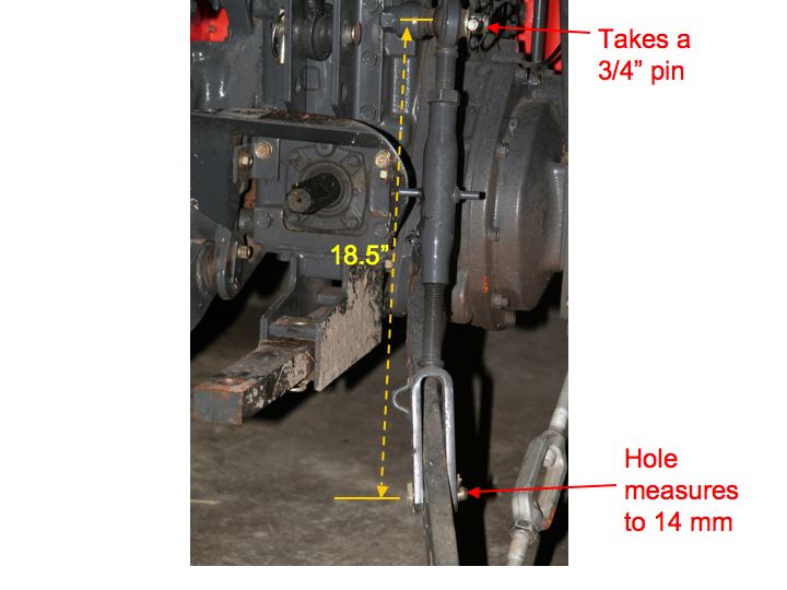

My side link is the 16.5" but I believe you're remembering incorrectly, it has a 4" stroke.
The top hole is 3/4" and I just measured the bottom pins w/ a caliper and they are actually 13.85mm, so just a hair over 1/2". I told Mark I'd like a half inch hole and I'll ream it out the rest of the way. Plus, I've got to source a longer pin or bolt as the fork on the new side link is about 1,000 times beefier than the stock one. See pic below. I just hate waiting, but I'd rather wait and get it done right eh.

Hi StrangeRanger:
You are right - that was a typo. It is 16.5" with a 4" stroke. You are right - I will need a longer pin too. 1/2" pin should be quite easy to find I would hope.
I've posted a picture of my sidelink that I sent Mark with measurements.
I don't have calipers so I measured with a goodly tape mesure - figure I came pretty close to the real size with 14 mm :)
