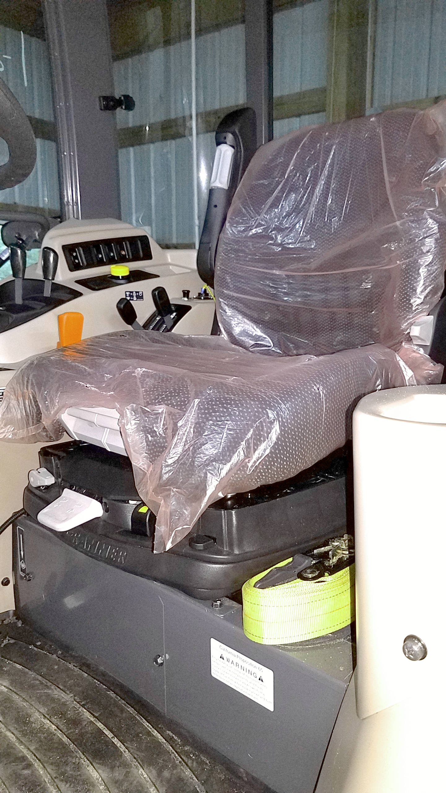

I'm a fat *** and the seat on my m7060 was ok but would never give me enough height. Kubota advised me there air seat would not due either. So I went to Grammer seats web site found what I wanted air seat rated at 460 pounds. The base is wider than current seat. I made an adapter out of 1x3 tubing, two 17 long tubes drilled for tractor pattern on bottom, new seat on top. Wonderfully comfortable. you can adjust seat depth and tilt. Bought mine from tough seats Inc. They configured it exactly the way I wanted it. MSG97/741 $1300.00

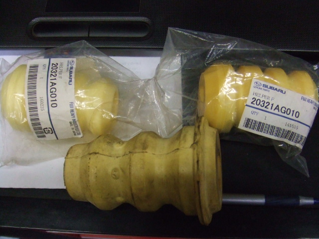

A quick fix or try would be to add a rubber jounce bumper from a car suspension. There are many varieties if you could get your hands on a few from an auto parts place or if you have a go to shop that does suspension work you could at least look around to find one to try. Cheap fix and easily placed under the seat near the stopper to try.
Different materials like urethane that come in different compaction rates (for lack of a better term).DSCF1052.JPG

Grammer makes Kubota seats so the so the msg95 series air handles 330# and fits the bolt pattern in the floor, Get OPS switch and any options you'd like order from tough seats and have dealer pay half and install. What nice about the air I inflate to height I want, then adjust damper to firm or soft. I like my front a little lower than the rear and I like little more depth you can add both options. Kubota is going to do nothing for you. Toughseats built the seat I wanted and had it to me in 5 days.

Had tractor in for 50 hour service last week. Dealer split cost of air ride by Kubota and installed while there. It has rained about ever day or nearly since getting it back up to over4 inches a day and it has not left shelter since it returned. Should be on it at least Saturday and will post my thoughts on it. I still am not impressed with Kubota's attitude on this but am pleased with the dealer's.
