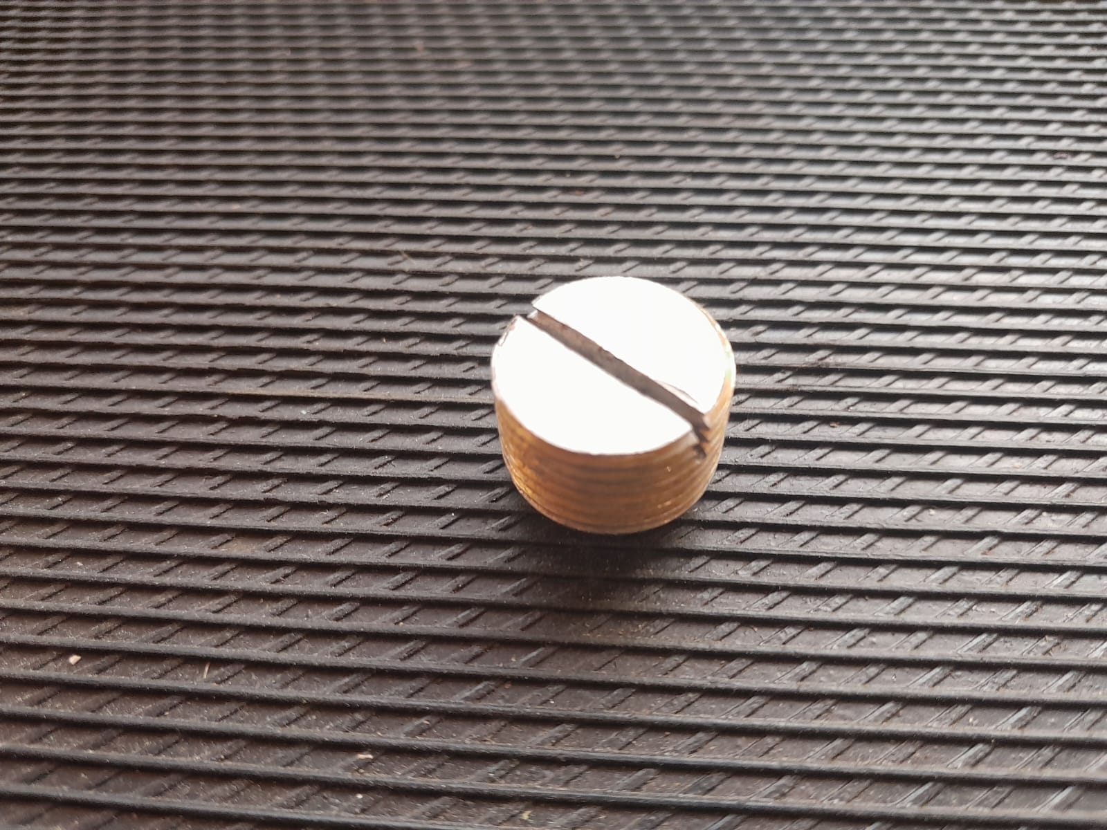

I've been able to confirm what I posted above. This is a 3/4-16 UNF threaded opening, not tapered.
Good. It would have been poor form to cross-thread that opening at this stage in the game.
I have found out since the other day that the old B7100HST tractors (vintage 1977-1984) used a HST charge filter in that same top of the HST case position that was a 10 um (0.0004") filter and mounted with a 3/4-16 UNF thread. So your BX may do the same. Some Work Shop Manuals do mention that thread specifically, so apparently that filter is special that way. The filter may even have a male thread??
I've no idea why my M59 transmission filter is threaded differently.
