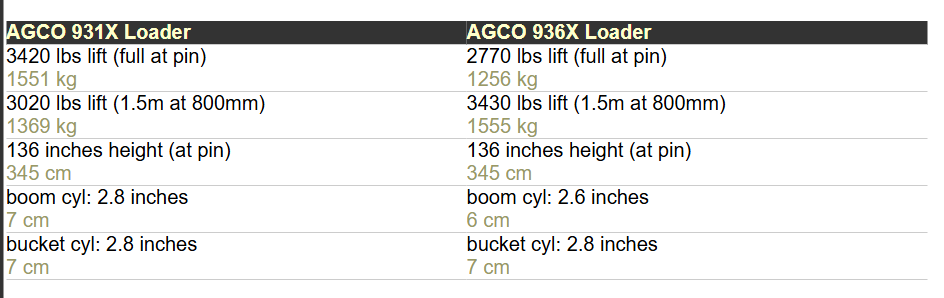

The cylinder sizes, Something I have noticed with Kubota is their use of small cylinders and rods on their FELs.
Even my 55 HP Rhino with Koyker FEL has 1.5" rods and 2.5 ID bore cylinders,
Those appear to be larger than the LA 1353 cylinders,
60MM /2.36 " and 35 MM/1.378"??? are these really on a 95 HP Kubota tractor?
My guess is in the comparable size Massey, NH, or Challenger, to the Kubota the FEL cylinders will be larger, heavier built, and likely won't need to be cranked all the way up to 3000 PSI to achieve their lift specs.
Sure Enough. That is a Huge difference 2.8 " bore cylinders.
Sure Enough. That is a Huge difference 2.8 " bore cylinders.View attachment 3969981
