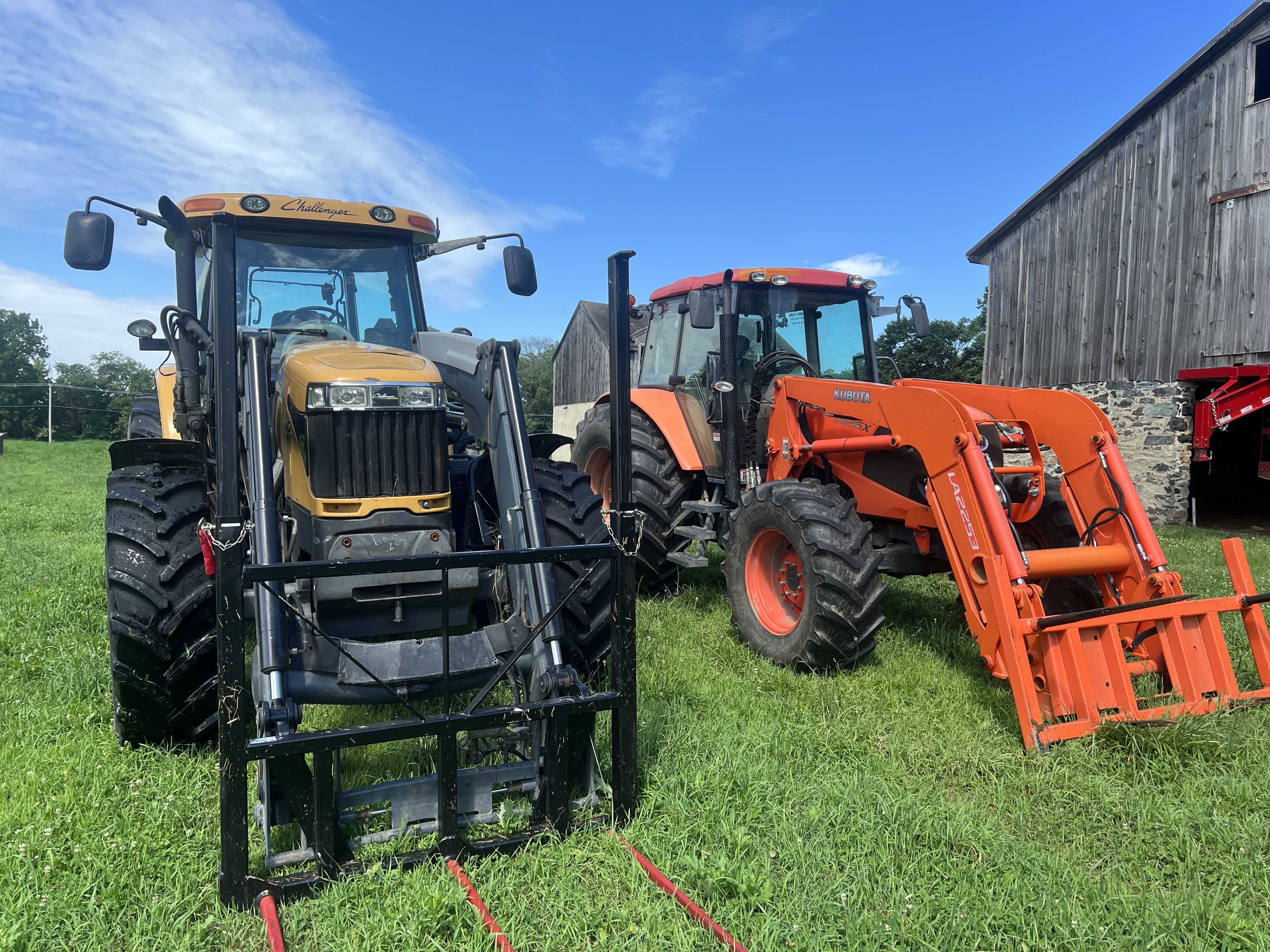

Some other things worth mentioning:
I also previously owned a Kubota M-126X (126HP with loader) and M-135X (135HP with loader).
The M-126X suffered a PTO failure at less than 3,000 hours. Cost was guesstimated at $3,500. I sold the tractor to a buyer, disclosed the issue and discounted the price accordingly. It also needed both front wheel seals & bearings.
On the M-135X, it had a ECM issue at ~2,000 hours which caused it to lose its glow plug function. The dealer advised me it could also lose other electrical functions. Dealer estimated $5,500 for new custom made ECM from Kubota. I also disclosed this malfunction to the buyer. I had to install a manual switch for GP’s.
I replaced these (2) Kubota tractors with the Challenger MT535B (same as Massey Ferguson 7475) which I purchased with twice as many hours (~6,000) than the Kubotas. The Challenger needed brakes and a master cylinder which are expected at the 5,000-7,000 hour range. Since that repair, just minor hose repairs and (2) front wheel bearings and minor, understandable issues, a few owner-caused.
Keep in mind, this Challenger MT535B (Massey 7475) tractor has almost 7,000 hours on it now. The Kubotas were giving me fairly significant problems at only 2,000-3,000 hours.
IMO, The Kubota tractors I owned (4) are ill-suited for long, hard hours of Ag work. They are fine for low hour estate/small farm work.
So for those of you considering either brand, know that when it comes to their larger brothers, the AGCO brands have run more hours with less trouble.
One more thing: I also currently own a Massey Ferguson 7495 now for 8 years. This 200HP tractor has 7,000 hours on it and has been a great tractor
(knock on wood).
