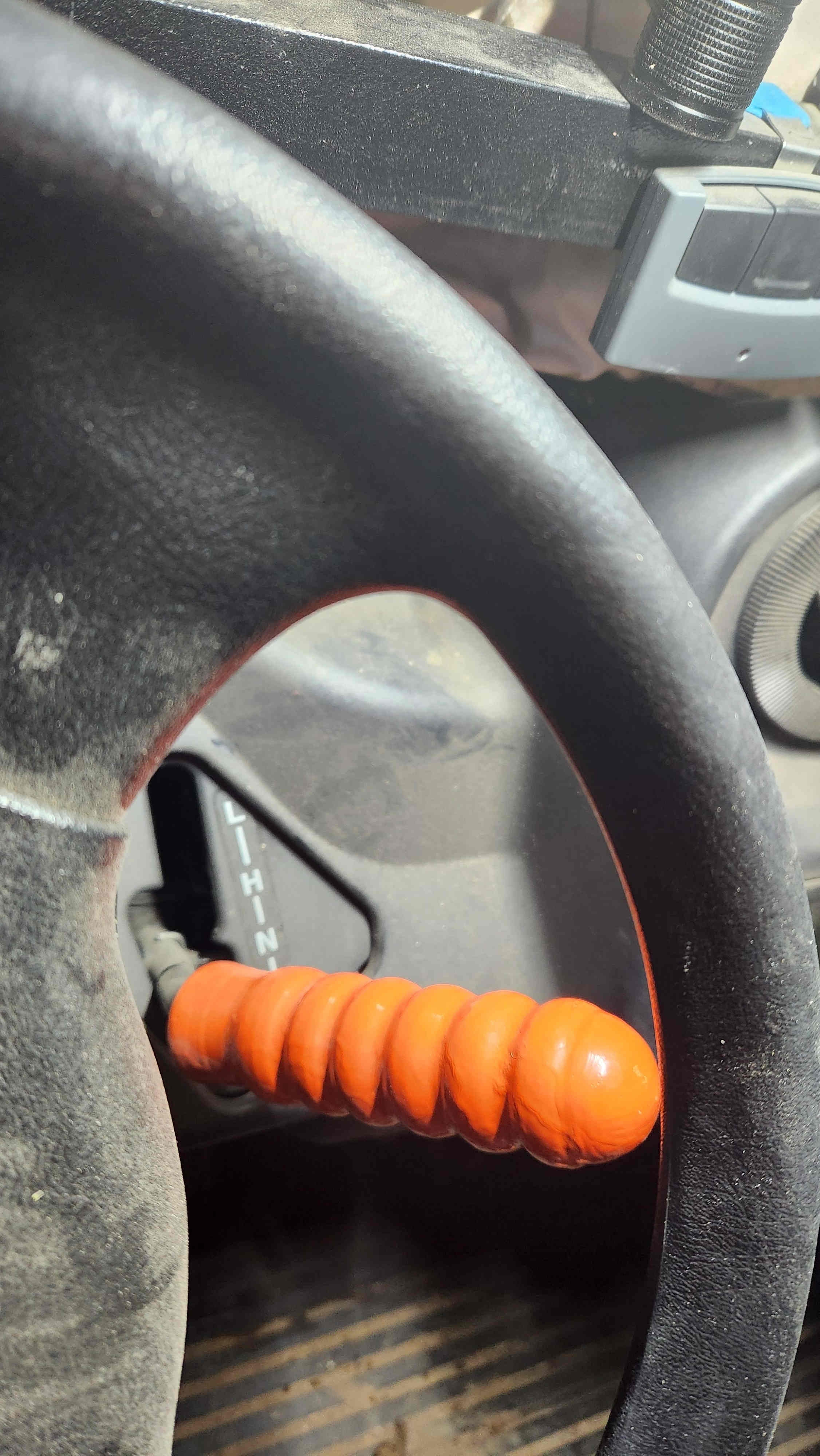

Several years ago my wife complained about how difficult the 1100 was to shift, so being a wood turner she made a new handle replacement on her lathe.
I welded a nut on a tube as an insert.
The new handle does make grabbing the shifter easier and able to exert more force, but I can't help feeling a little inadequate using it.

Umm.....

I'm using every ounce of self control I can muster so no comment.
