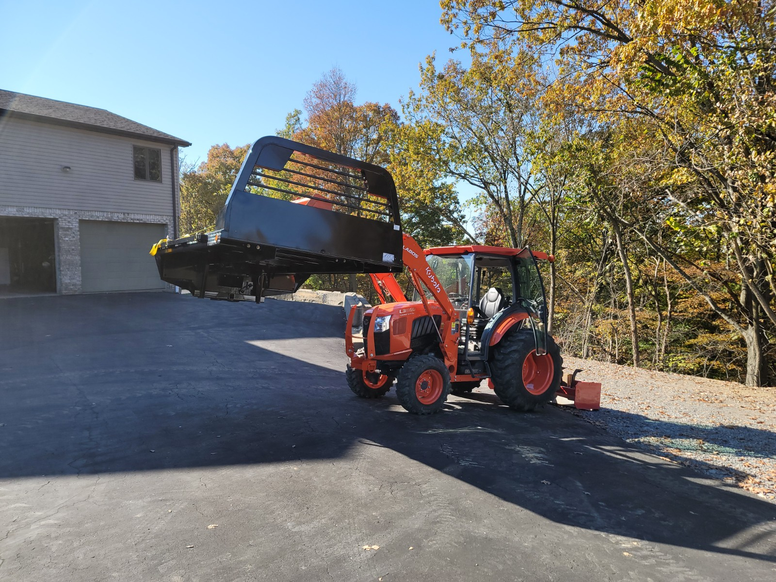

I love my L3560. If you found a used one, I would strongly suggest that you go at least look at and touch it. The stability is so much better than my B2650 I had. The B2650 could get tippy on side slopes while my L3560 (both with loaded tires) has been on such a side slope with the brush hog that I slid sideways down a hill and never lifted. I had the rears at the widest position on both. I also had a BX for a VERY short while and hated it. It was so tippy that it was just unsafe to use. Everything I did was in pucker-mode. The L3560 is a great machine and stability platform for it's size.
This is a Norstar Single Wheel Long Bed that is advertised as 1070 lbs, you can clearly see that it is far out front of my bucket.
You can dang near see light under those rears.
