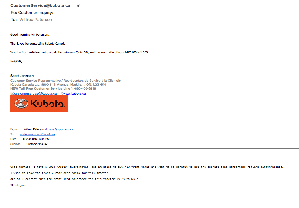

Hello all! Was wondering if anyone might know what the front to rear axle ratio might be for Kubota MX4700/5100?
Seems like important information that is not contained in the owner's manual. Or at least I have not been able to find it.

I have an MX5100 and went through this too a while back. I contacted Kubota. The gear ratio you are looking for is 1.559. I attached my correspondence which I hope comes through. Never tried attaching before.🙂
There is a formula to use with this ratio to assure you are in the appropriate front lead range.
Thank you for the information Hoobie!!
