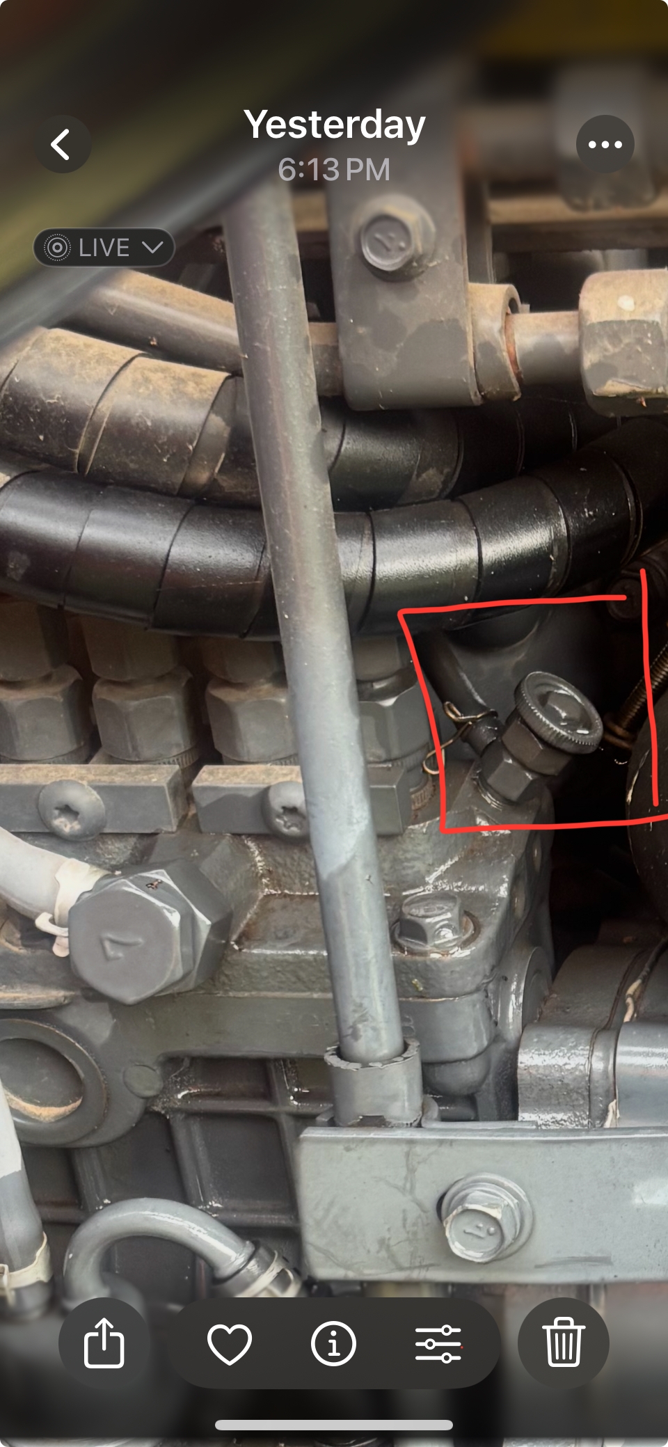

There is a 1/4” tube coming off the back side of this bleeder valve on the fuel system. Mine has a pinhole in it spraying fuel all over the engine. I checked the valve and it was rotated all the way to the left, which I think would be the “open” position so I turned it all the way to the right to what I think should be the “closed” position but it still sprays fuel out the pinhole in the tube. I have two questions if anyone knows and can advise me I would appreciate it.
1. Shouldn’t this cock normally be in the closed position and only opened when bleeding air is necessary or is it ok to leave open all the time because it apparently dumps back into the fuel system somehow???
2. Is the valve gone bad since it still lets fuel through the 1/4” hose in the closed position?

I'd say that the bleed valve is probably working as it should. The leak is coming from fuel in the line and coming from somewhere other than the bleeder. To confirm that slip the hose off the bleeder and start the engine. I think the fuel will exit the hose not the bleeder. Can you just shorten the hose and cut off the part with the pinhole? Or just replace it.

Kubota's all use the hose attached to the bleeder valve to return excess fuel from the injectors to the fuel supply (like most all diesel engine's do). There will be a Tee fitting up higher on the side of the motor somewhere that allows excess fuel from the injectors to access that hose. I'd just replace the hose with the pinhole with a new hose (your friendly auto parts store will have the fuel line) and the valve should always remain closed unless you are evacuating air from the fuel system, righty, tighty. Curious as to how it got a pinhole in it as I've never had that issue on either of my Kubota's.

You were correct Harry! The valve is still working correctly. I guess there is back pressure pushing fuel out. $1.10 for some hose and it’s good to go! Thanks for the response again!

I don’t have a clue how it got the pinhole in it but it wasn’t there last fall when I finished up hay season and fired it up yesterday to make my first hay cutting of the year and after one round I noticed something dripping off the frame on the right side of engine and climbed off to have a look and it was spraying away. $1.10 section of fuel hose from Oreileys and it is fixed now. The bleeder cock was fine too, I just didn’t think it would have fuel pressure on it with the cock closed but I guess it is supposed to. Thanks for the response! It’s great to have knowledge tractor guys to toss ideas off of!
