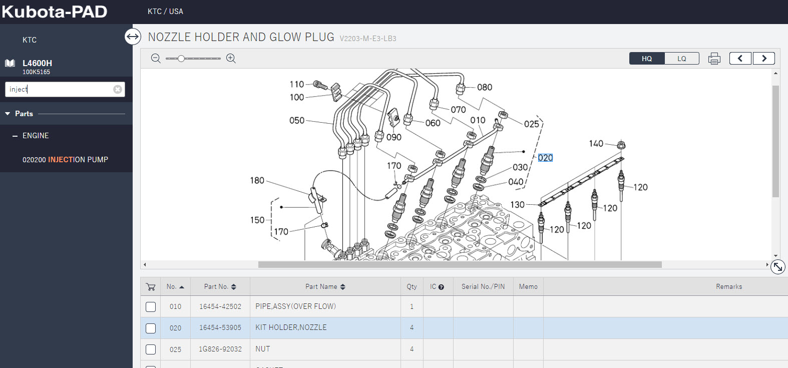

OH MY GOD DUDE.!!
NEITHER.. follow those steel lines up.. they will dead end AT THE INJECTORS.!!
Loosen the lines AT THE FLIPPING INJECTORS.!!
   / Kubota L4600 ran it out of diesel, emptied fuel filter bowl... won't start... #22
The top nut is B.. top nut/delivery valve holder on the pump..
A- is the injector line that connects the pump to the injectors..(in the head)

Kubota parts diagram has no inidicator these were the injectors... I get it now... injector... cylinder... it's injecting into cylinder at the cylinder side. I think the teardown video i referenced for a BX model indicated that the senders were "injectors" (e.g. injecting into the line and sending it down the the cylinder)-- confused terms.

No worries, we're all here to learn and help. On the teardown video pic you had, you were looking at the injector pump. On these tractors fuel is delivered by gravity flow to the injector pump, which then pressurizes the fuel into the steel lines going to the injectors - to put it simply. To bleed the air off, you need to loosen the nut closest to the injector, which is up on top of the engine. It doesn't take much loosening - less than a whole turn usually.
