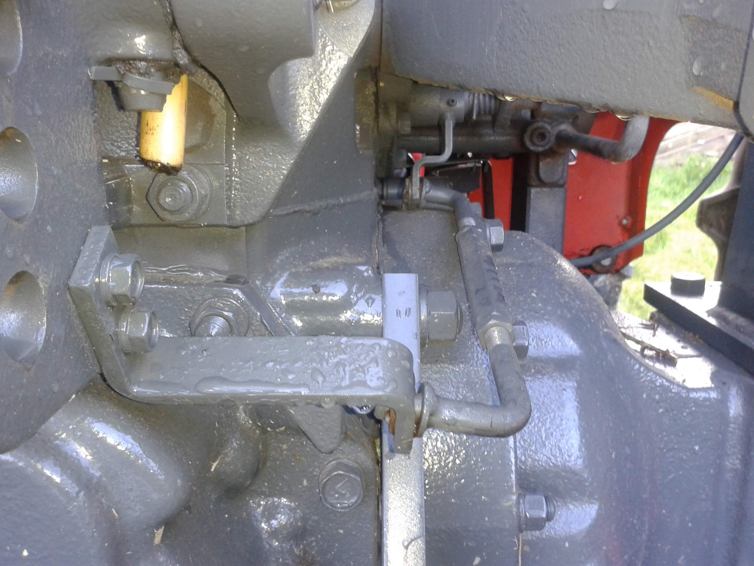

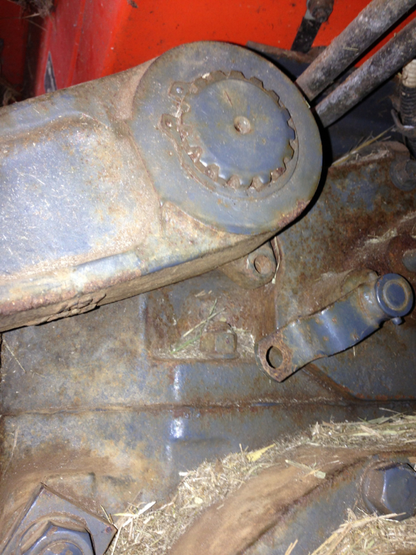

I have a m6800 that has lost some linkage to the arm from the valve. I bought the parts that I thought were missing but don't see how they could work. Does anyone have a picture that can show me what I'm missing?
It's the part from the hydraulic arm to a small valve lever a couple inches apart. The only way I can lift the arms is by pushing valve under the arm. And the parts are to long as far as I can tell.
Thanks

I need the parts from lever to arm
/ Kubota m6800 3 point hitch problem #5
Here you go it is a m5700 but it should be the same the missing link goes to the back of the tractor not the lift arm.

/ Kubota m6800 3 point hitch problem #7
In addition to looking up parts utilizing Messicks one can look up parts at Kubota Tractor Corporation parts site
Correct missing parts should be the following.
3A011-81393 rod
3A011-81380 rod
32350-28980 turnbuckle
02116-50100 nut
32350-28990 nut
Thanks for the pics and parts, it helped me a lot.
The feed back link was what was broken and the draft control link was missing
That's why I was confused
Thanks again
