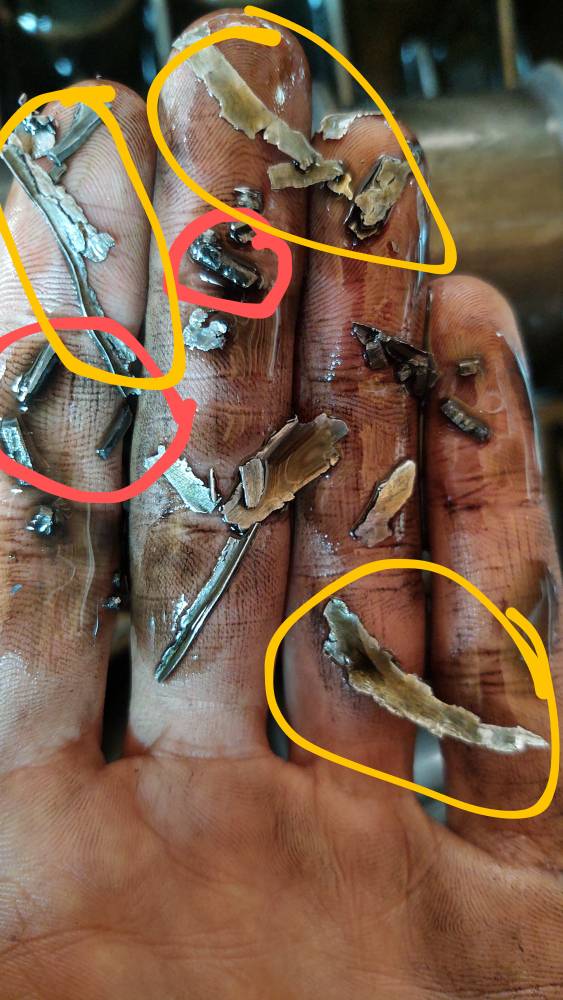

Huh, that doesn't really look like bearing material, some peices almost looks like gear teeth?
/ Kubota L4740 Engine "knock" Help? #62
Is the material magnetic? You may or may not be able to feel play from grabbing the rod.

There are two different types of metal. Some I would describe as "pieces" (circled red in photo) are magnetic.
Others are thin "shards" (circled yellow) that are not magnetic.

Those magnetic peices look a lot like gear teeth, the non-magnetic could be rod bearing material but don't look like what I'm use to seeing in rod failures.
How soft are the non-magnetic peices? Do they bend really easy or are they stiff and brittle?
Either way the engine is most likely going to have to come appart, but I'm wondering if the issue isnt under the front cover.

I'm not surprised you cannot feel anything in the big ends. That's common even with wear. Some people say they can tap the big ends with a light hammer and find wear by the different sounds, but I've never been able to do so.
Looking at those shards, I think you have found your problem..... and the first really hard evidence - other than the noise - that the engine did indeed have to come apart.
I think at this point I would put some time into trying to identify those magnetic shards. I use a 40 power diassecting microscope with top stage lighting. to help identify pieces of parts. Could they be pieces of piston ring? Do the rings on that engine are rectangular cross section or or they the lipped type? I've seen shards like that when a piston land breaks up and the rings get cracked. That happens. I've seen piston land failure and broken rings where I am pretty sure it was manufacturing and not abuse.
Another possibility is the keeper for the piston pin - i.e the small end. There is a land in the piston that retains the wire spring keepers for the small end. I have also seen that fail, and there is just no way that could be due to abuse. When that happens there is no doubt because the cylinder scar is very prominent and is just where you expect it to be: in the fore/aft plane of the engine.
Hmm.... You know, with a bright light you might be able to inspect the cylinders. If it really is a broken ring and land or the piston pin keeper then there should be noticable scars in one of the cylinders.
But having said that about the rings, I would be inclined to go with what TMGT suggested. Right now I'd look up into the cylinders for that scarring, but if I didn't see clear evidence of scarring of the cylinder then before disturbing the big ends I would take off the front cover to look for damage there. And also take a close look at the drives for the oil, hydraulic, and fuel pump. Only when I was pretty sure that none of the shards were coming from the various gear drives would I begin to unbolt the big end to pull the most likely piston.
The good news is that it really did have to come apart, and that now there's no doubt you can find the problem. The ones I hate are the ones where I have everything taken apart, spread out, and measured and STILL cannot find where the problem is.

Personally I lean toward a piston/ring issue, seeing as the problem was a knock on one cylinder. They do look a bit like gear teeth, but it doesn't seem to me that that would line up with the knock issue. Unless I've actually got two problems here - some gear damaged and a bearing gone bad??
At any rate I'll inspect the cylinder walls as best I can tomorrow and see if there are any clues.

I would take a couple of those magnetic bits and see if you can see any casting granulation - that would be where the part originally broke off of a larger piece. Gear teeth would have any granulation along the long axis, where rings or piston pin keepers would have the granulation at one or both of the ends. Doing this may require magnification.
Two things gone bad? It happens, but I'm a "show me the evidence" kind of guy. So far I don't see any evidence of a bearing failure.

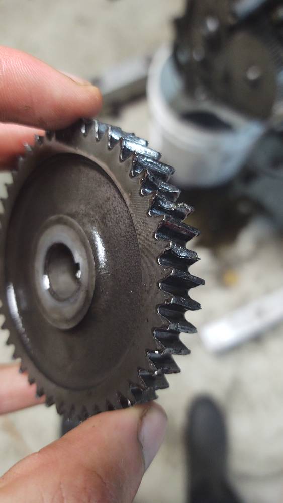

Well, we've found the problem.
Those metal bits were teeth from the oil pump gear, and a few on the crank gear. See pics.
The aluminum shards were the front crank bearing. See pic. It was completely loose. I just pulled it out with a pair of needlenose.
Remember back earlier in this thread I said I thought the crank pulley was vibrating? That's exactly what was happening. And that's why I had to replace the front crank seal.
My theory is that the bearing went bad, which caused the crank to start wobbling, which then damaged the gears. Not sure why the bearing went bad after only 350 hrs...
To me this also explains the knock that wasn't "typical". Every time that front cylinder fired, it applied extra pressure on the crank and knocked that loose bearing around. Also the crank gear teeth are only broken in one spot, so that likely added to the knock.
So next up is to pull the crank and see what kind of damage I have on the shaft.
Thoughts, ideas, recommendations welcome...IMG_20201023_181355159.jpegIMG_20201023_162334812_HDR.jpegIMG_20201023_181421575_HDR.jpegIMG_20201023_181432664_HDR.jpeg

My guess is the oil gallery leading to that front bearing is plugged. You may find that the rod on the #1 cylinder is also fed by that port and has some damage. The good news is that your engine may need a limited number of new parts. Things like the rods and pistons should be fine. I would tear it all the way down and have the block cleaned and then verify that all the oil galleries aren't restricted. Hopefully any plugs that were applied after machining the block can be removed and reinstalled. I know they make brushes for cleaning them out. A bore scope might be worthwhile to check them out.
/ Kubota L4740 Engine "knock" Help? #78
Unfortunately that front bearing spun, most likely the block will need to have that bearing bore oversized (if an oversize bearing is available) or bored and sleeved back to size.
Depending on what other damage there is, a reman short block or used takeout might be in order.
Of course, it had to be the one bearing bore that is integral to the block.

I would say that is an unusual failure. Hard to say what caused it. Factory defect? Abuse from previous owner? Low oil level? I think low oil level usually hit bearing further away though, like a back cam bearing. If the previous owner didn’t abuse or neglect it, probably factory defect.
