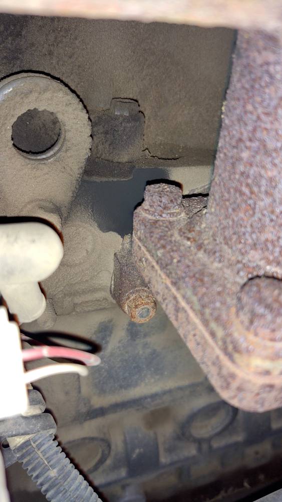

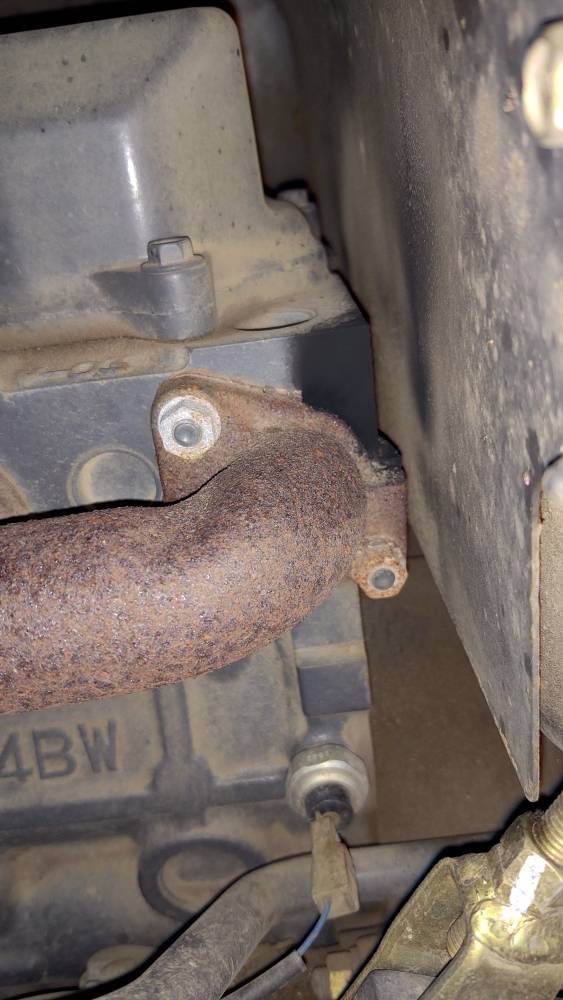

Well, this sure didn't take a rocket scientist. I popped the side panel off where I could get a good look at the entire exhaust. Major blowby out the rear cylinder manifold gasket. And another spot at the front.
Maybe it has a knock, maybe not. I'm going to replace the gasket first and move from there. Any tips or tricks welcome. IMG_20200916_121425492.jpegIMG_20200916_121406277.jpeg

Good chance thats the noise you heard. Nothing special, hit the nuts with penatrating oil and make sure the manifold and head surfaces are flat.
Not sure on that particular model engine, but I haven't seen at lot of manifold gasket failures on the smaller Kubota engines.
Maybe it has a knock, maybe not. I'm going to replace the gasket first and move from there. Any tips or tricks welcome. View attachment 669818View attachment 669819
Good penetrating oil, small turns to loosen and then tighten back up. Do not remove any nuts or bolts until all have been loosened.
I like to work from center outward.
Another old old mechanic trick is candle wax. Heat the bolt/nut melt candle wax into threads
