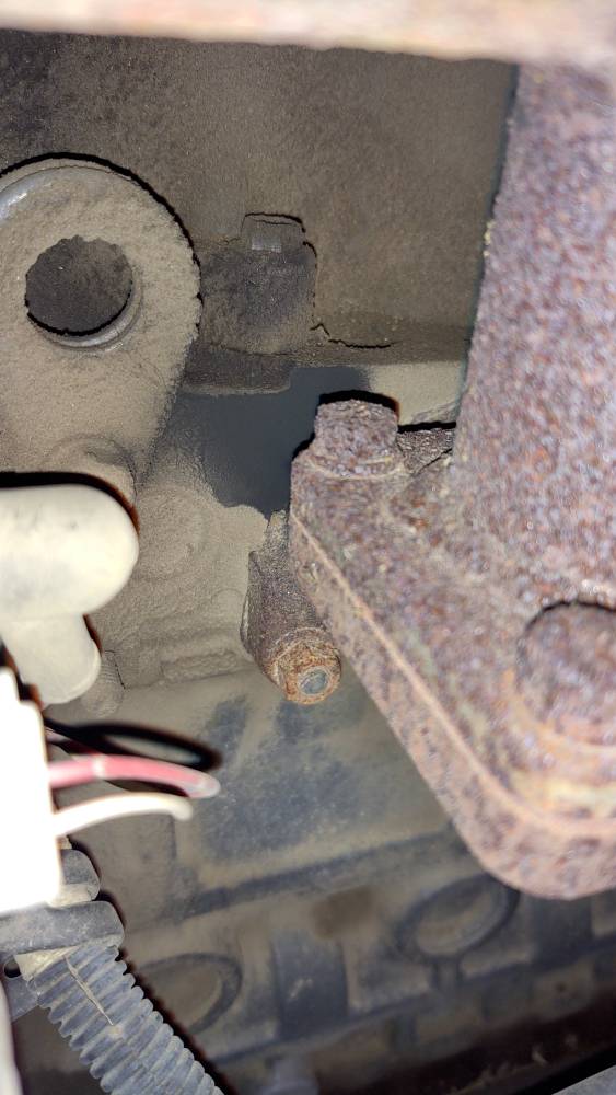

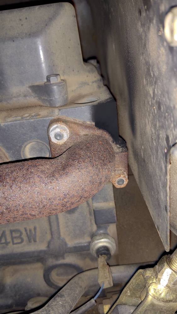

Ok, we're making progress, but the I don't think the news is good. I set all the valve clearances. I'll try to do a quick write-up. Leejohn, thanks for pointing out that the timing mark cover would be under the loader mount. Exactly right, and I'd a never seen it if you hadn't have mentioned it. At any rate, nothing was more than .003 out of spec, so nothing major. I set it all to .007-.008.
...and the knock is still there. :mad:
So I got to looking around some more...and listening. The more I listened the more it sounded like it was toward the front of the engine, and down low. Then I noticed that the crank pulley seems to be vibrating quite a bit. And I just replaced the front oil seal there. Adding 2+2 makes me wonder. Assuming there's a bearing at the front of the crank, if that went bad and caused a vibration, that could make the seal go bad. And a bad bearing would certainly make some noise I would think. Or worse, a bit of rod slap (especially if it was on cylinder #1) which made the bearing go bad.
Thoughts?
