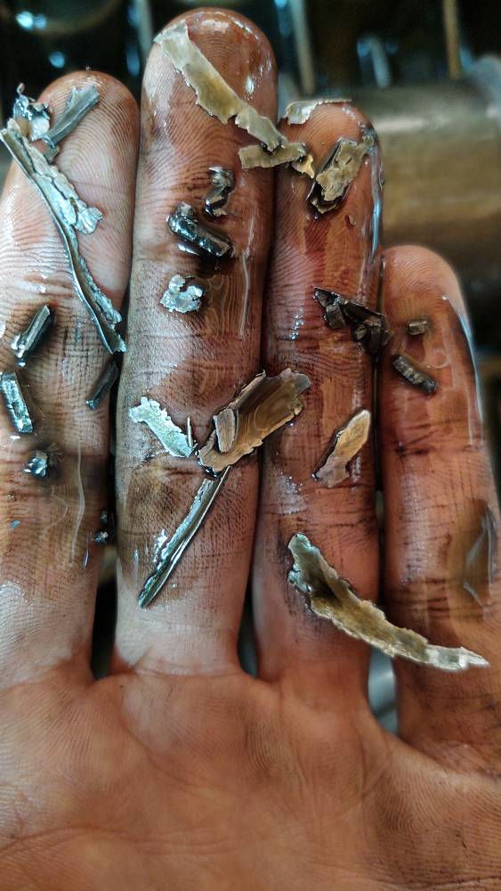

Ok, finally got some time to start on this project. I dropped the oil pan today and had a look up in it. Do you think I should be able to feel some play by hand on the offending part? I can't seem to get any movement other than side-to-side for each rod end.
There were several metal shards stuck in the pickup screen. And a lot more in the bottom of the pan. See picture. Seems that should give a clue?
Those of you with more experience in this, what do you think? Is there some way I should be able to identify the issue from the oil pan, or should I just bite the bullet and tear into the engine? IMG_20201021_162217653_HDR.jpeg
