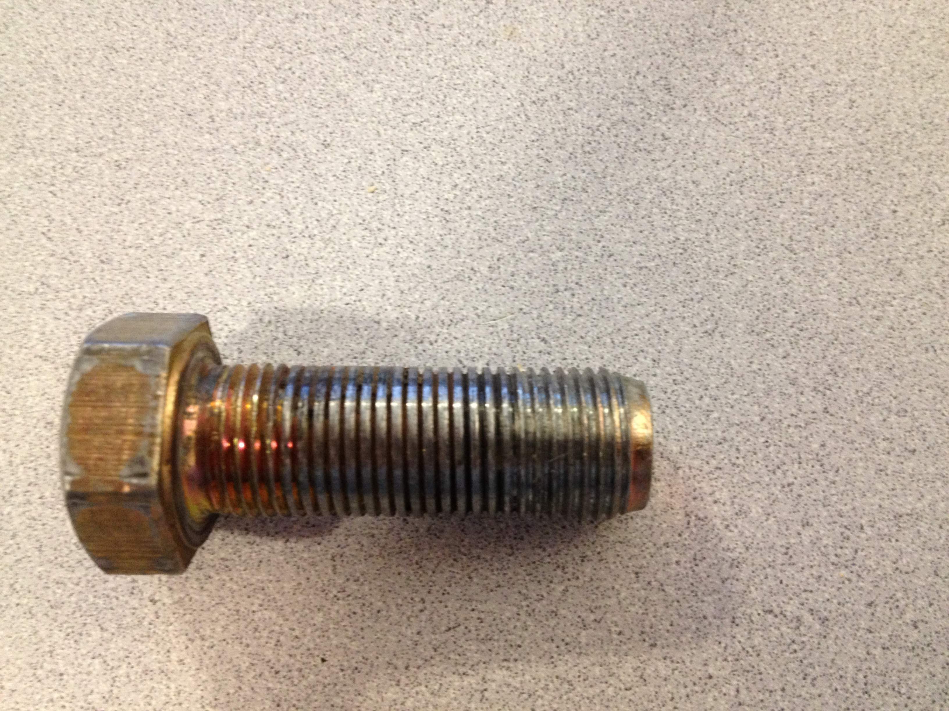

I tried uploading picture of the bolt that I took out - this one is not as bad as the others.
New looking bolt with lots of motion. We really need to identify the problem with your loader setup. If it was only that it was never tightened then putting back everything truly tight will cure it unless parts have been bent because of it. If its poor fitment or missing braces it could be an entirely different or only a compounding problem source. Poor fitment adds up to the same thing as not tightening. The interfaces must fit to each other neutrally so that they are clamped by all the bolt tension rather than squeezed toward each other for the 1st portion of tension. Your assembly may have been hanging on the bolts instead of being clamped by them. -- It looks new. Who did the assembly and how many hrs is on it? If a dealer, or Kubota, did that a few hrs ago you should be dealing with them.
Much better than I'd hoped.... Movement of the loader mount but not much damage from the engaged portion of the thread. And it looks like the bolt didn't even back out much - which is what I'd feared. This is very good so far. From the looks of that bolt you may have caught the problem in time and maybe no lasting damage. If the others don't look too much work just clean out the threads in the block (see previous message), install new bolts, torque well, and continue.

The damaged bolt pictured may not be representative of the more damaged bolts, BUT it does present the possibility that threads furthest into the holes may not have been in use with the current length of bolts used from the factory.
So, again I would want to know what is the maximum bolt length is that would fit the existing holes and see if that length bolt will screw into EACH hole until it has reached maximum or very close to max depth. I would do this without the loader bracket being in the way while 'testing' your easiest fix.
I would put aside all the theory about helicoils, machinists, etc., and focus on what exists to work with on the machine. Bottoming taps are a useful tool for this situation.
If using the existing holes with longer bolts of the same diameter, pitch, etc. becomes unrealistic, THEN I'd look at the myriad options presented in this thread.
I'd spray each hole with something like Brakleen and then dry with compressed air, inspect each hole and access the damage on an individual basis, then proceed, working my way up from easiest to most damaged to give you practice in technique. Clean the tap frequently and check progress. Oil the tap threads frequently too.
